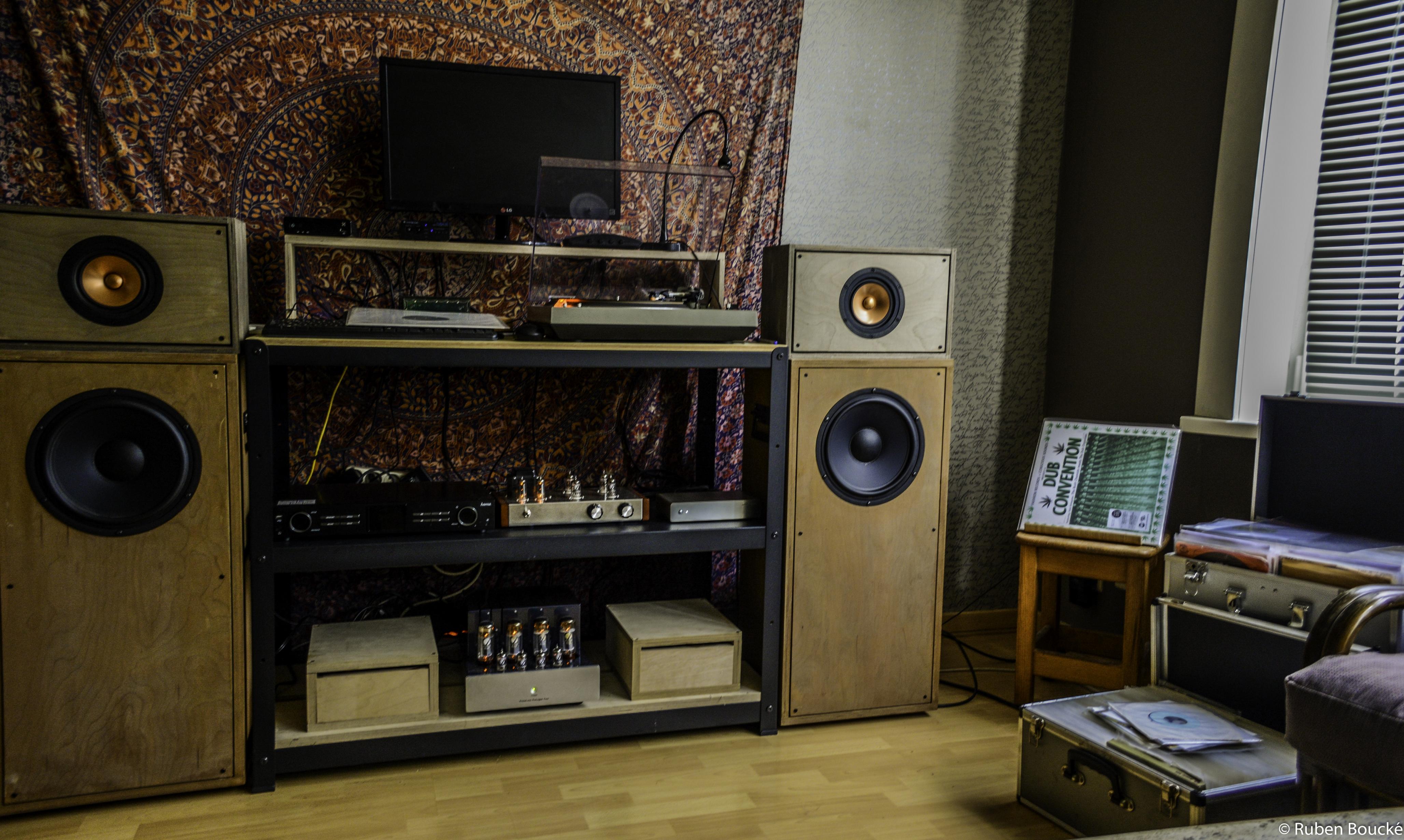

I, too like simple. I don't know the science of it all, but I know when I like how something sounds. For simple, another vote goes for MarkAudio drivers.
If you want something that's going to have the bass you mentioned, look into a WAW/FAST system:

I can also fall behid the suggestions of Mark Audio. I personally prefer the A10p to the A12p (goes lower, higher, and has greater ability to reproduce the small details, the metal cone driver has a more extended, top end, the paper cones have what i cal vintage top end. The extra efficiency of the Apaper cones may well be of benefir with the ACA (i have 3 of those, and used a 5w one with MA drivers about the same sensitivity as the A10.3.
The A10.3 is optimum in a 13 litre miniOnken (the alignment does tend towards smaller boxes) and the 2 paper cone drivers will fit the same size box (but with different tuning) but can also benefit from a larger box (17 litre) for more bass and more breathing room. The 13 litre Classic Golden Ratio miniOnken plans are here for an idea of size Frugal-phile | Box Library / Mark Audio (well within your criteria).
This is the 13 litre CGR with the old metal cone A12
The A12p thou doesn’t really seem to open up until in a bigger box — something like a Pensil, but like most of the bigger boxes is a floorstander and does not meet your aesthetic needs.
All will easily reach your woofer. A single woofer in the corner is likely not idea, but you have what you have.

In the family so to speak:
Open Source Monkey Box
Slightly bigger than your front panel requirements and separate crossover boxes—you can see my space savvy solution to that in the thread. Your room sounds shockingly similar to mine... I entered a negotiation about the WAF and suffice it to say that life is too interesting to be range bound by a few inches here and there when the true quest is getting the hairs on our arms to stand up with incredibly reproduced tunes. One could apply some rudimentary physical attributes that might required for that...IDK.
The OSMC offers max DIYness and learning... for a noob (like me), without taking on full speaker design (yet). No idea what your budget is...
