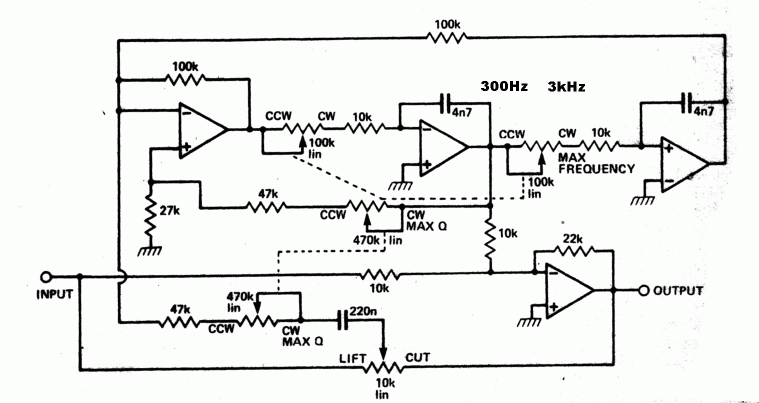

I'm a sound-engineer-in-training from sunny South Africa. Basically just registered because I gave up trying to find a simple schematic for a 1-band semi-parametric that I can build without going mental.

Like this ?
Looks nice and buildable 🙂 But I know next to nothing about the theory of circuits. Would I be able to connect that to a compressor circuit by just connecting the outputs to inputs? Also, what can this circuit actually do (in terms of frequency range, cut/boost amount, etc)?
