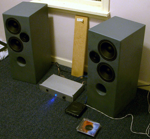

I'm a Mechanical Engineering student at the University of Washington. I love computers, audio, biking, and any number of other things. I've got plenty of experience in car audio, woodworking, and other forms of fabrication (such as composite materials and machining).
I just finished up my first pair of "Hi-Fi" speakers today. I built them based off of a design from Adire Audio. It's called "Bang!" as in bang for buck. I decided to test the waters with a cheap speaker (~$100) that promised good results. It uses two 6.5" woofers and a 1" dome tweeter per speaker. They're in a standard BR box (which I'm more than comfortable with from my subwoofer experience) tuned to 42Hz.
My amp is a snubberized LM3875 kit sourced from Brian. I built the case myself using 1/2" aluminum for the sides and .065" and .1" for the top and bottom. The piece of wood behind the speakers is going to be used on the sides of the amp, I just haven't had time to go use the woodshops planer and saws yet.
Right now the speakers and amp are getting some burn in time, but are sounding great so far.
Comments, questions, and yes, even constructive criticisms are welcome. (the paint job isn't perfect, but the speakers are bound to do some traveling, so I didn't waste too much time making them perfect).

The woofers used are MCM part number 55-1170. The tweeters are MCM part number 53-525, which are no longer showing up on MCM's site. The speakers sound rather good now. The treble is becoming smoother and less harsh after about 10 hours of break in (on both the amp and speakers).
