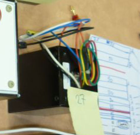

I was informed from a friend who joined ETF2009 that a Japanese OPT
was proceeded to the BEST 4 level. This OPT uses R-Core construction
(not C-Core).
I could not identify its entry number. I suppose it is #26 or #27. Does anyone know ?
(not C-Core).
Eventually, I have identified the entry number of the R-Coreded transformer
from the attached photo. It was #27 although the below Web page indicates
#28 as I suspect it is wrong.

Pierre-François Brand the owner of both N°27 and N°28 informed me that N°27 is a Spanish transfomer on EI core and N°28 a Softone RW-20
See: Softone RW-20 Single-Ended Audio Output Transformer
As I attached the photo in my previous post, the transformer with
#27 indicated by yellow paper is same as RW20 whose exterior
looking and the color coordination of the wires are seen in the Web which you quoted.
Please confirm it to Pierre-François Brand, again.
Hello,
After having done the necessary verification, Pierre-François Brand confirmed that the N°27 is the Softone RW20 transformer.
Pierre-François Brand says that N°28 and N°27 are inversed on the list of the shootoot as we can see on
http://www.triodefestival.net/uploads/ETF09/shootout.jpg
The Softone came in the 1/2 round and lost again N°5.

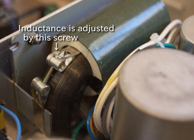

R-core is made by rolling a long uncut silicon steel strip.
I wonder how a gap is created in core (magnetic path) to make SE output transformer????????
I was informed from the president of Softone as follows:
For SE use OPT, R-Core is cut at the center (see attached photo).
The cutting sections are polished. Gap retaining film is inserted
between cut faces.
After the windings are assembled, inductance is adjusted by a screw
on the fastening metal belt (see attached photo).
For PP use OPT, no gap is applied on R-Core.
