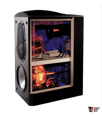

Ok but when the frame is so stiff that panels cannot move It is the case of magico
This is after all the rationale behind cabinet bracing Another great and more human case here
The internal bracing prevents the front baffle to move
In the case of Magico the side panels could be thin sheets of plywood kept in place just with some magnets Removable Ok with some rubber to seal the panels to the cabinet
I am sure they will work perfectly
I think that a good approach is to start design the internal frame and then move to the external panels Like B&W did with the Matrix series
