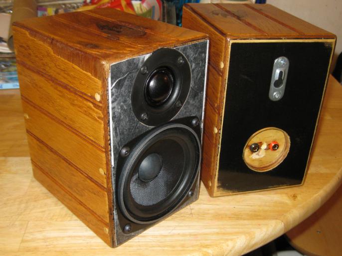

I'd go with the napoleons, that tang band woofer is pretty good, the tweeter aint bad especially crossed high and DDF knows what he's doing. I'm gonna try a pair myself. Willy's hifi still has some tweeters available.
If 10" x 8" x 5" is acceptable, The Lance from Woden Designs using fostex ff85wk is great for near field, up to about 3 ft. I've just tried both (uFonken and The Lance) and the later goes lower.
