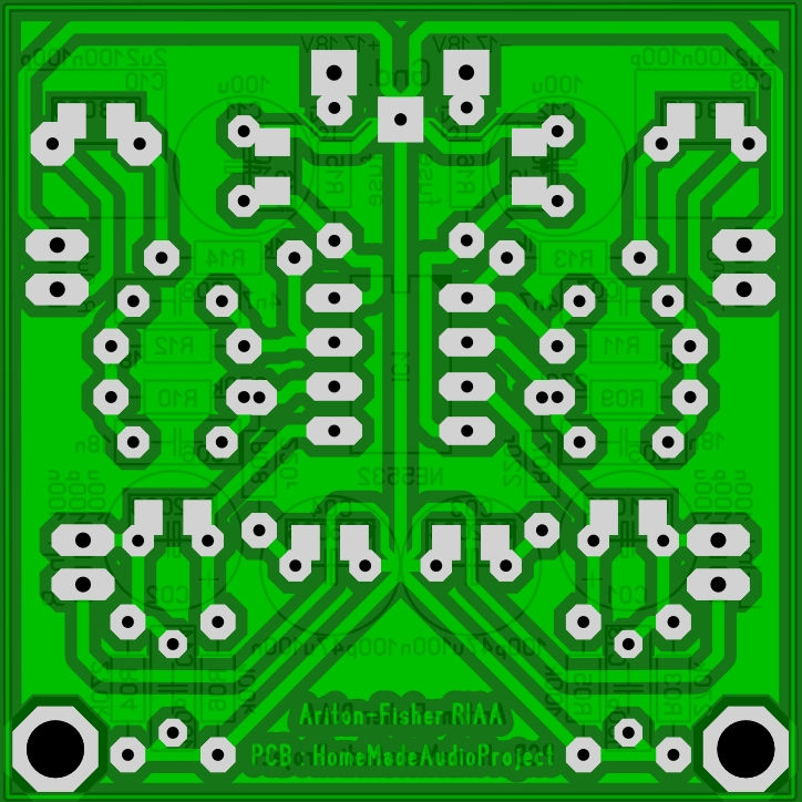

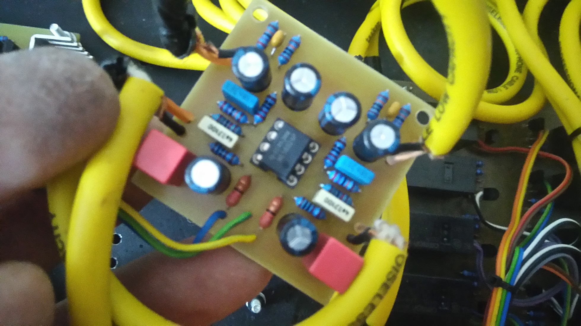

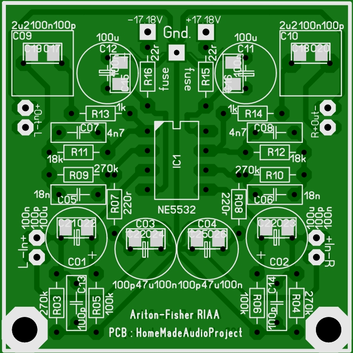

simple,great sounding RIAA preamp. just made it... tone controles both in a middle. nothing needed to add or reduce,just to be built as it is assigned at files,and no regrates. after a few,my newest favorite!
if any interested,contact me by personal message and i will send pdf and LAY6 files.

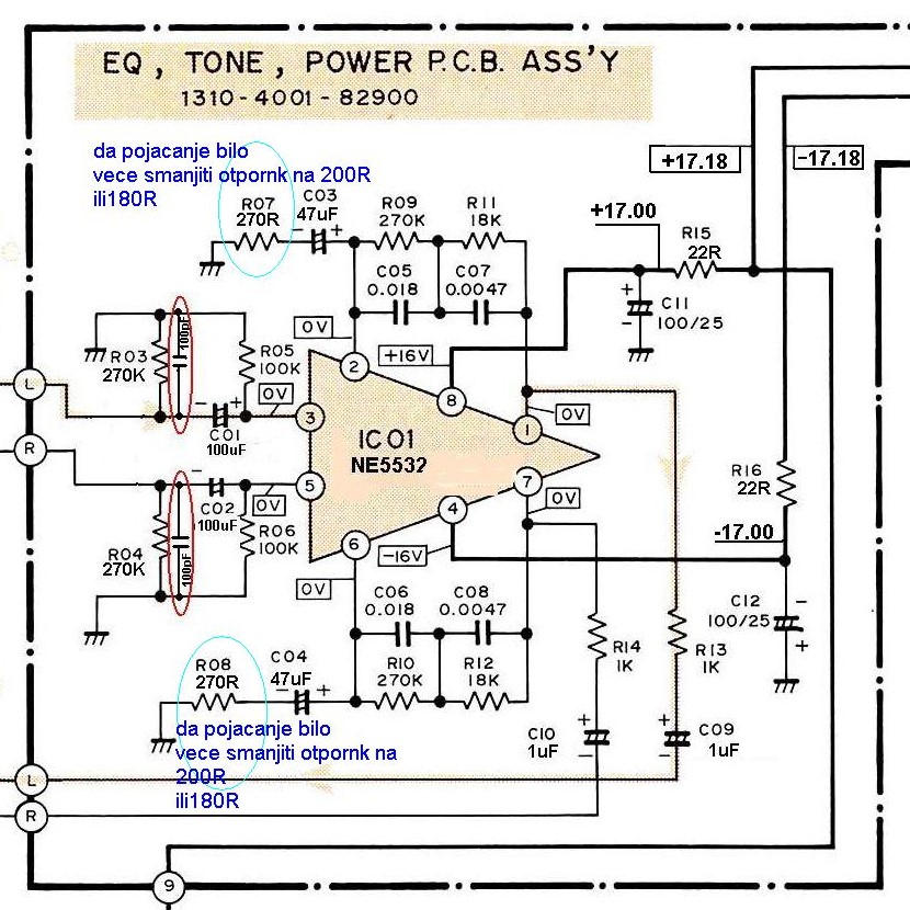

If anything calls attention in this boringly average circuit, it is the frivolous input impedance of 72k. So, yes, it has to sound different.
