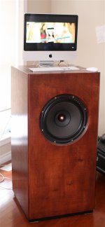

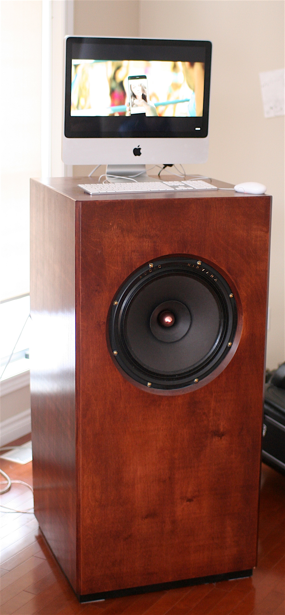

Hey Charles, that's a great listening set-up you have there.
I would like to hear that driver in my listening set up, a single mono speaker, but it's a lot of $ just to find out. I'd like to know what it would offer that would be different from my AN Ferrite 15" which already sounds excellent. I don't doubt that it would be different, and many who have heard neither would expect it to sound a lot better, but in just what way I am curious.

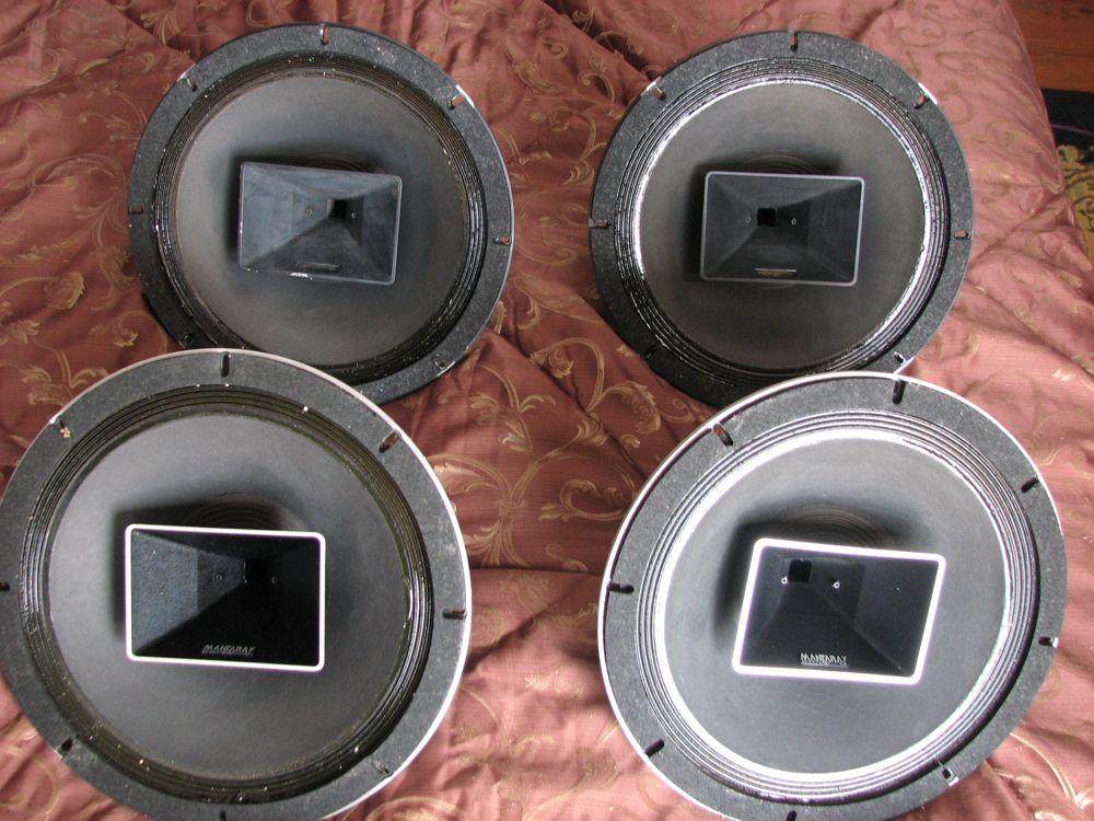

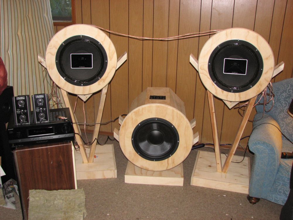

I sourced some NOS PAS drivers years ago (3 new sets) and they are outstanding for the low cost. I put them in these Altec 620 style bottom ported cabinets, with 3" front baffles, out of Baltic birch/Rosewood veneer, with Rick Craig crossovers (Selah Audio) and they were amazing. I had $100.00 in the drivers.

Are these the Pas CXL1580C by any chance?I sourced some NOS PAS drivers years ago (3 new sets) and they are outstanding for the low cost. I put them in these Altec 620 style bottom ported cabinets, with 3" front baffles, out of Baltic birch/Rosewood veneer, with Rick Craig crossovers (Selah Audio) and they were amazing. I had $100.00 in the drivers.
I'm looking into acquiring them at USD 250 a piece (from USA). Could you share your insights on these? E.g. how do they compare to the Altec or GPA coaxes? What CD did you combine them with?
