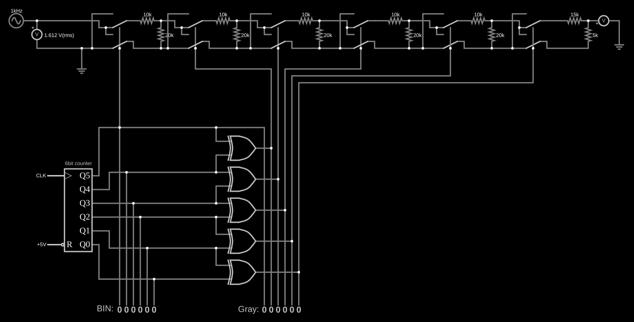

I simulated a 6stage Gray attenuator and took measurements to calculate input-Z and output-Z. Result: input-Z stays constant at 20k, output varies somewhere between 8k5 and 15k3, only the two softest and loudest steps drop to a minimum near 4k2, see attached table.
So it seems Zout=Zin*[1/5...3/4] for 6 stages of attenuation.

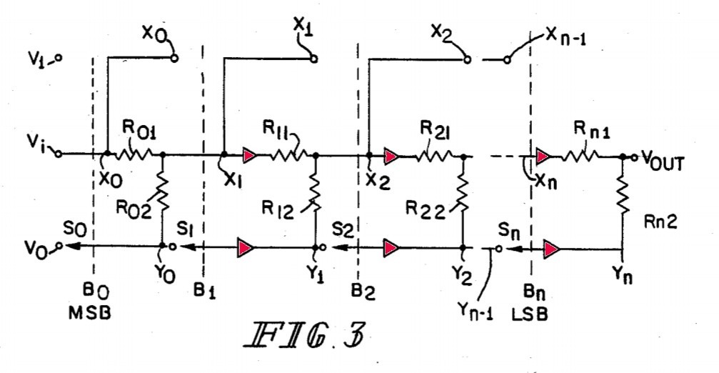

The downside of the Gray code attenuator is that the signal goes through double the number of switching contacts compared to a traditional relay attenuator. Therefor the patent shows another schematic (see attachment): the signal goes through the "normal" number of switches, but the downside is that it needs buffers between the stages. So a 6stage attenuator would consist of 6 relays plus 10 buffers.
To roundup: it seems the Gray code attenuator will sound better during switching because only one relay is switched per step (i.e. less clicks/pops in the signal especially at the 50% transition where in the traditional attenuator the MSB switches). But once the desired volume is reached the traditional attenuator will sound better. Unless you use perfectly transparent buffers of course, or switches without any loss...

It must be examined whether the Gray code is of any use in practice. You don't turn a volume knob by one step, but by 10 or 20 steps, if I have a 127-step range. And in these cases you have to switch all the relays again. The Gray code can only show its advantage in 1-step processes.
For example:
000000<-from here e.g.
000001
000011
000010
000110
000111<-to here
000101
000100
001100

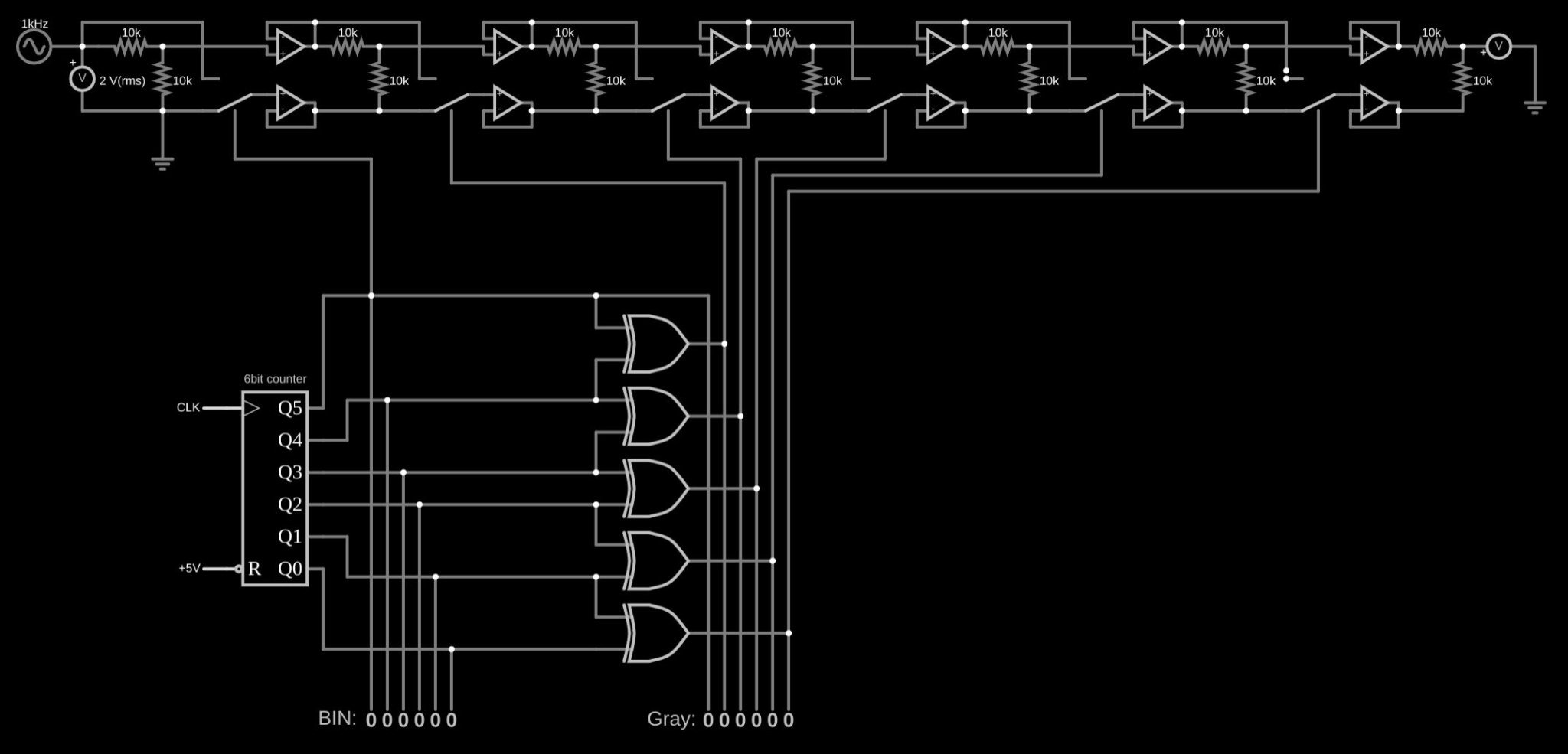

Here is the simulation of the buffered Gray attenuator following the schematic from #9. I again simulated to replace a 20k pot using 6 stages. All resistors are 10k. As a result I got a constant input-Z of 20K and a constant output-Z of 5K.
So it has Zout=Zin/4
Not bad - but so many buffers! Any ideas??
(Attached the simulation layouts)
