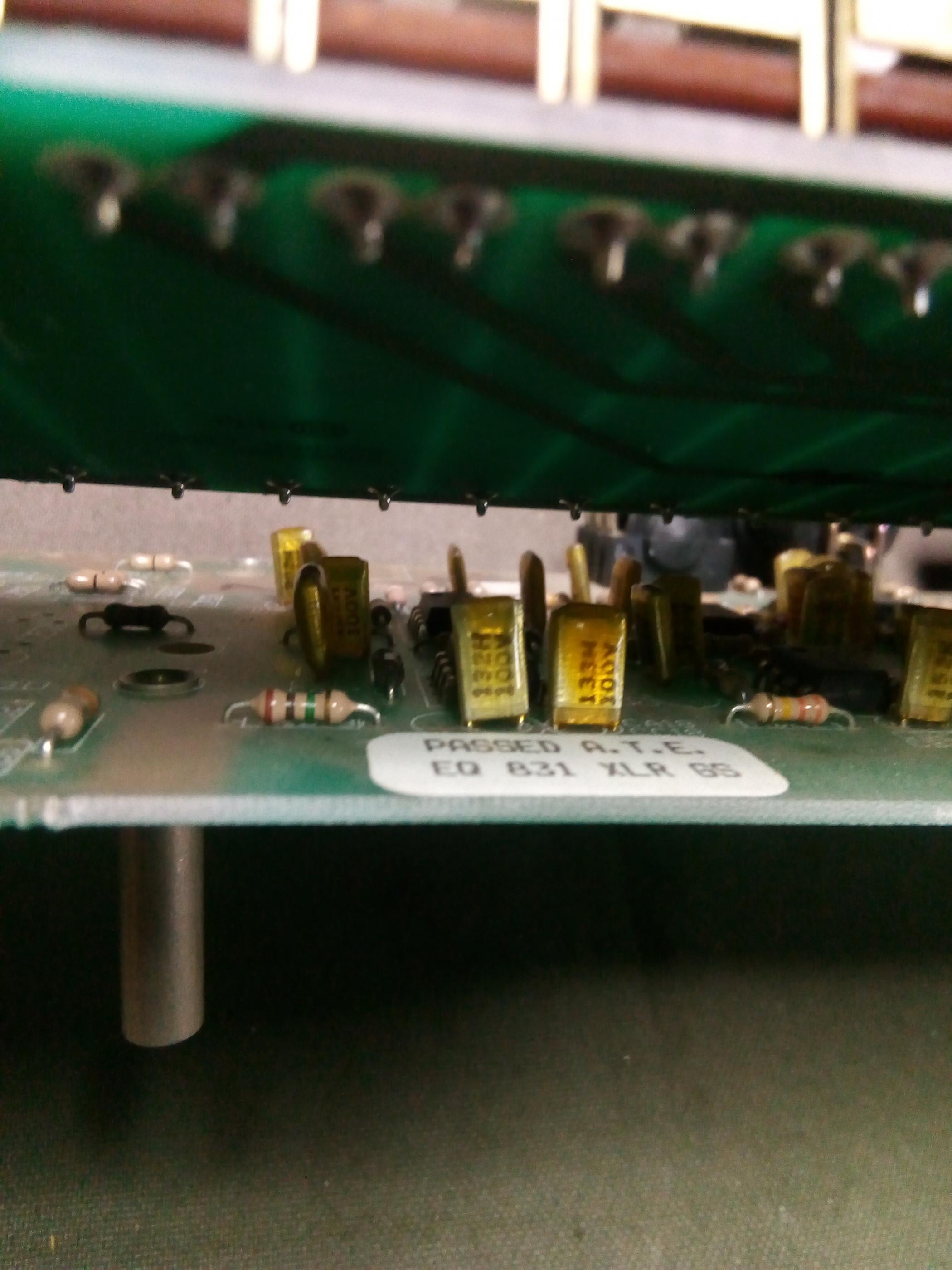

I checked the EQ again today and noticed that the 1.25k frequency in particular is the one that induces the noise. There is something that looks like a polyester cap but say "133H / 100V" on one side (no idea what this marking means) , followed by a 1K ohm resistor and one side of an 4558 op-amp. I'm not such a good electrician as to figuring it out right away. Could you give me a hint, maybe?

I'm not exactly an expert on EQs but would check for dry joints on Rs and Cs involved in this range, and check whether the resistor hasn't gone high or maybe even a cap gone open (as rare as it is).
133H is 13 nF, 3% tolerance. (133 = 13*10³ pF, H = 3%) 100V is the voltage rating.

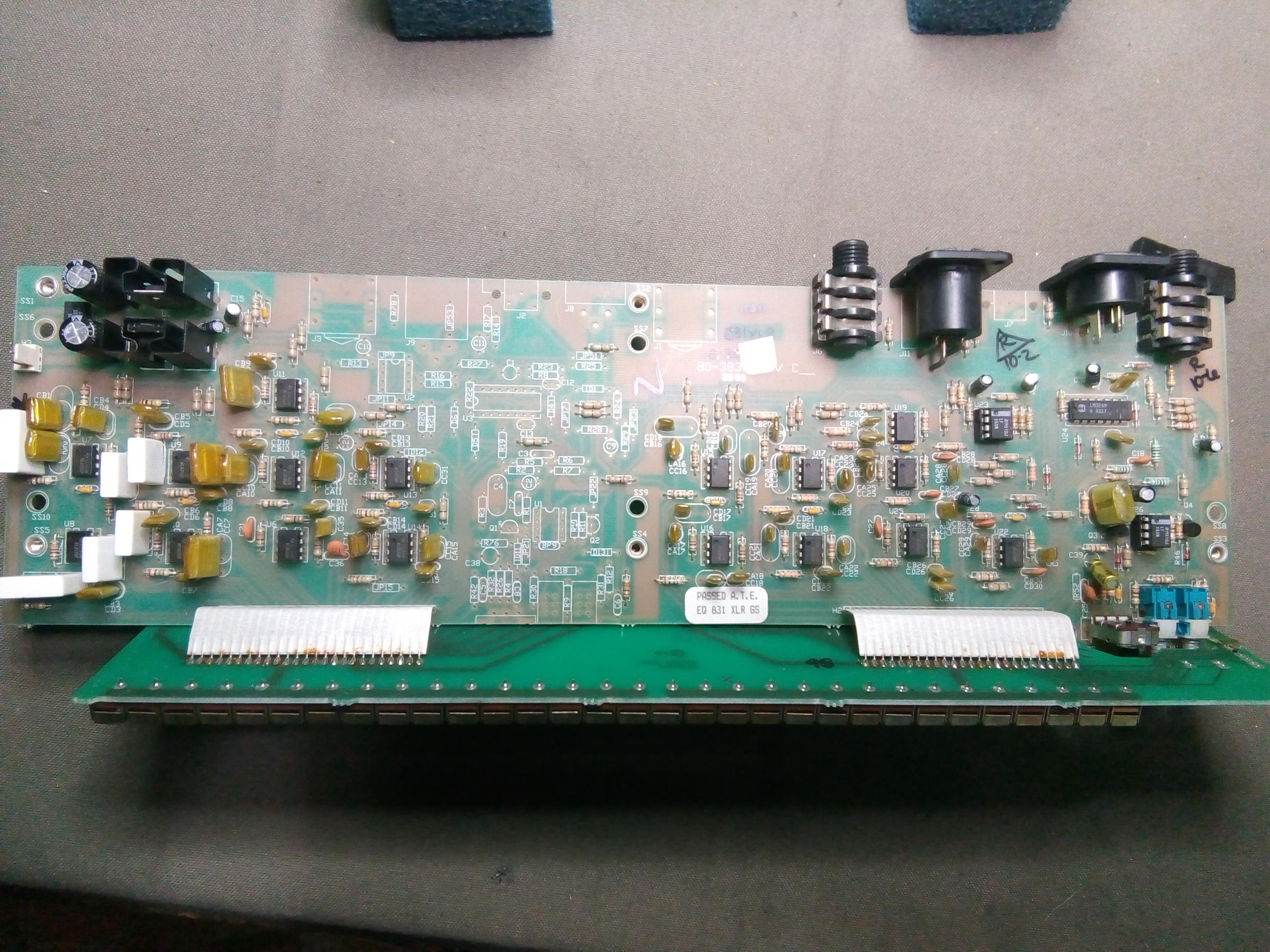

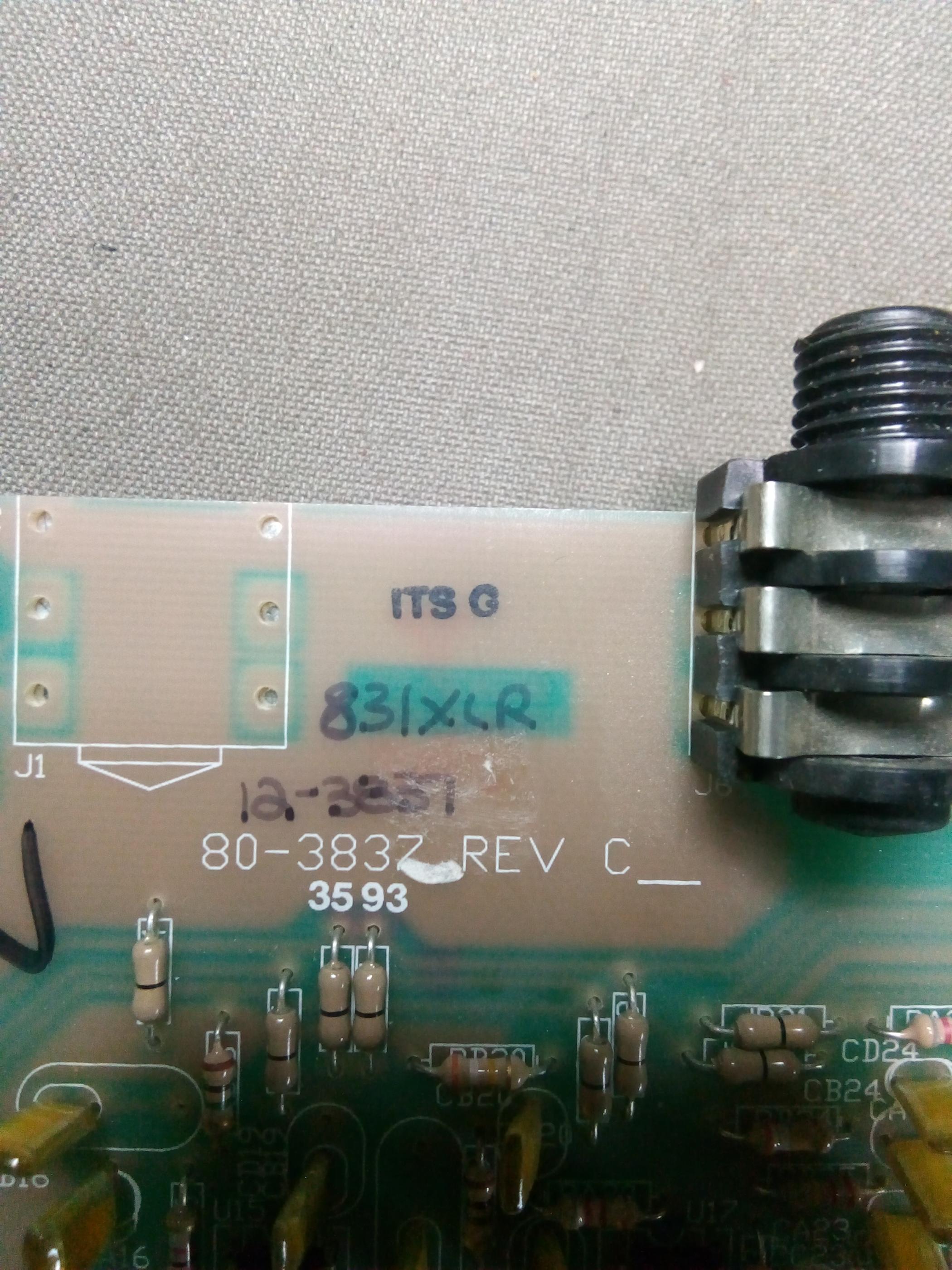

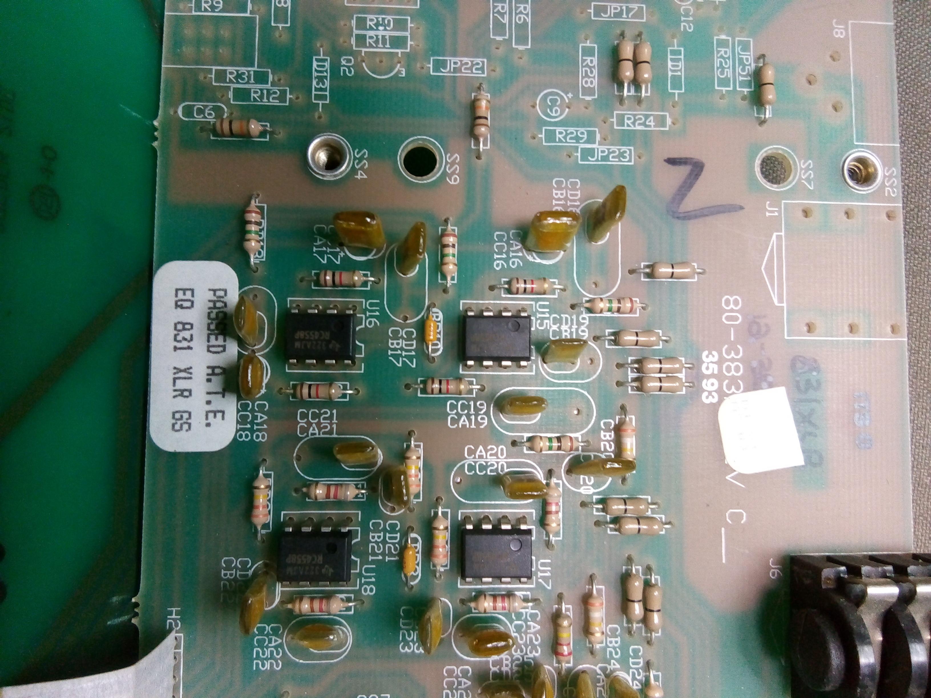

Ich kann dir ein paar Fotos vom Innenleben des Equalizers senden.

That's a whole bunch of opamps. 17 duals for 31 channels, wonder what the "overhang" is doing.
Hmm, flex cable... another possibility for bad solder joints.
4558's are almost music quality op amps. Maybe good enough for a punk garage band.
