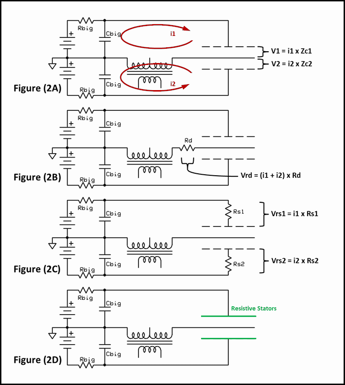

The “inverted” ESL configuration is shown in Figure (2A). Equal and opposite charge potentials are placed on the stators by charging the two stator-to-diaphragm capacitances. Note the two large capacitors “Cbig” in the circuit. These are required to complete the low impedance AC circuit so that audio currents i1 and i2 can flow thru their respective stator-to-diaphragm capacitance and change the voltage potential between diaphragm and stators at audio rates. Without them you would have the proverbial case of one hand clapping. See Calvin’s post from some years ago:
http://www.diyaudio.com/forums/planars-exotics/164745-inverted-esl-2.html#post2147612
Note that these large capacitors not only form a low impedance path for the audio signal from the transformer, they are also charged up to the same potential as the HV bias supplies. Since they will need to have capacitance > 10x the ESL panel capacitance to minimize loss of audio signal they act like a low impedance source of bias voltage as well. So, if you choose to use the inverted configuration, you are stuck with the constant voltage mode of operation. As Calvin mentioned in the last post, this results in two current loops driving the two separate stator-to-diaphragm capacitive impedances Zc1 & Zc2.
By now, it should be clear that placing resistance anywhere in these current loops(Figures (2B/C/D)) will cause a roll off in the HF response and if resistances are made very high, will reduce sensitivity. The arrangement shown in (2B) was used by Final to low-pass the response of their bass and midrange panels.
The main advantage of the inverted configuration is that the step-up transformer needs only half the step-up ratio to produce the same output as that from the standard configuration. For the same operating bandwidth, this tends to make the transformer cheaper and easier to design. But this comes at the cost of the inability to operate in the low distortion constant charge mode.

how about dual diaphragm, center high R charged stator? - more closely inverting the normal topology
A double diaphragm/triple stator arrangement is electrically nothing more than two standard ESLs operating in parallel. As such you will still need to have relatively low circuit impedances for driving the two capacitances (center stator-to-front stator) and (center stator-to-rear stator) at audio frequencies.

but that's not what I propose - drive the 2 low resistance membranes with the audio diff V creating the audio varying E field between them
the single central stator is biased and has high R to give the stationary charges that the E field reacts against
Aaah...I follow now.
Calvin already covered this configuration, and yes it will operate in constant charge mode.
"...You may interchange between two-fixed-outer-one-flexible-middle electrodes and two-flexible outer-one-fixed-middle electrode as they behave electrically the same. The difference is only mechanical..."
The earliest mention I have seen of this configuration was in a 1956 WW article by Leak(attached).
Many years ago I experimented with this configuration for its immunity to dust and contaminates in the airgap.
There were a few drawbacks though, that caused me not to pursue it further.
1) In the zero signal state, the diaphragms do not have equal forces pulling on them from both sides as in the standard stator-diaphragm-stator arrangement. So I could only use about half the HV bias level before the diaphragms collapsed to the central stator. This dropped sensitivity by 6dB or more.
2) The top octave response suffered because of the phase difference between the two spaced diapahrams.
3) It was difficult to construct reliably as the central stator needed to be stiff, flat, and thin with no ability to add external bracing as is common with the standard configuration.
