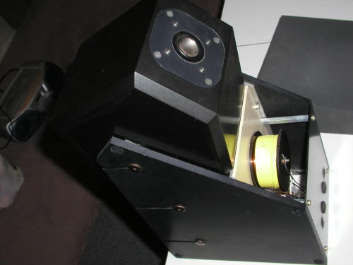

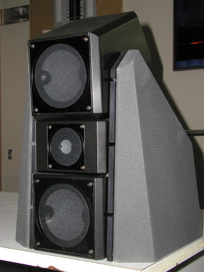

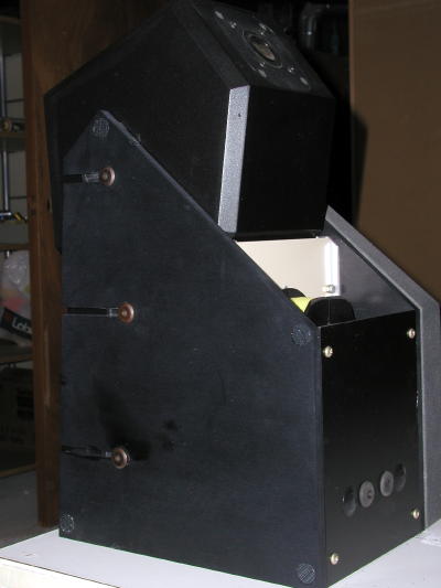

I've seen recently some other designs on a net. My version used Accuton ceramic mids and tweeter and Focal in the back. It also shares the most important aspect of the original design in that each driver can be phase adjusted by moving it back and forward. The enclosures are made from MDF and since Accuton drivers are sealed the cavity is filled with sand for damping. The finish is done with many coats of auto metallic paint. The bases which support the drivers boxes are made of 1/2" anodized aluminum. Sides made of wood and covered by grill cloth.

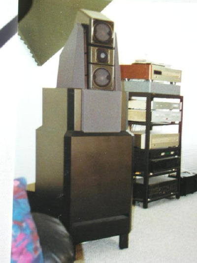

I found an older picture how the rest used to look. While not exactly reminder of an original it was quite satisfying. I modified my original subwoofer with two 12" Vietas in push-pull config by adding mid-bass inclosure on top (matrix cabinet with 8" Cabasse woofer).
