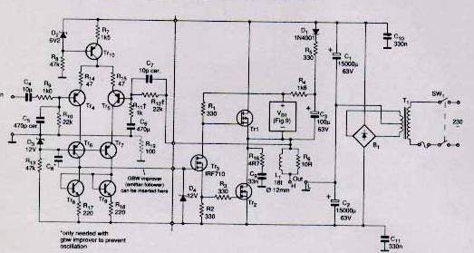

I've got a question. Why is in GM's type or JLH type output stage or non compliment type (like I attached here), they never use RE as emitor degeneration? Is RE forbidden in this type of output stage?
How if we wanted to parrarel the output stages, wouldn't RE is a must?

if you want to add emitter resistors to balance the current in parallel output devices I don't see any difficulty - you would only be doing at the packaged transistor level what is implemented internally in many power transistor constructions
the real issue is whether you really want more power in a Class A amp; to accommodate impedance dips you might want 2x the nominal current bias giving 100 W continuous dissipation for 25 W rated output - 1 KW for 250W rms? - here it could be a "winter amp" - maybe you could run a Laundromat on the waste heat if you go 5.1 (looks like that should be a night-time amp with Bandung’s climate, maybe you could drive an absorption cooler during the day?)

The thinking is simple. It's not about more power, but about safety. I got worries with hot transistors. They can act weirdly. 50W dissipation will be safer to be handled by 2 or 3 pair than 1 pair, right?
If you see the non-compliment article, the biasing method is quite different than GM's. GM is using bootstrap to upper rail, and non-compliment using fixed voltage referenced to output node.
Is these 2 resulting the same thing?

You have attached the 'non-complementary' circuit due to Bengt Ollson, I think circa 1994, though there seems to be a drawing error for the pcb/heatsink split. It was class-AB.
Bengt went on to manufacture 250W.rms 8 ohms amplifiers using single push-pull pairs of output Mosfets with no emitter resistors. His solution regarding temperature compensation was in the little bootstrapped sub-circuit shown boxed beside TR1.
Two reasons for me to not like this circuit at the time were that it effectively had Miller compensation at the splitter driver, also it used a series output choke.
Bengt actually removed the choke in his next version, but increased Miller C with an additional component such that the phenomenal open loop gain started rolling off around 100Hz. Again I could not like that.
Bipolars need current bias; through base wrt emitter - in a JLH via the collector resistors and bootstrapped to the upper emitter.
Mosfets need voltage bias; to gate wrt source - Bengt also uses Vcc current flow, but voltage regulates and similarly bootstraps it to upper source.
Both lower output halves are already driven wrt to their emitter/source terminations, and the interposing of an emitter/source resistor here also increases the imbalance of the splitter drive wrt input stage output, though there is less effect upon a differential/mirror stage output.
________________________________________________________________
With correctly biased single output devices, emitter/source resistors actually degrade output stage performance, though they are essential for the correct hot running of parallel output devices.
Low value resistors do not degrade parallel performance however, due to the combined device decrease in effective emitter/source resistance.
_________________________________________________________________
JCX is of course correct relating to heat versus class-A power output, but modern devices are rugged, and your concerns can even more allayed by implementing a low drive resistance capable of quickly removing base/grid stored charges.
