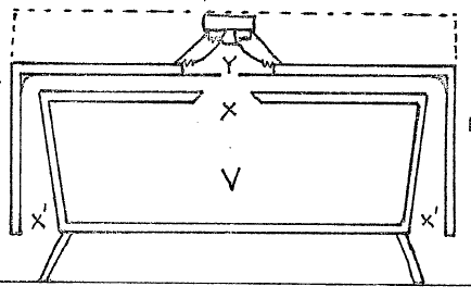

Hi all you bass (infra) fanatics.
I have finished typing out all the plans...under huge pressure from you bunch!!
Anyway, Ill post the plans, all typed out by me ;o) as well as all the diagrams, as well as my personal experiences and tips i can help you with that i had to figure out on my own, as well as include all the tips i wrote in here. I see so many people have downloaded the plans up to where i typed, so ill rather fishish it and post it in a day or two once and for all, then I just hope you all build and tell me your results and hints you come up with.
Ill post on the 16 June latest. Its a public holiday here in South Africa, so ill complete it then. (Yes its winter here, and we sitting in 3 degrees centigrade morning temperatures. We not used that cold here.
NOTE : Also as paradise-ice explains, infra bass can be dangerous to health and property. In fact listening to the same low bass piece for two hours for testing and positioning of my new box, i ended up with neck-ache, dizziness, nausia, and had to have a break for 3 days before i could listen again....all that on a tiny system....be careful!

Answers to some Q's
Some questions
Q. why is it so room fussy tho? is it simply because of having to presurise the space enough to produce these frequencies?
A: You will see in the plans why you need a SUITABLE listening environment. He explains, but not explicitly says that the box raises and lowers the overall pressure of the listening environment. It stands to reason then that if you leave the door open, how do you pressurise the room. If you have a hole in your car tyre, how will you pump the wheel up to its correct pressure?
Q:why do you say that if you turn it up the worse it sounds?
A: Good question. Remember i was on a tight students budget. I only had an 80W rms 10" speaker, and a 30Watt rms NAD amp.
Of course if you turn it up too much, massive distortion is going to take place. I dont have a huge amp, and powerful speaker to test it to the limit. Besides i didnt want to kill thy neihbour. I would love someone to try this box with the more powerful equipment. Remember the distortion is also less the softer you play the speaker (within reason) and i found that the less the cone moved, the deeper, and purer the sound was. I dont believe my amp could drive it.
Q: any ideas on how to work out the required chamber volume and port sizes for any given driver?
A: Dont worry about that. The plans ill post on 16th june include 3 designs. All dimensions included to build a 10", 12", and 15" design. My 10" blew me away. 15" i think would stop your heart.
When youve heard bass down to about 10Hz or so...its indescribable, and youll understand what i mean then.

Whilst the principle might be capable of producing very low
frequency bass I'd suggest the caveat is that this is not
accurate low frequency bass, transient response is poor.
I think this can be observed by simple inspection, just consider
trying to use the principle for say bass in the 30Hz to 50Hz region.
I remember the whole debate about the principle well, and I
was basically in the sensible camp, saying that considering
the principles of vinyl reproduction the idea is at best a novelty,
getting down to 20Hz with good quality is far more important.
GH's suggested mods for tonearms were / are a non-starter.
With digital its very different if your subsonically inclined, though
I can't imagine a highish Q boom box sounding that pleasant.

not entirely convinced it does what it says on the tin
i'd welcome your thoughts on this but first off thanks for the plans Ryan, i've put them on some space if anyone wants them, save hassling you too much eh? - Holliman.zip
right i've done a rough number crunch and i stress this was just a rough one i didn't have the time last night to draw it into a cad program and get the exact measurements
not having the specs available for the specially designed drivers originally used and without mailing wilmslow audio and having to wait for a response i've used 3 different drivers as a comparison (all eminence it was easier) and put it into AkaBak (the only thing capable of simulating this)
anyways i'm not entirely convinced for starters the efficiency wasn't as high as i was expecting and the smoothest line gave a 12dB roll off from 50Hz which could easily be obtained with a sealed box
however the biggest shock and this might explain the poor sound at high volumes was that at 1W the cone excursion was already well over 3mm
now it's quite possible i've made a mistake somewhere but i don't think so having rechecked it this morning
obviously better drivers maybe out there with tweaks to suit but see for yourselves - Holliman Response

i think it's possible the theory is sound however the application of it is flawed because of driver limitations namely the excursion and rather than using a low excursion driver a high one might be best ie the lab12 might be a good one
i didn't model it cos it would've meant redoing the whole thing
i might do so later as i'm going to have a play around with the whole design anyways and i'll let you know my results

I haven't had the time to look into this thoroughly yet but it may be that the Helmholtz resonator theory is close to the mark.
If so, I would guess that unless the box size is large, the Q of the resonator will be high, giving a very steep curve and a precise frequency that is 'amplified'. Either side of this frequency the response won't be so good.
Can anyone go further on the theoretical side of the design?
