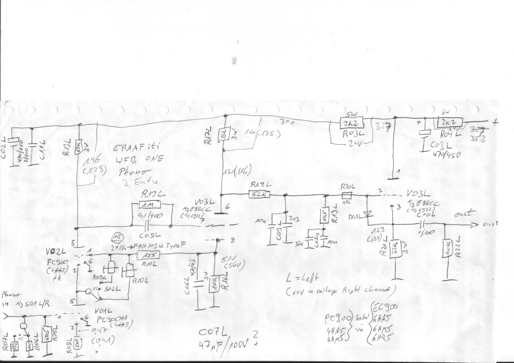

Hallo folks,
This thread is (for me) interesting since I like schematics for MC/MD preamps using vacuum tubes. Thus, I have perfomed some PSPICE simulations using the handdrawn schematic of "tiefbassuebertragung.de" and also his (later) PDF version of the schematic. There are several differences between the first and the later version. I think the later version is rather OK, but R19L is listed as 1k5 in the handdrawn version and as 15k in the PDF. My simulations indicate that both of these values are wrong, as they result in RIAA errors. According to the simulator (Simetrix), the correct value of R19L is 7k5. Do the design gurus have any comments?
Counting on thumbs:
R18L plus the impedance of the plate node driving it is around 70K. R19L should be about 1/10th of this for proper 1KHz response. Certainly not 1.5K, and probably not 15K. If you have an accurate sim, and it says 7.5K, then I accept that.
Much depends on the rp of that tube at that particular operating point.

I am still looking for the genuine schematics, both of WFB ONE and WFB TWO from Gruppo Ricerche Audio Alta Fedeltà.Who can post the schematic of this GRAAFiti preamp?
GRAAFiti WFB ONE Preamplificatore Valvolare
Who can upload this ?
