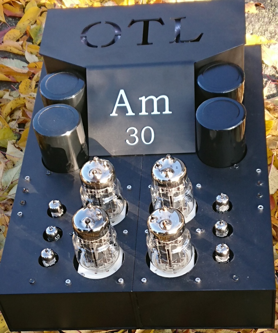

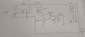

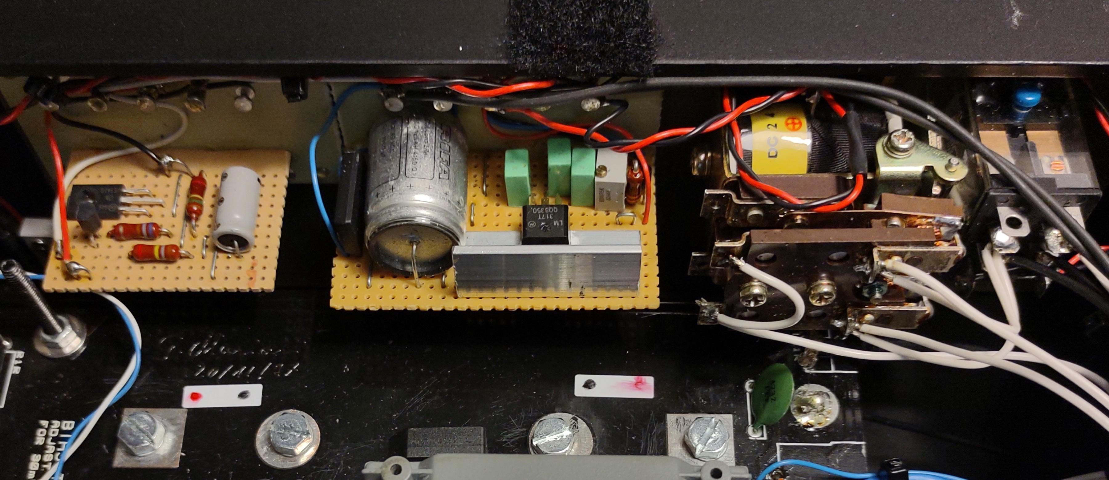

Am30
Based on the GM20 design.

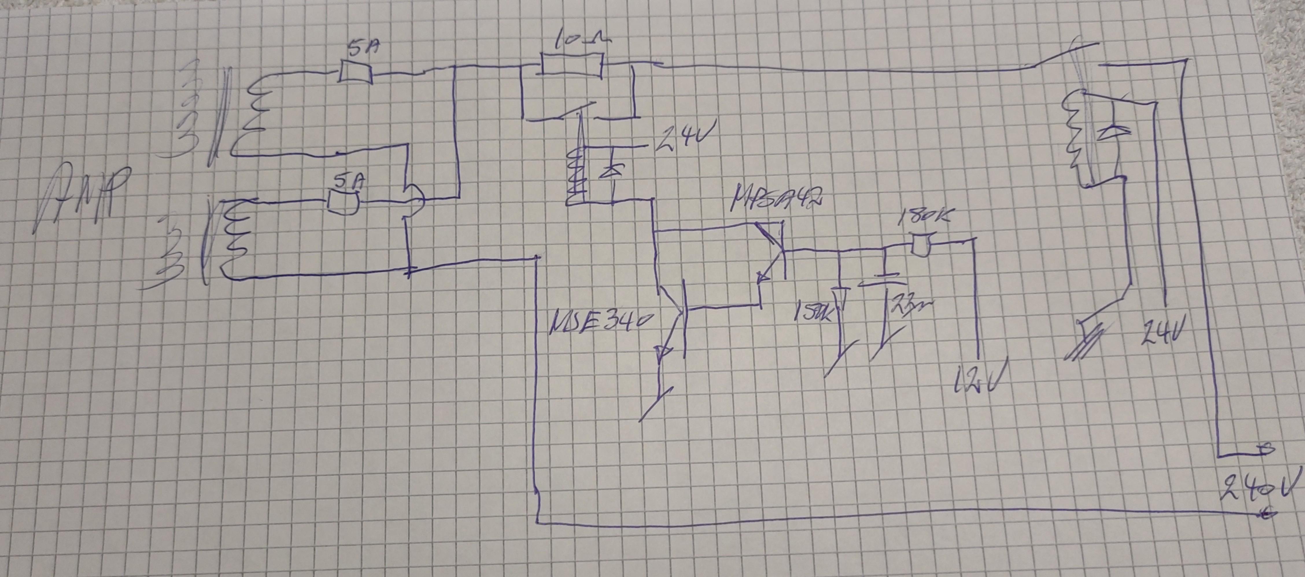

An elapsed time counter was mounted.
No guesswork any more.

Bias
I adjust bias for 240mA. It's stable and with the cooling it's not running hot. Tube life is acceptable. I haven't replaced any so far, but less than 1000 hrs.
As mentioned, the first I built as "hard wired" and with counter, the tubes were replaced after 3000 hrs. No failures.

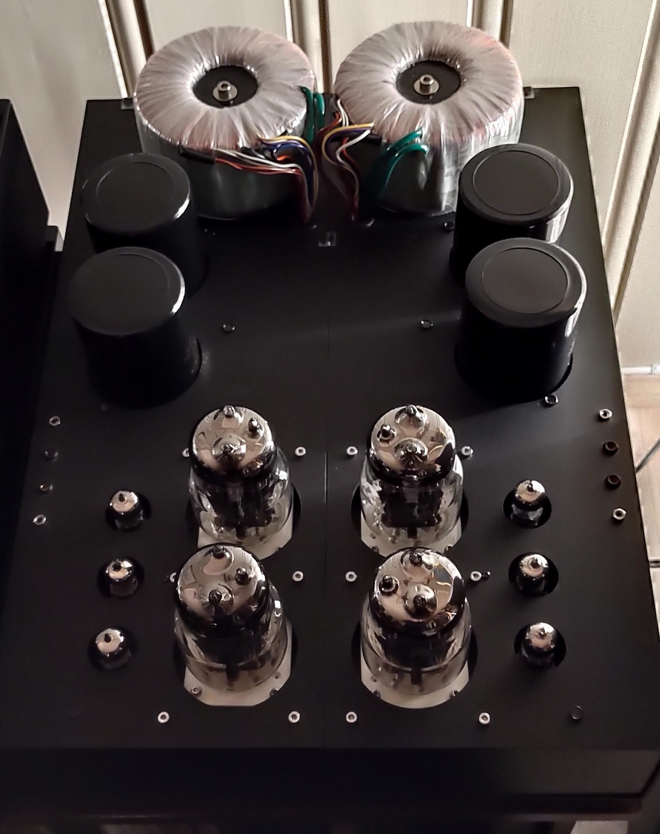

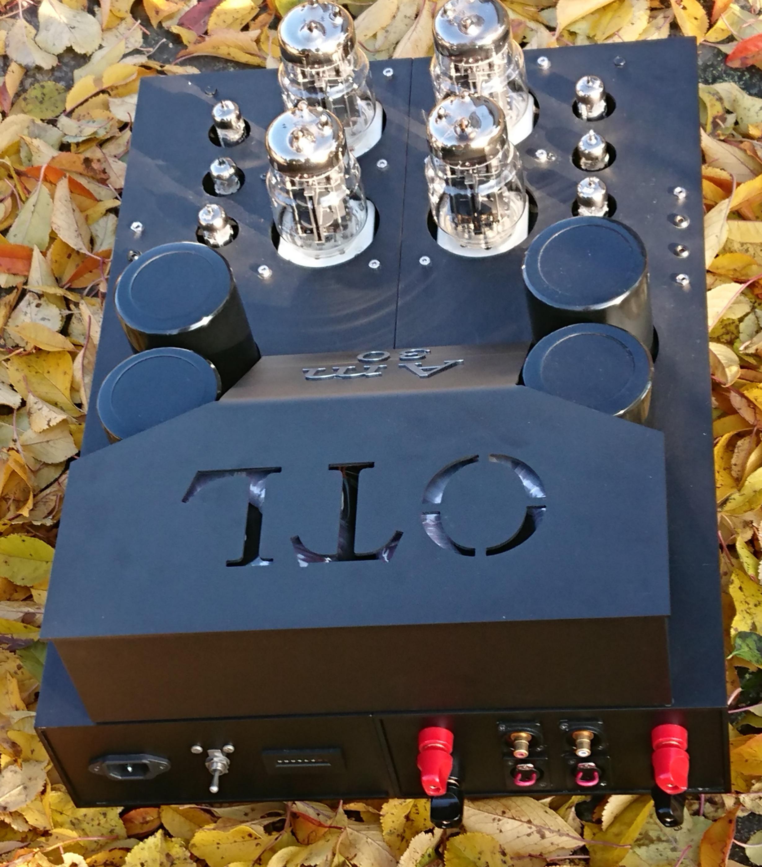

Excellent work.I made my own GM20.
It's better, more power and stable without running warm.
Hence the name Am30.
Made by Audiomix (Am) and more than 30 Watts output.

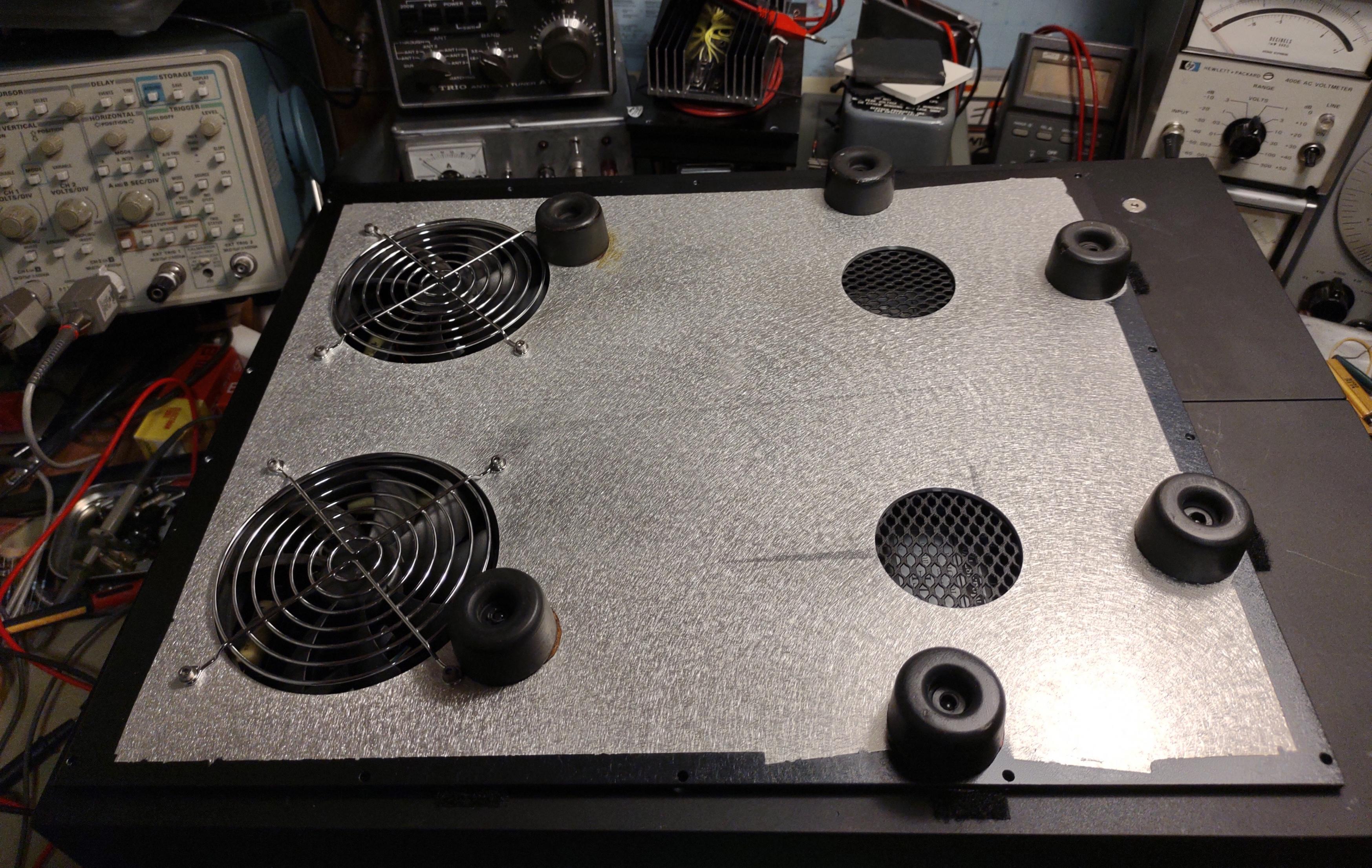

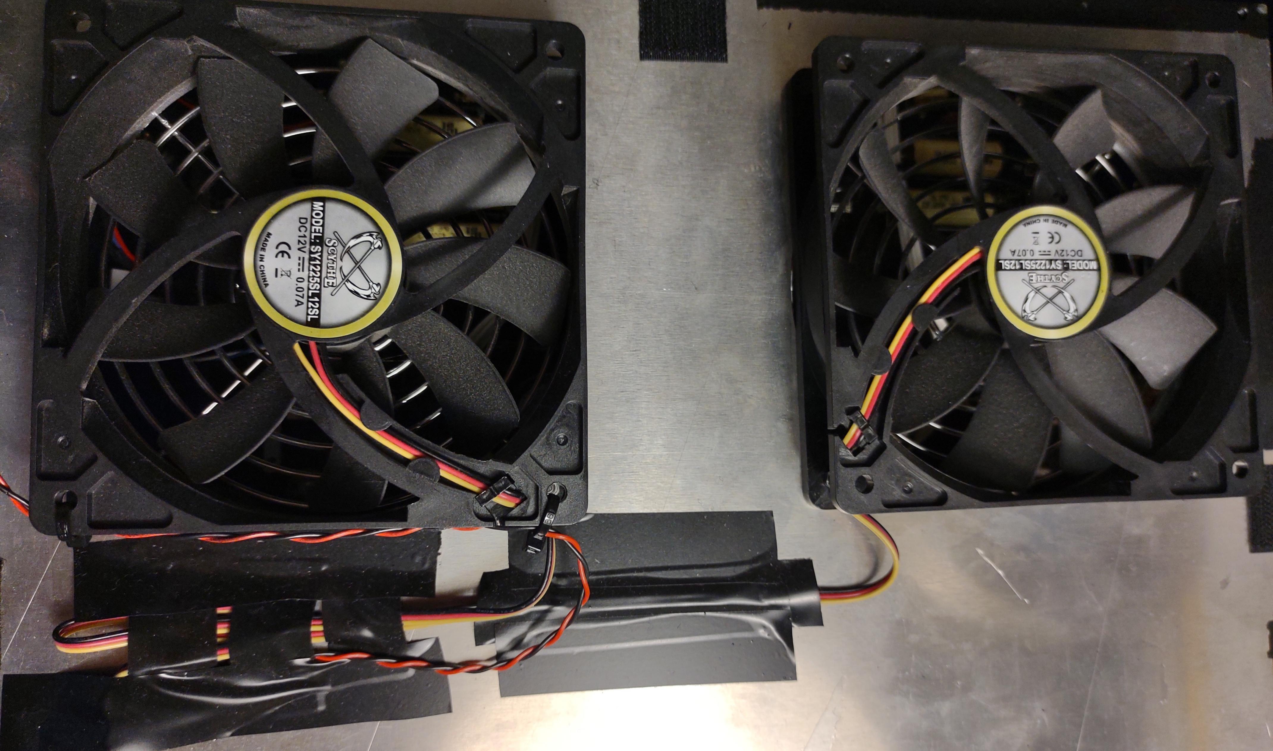

Taking the heat away
Taking the heat away:
Here is an effective way of reducing the heat. A wooden block with blowers as base plate for the amplifier. The blowers are absolutely quiet. It will reduce the chassis temperature of a GM20 by 20°C.
Hi Hans,
Referring to your thread from 2009 #23 "Taking the heat away" I would like to get somewhat more detail information on the blowers you are using.
For chilling the tubes I'm using right now passive cooling by means of Pearl tube coolers, see here:
PCF-175: 1.75" Dia. Power Tube Cooler
These devices dissipate warmth away from the glass of the 6C33 tubes working like heatsinks and as such can have a certain positive effect on lifespan of the tubes but they cannot
really lower temperature significantly like an active cooling with blowers as you do.
What I can see on your pictures is that they work with 12V DC and as I see only two red/black wires from each blower connected parallel to the power switch I assume that they work with a fixed
rotational speed ( not adjustable ), right?
What brand are these blowers and could you provide their part nr. please?
I would be especially curious at which rotational speed in rpm you run them and how silent they are ( noise figure ? ) .
Would be great if you could answer this as I would like to try that kind of cooling as well in the near future.
Thank you very much.
Günter

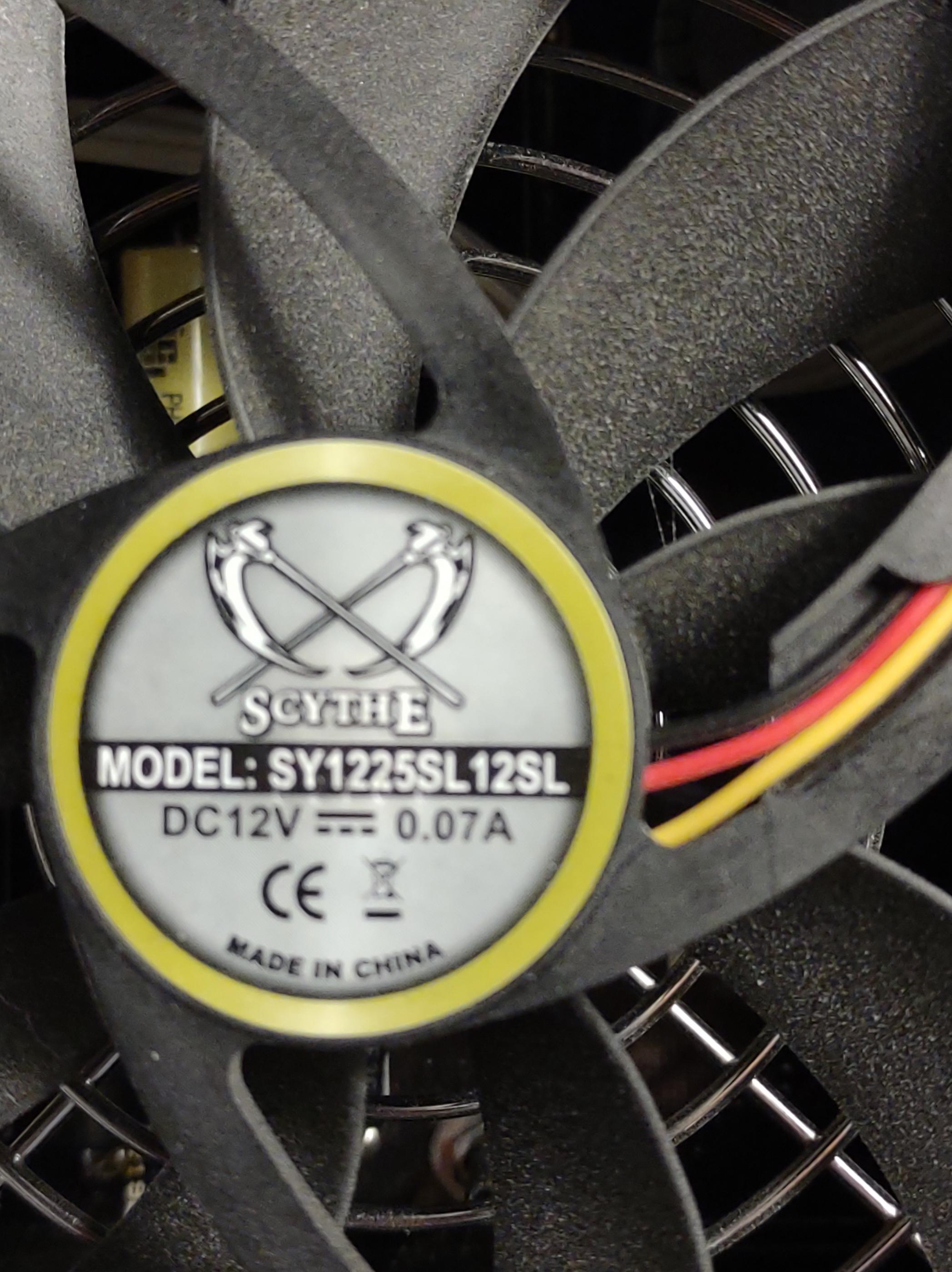

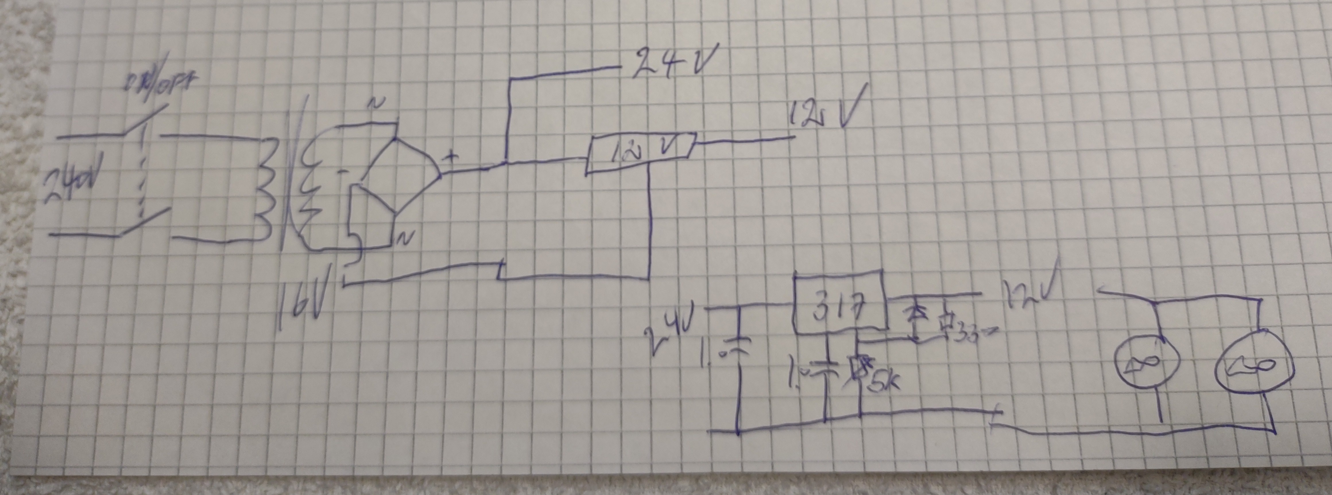

Cooling blowers
Hello Hans,
Thank you very much for plenty information on your chilling solution with the blowers. I appreciate that a lot!
Having looked up the specs of these fans I found that these are running at 500 rpm with a very low noise figure of only 7.5 dBA which is indeed extremely silent.
According to the Scythe website this 500 rpm 12SL version is discontinued however I have been able to find a source where I can still buy them at a very low price.
Only question remaining for me is why you run them with 11 rather than nominal 12V DC which results of course in slightly lower rpm.
So what is your concern or how did you find out to run them at 11V when you say "Adjusted for proper cooling. About 11V."?
Thank you once again.
Günter
Hello Hans,
Günter
Maximum isn't always best. Or required.
I adjusted down until I noticed a reduction in speed. Ended at 11 Volts.
Keeps it "cool". Way better than the original.

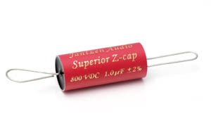

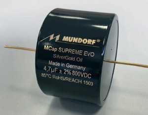

Did anone tried to upgrade the interstage capacitors (C1, C2) with sth like Mundorf Supreme Silver/Gold/Oil 1,00 uF 1200VDC
(please not the pic shows 4.7uF)
or, if the Mundrf doesn't fit, sth like
Mundorf M-CAP Supreme Classic Silver/Gold 1,00uF 1000 VDC
or Jantzen Audio Superior Z-Cap 1,00uF 800VDC ?
