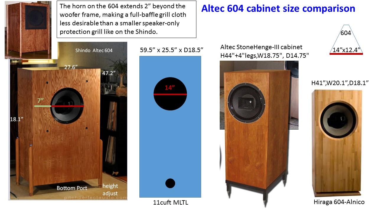

Jean Hiraga's personal explanation of his Altec 604-alnico cabinet construction draws-out like putting large Onken style ports on the bottom of the cabinet.

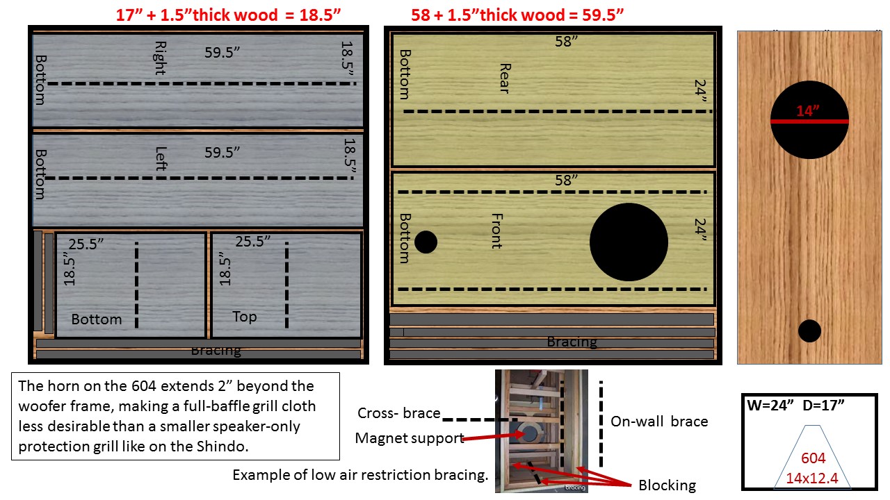

604 MLTL cabinet discussed

As an additional info, on my GPA 604 II the small horn doesn't extend beyond the woofer basket. It is flush to it, thus allowing a normal front grill.
About the Karlson pictured with Johnny Cash, yes, just raise it if image is low. Doh 🙂
It is the same with my Altec Lansing 604-8K, -the edge of the Mantaray horn is exactly flush with the outer rubber gasket on the basket. (That gasket is about 7 mm thick, if it was removed the horn would protrude 7 mm versus the woofer basket.)
Hmm, to me, this means low friction, which in speaker vent design 'speak' is either a very low vent mach [large] at one extreme or 'aperiodic' [resistive] vent at the other extreme or a combination of the two, so my SWAG is he's done both, which may include some fine tuning with one or more types of damping materials to both act as a protective grill and 'critically damp' it same as the pioneers did.
In short, in its simplest form and as previously noted by 'Linesource' earlier, an 'Onken' concept, floor loaded vented base with maybe a [protective] grill somewhere along its length: GPA 604 adventures
