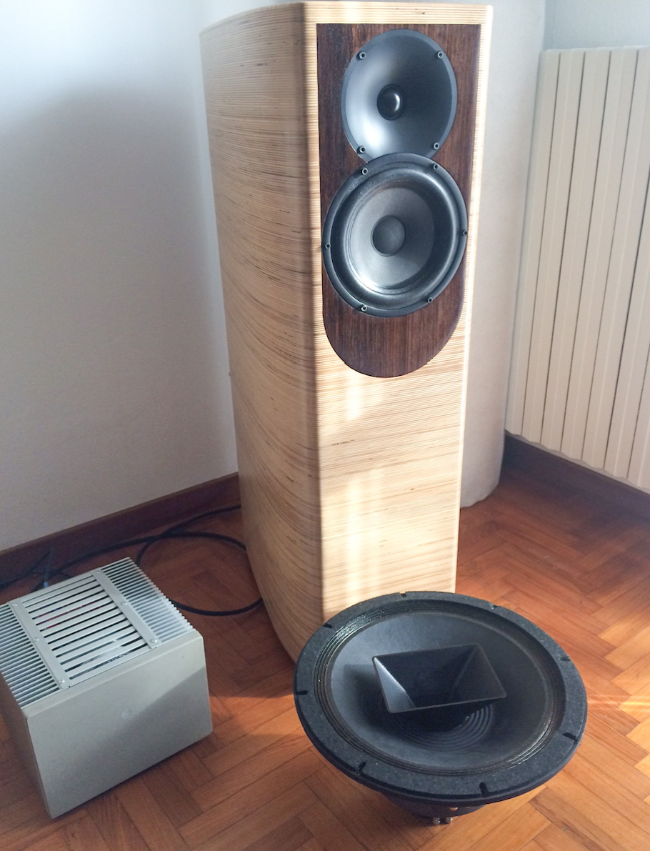

Hello,

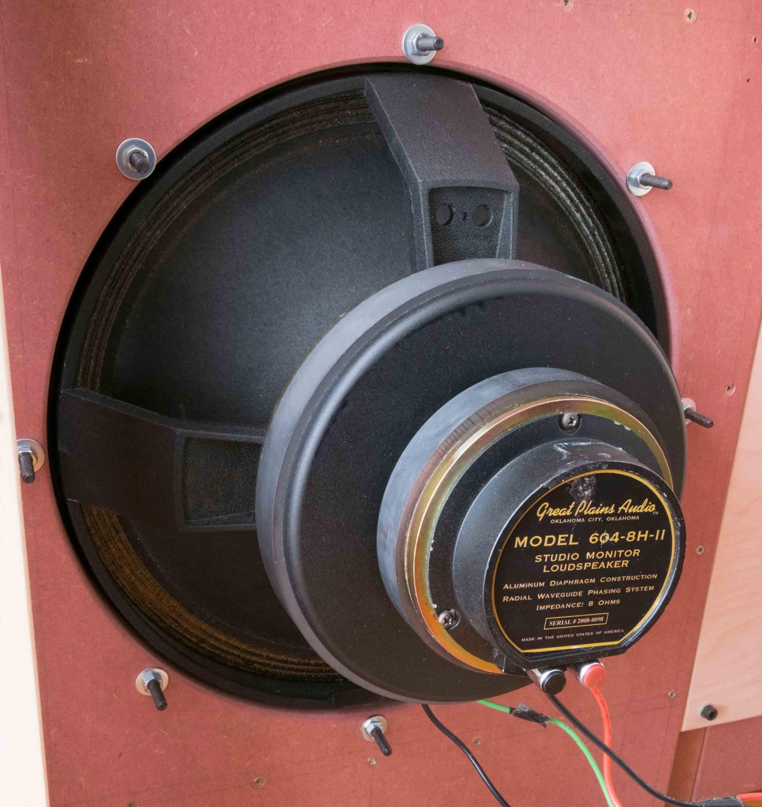

I've just bought me a used pair of GPA 604-8H-II in pristine condition, along with the original N 604 8A xover filters.
Compared to my Troels' DTQWT drivers, these things are huge !

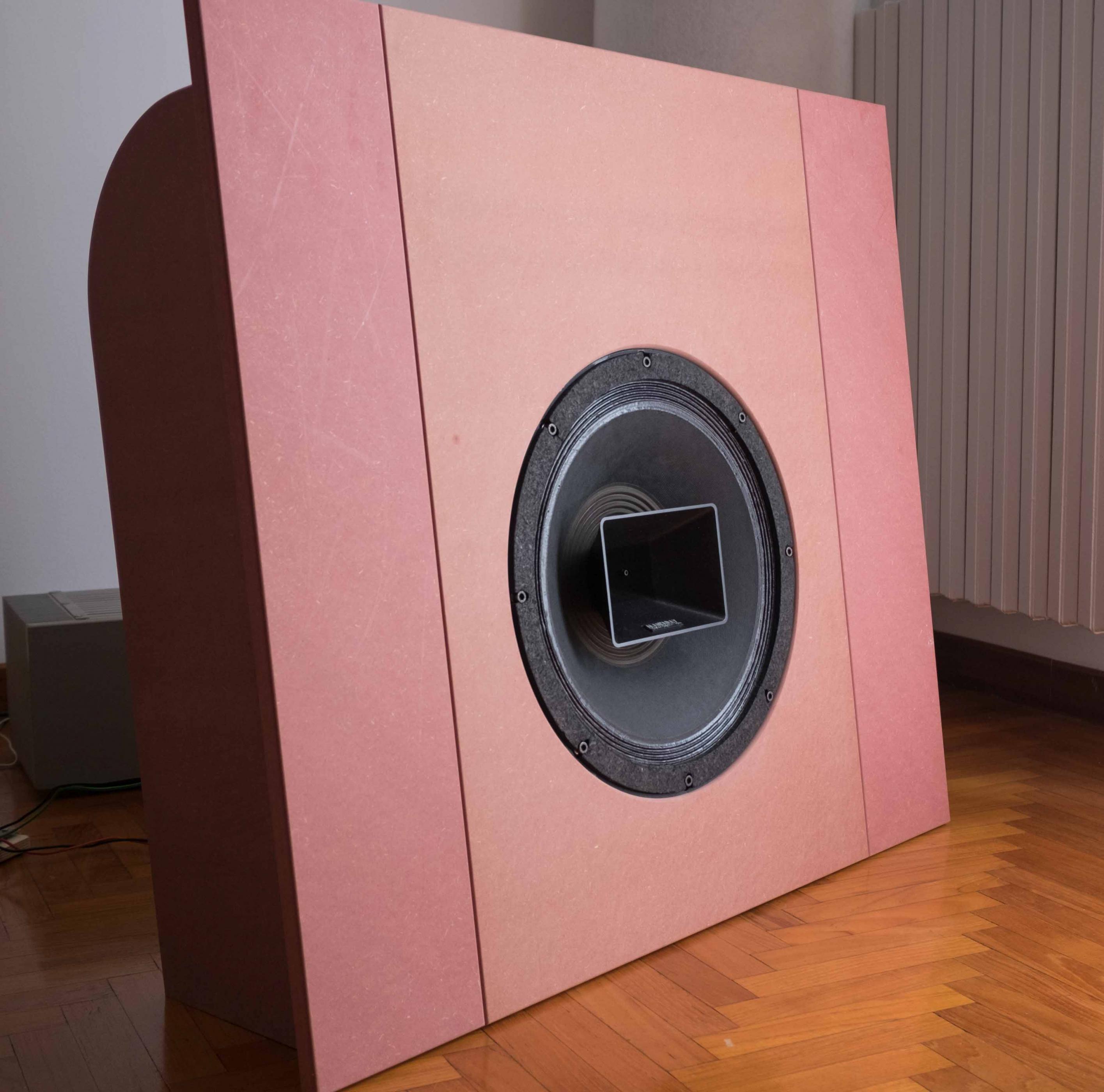

I put them in an open baffle (JE Labs style) and hooked to my Pass F5 monos.
At first, the speakers where mounted behind the panel, leaving a 40mm tunnel in front of them.
Big mistake. They were almost unlistenable with canned voices and muffled mids.
So I reoruted the boards as shown in pictures and mounted the salad bowls flush with the panel.
Far better. With some musical genres they play very nicely. The compression driver is in another league if compared to a dome.
Listening to a jazz trio is kind of mesmerizing.
But, they are (very) far from perfection. Image is low, bass is lean and human voices still need a correction.
Overall, my DTQWT's are better speakers, more able to cope with many music genres, although they miss the magic of the big coaxials.

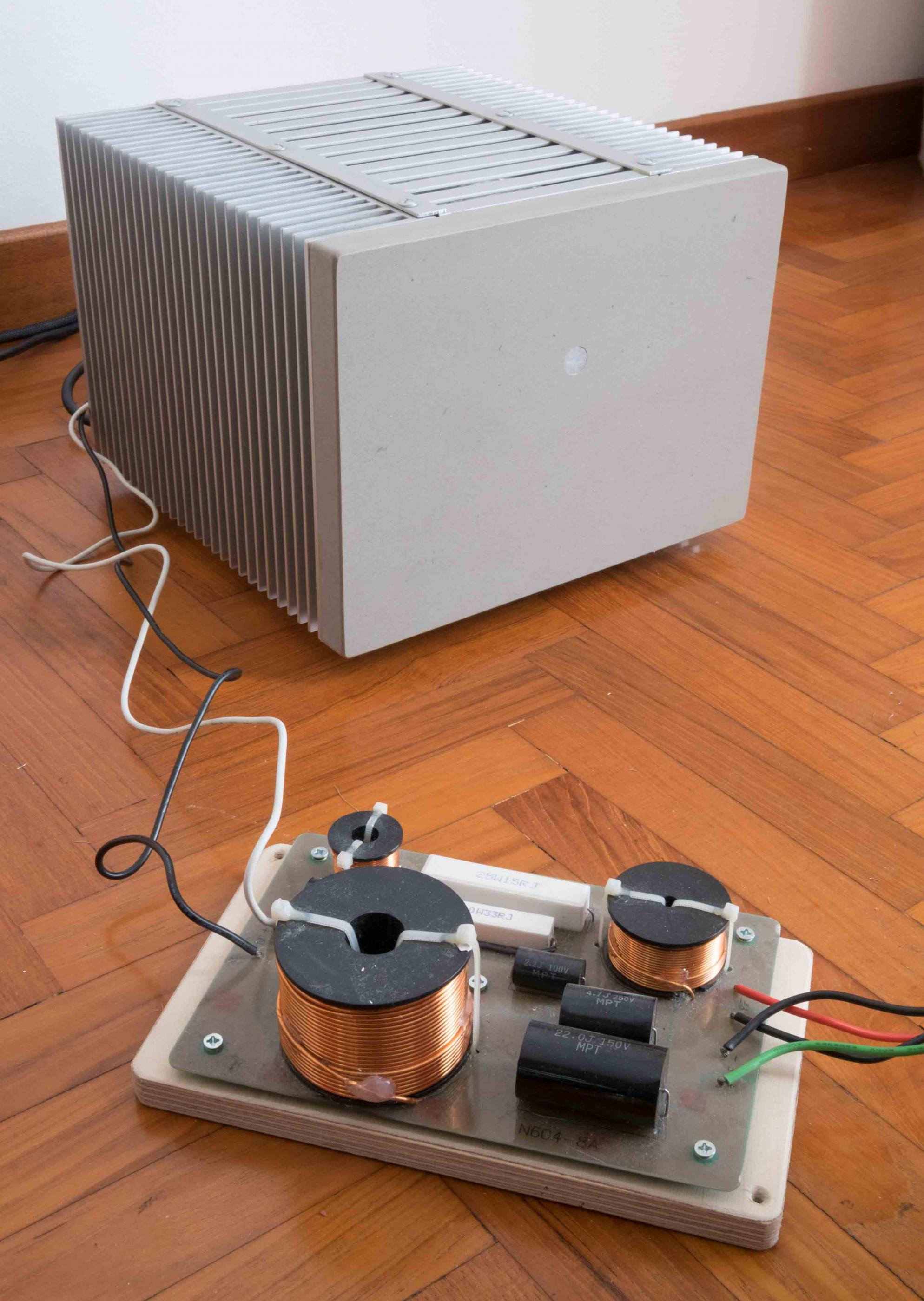

As a first upgrade I want to try this Jeff Markwart's filter:
Great Plains Audio 604-8H-III - Great Plains Audio
I'm going to build it with Jantzen's Air Cores and Cross-Caps. Then maybe in future the caps will be replaced with better ones.
I don't understand the attenuators schematics. I'd like to replace them with resistors, swapping them until I find the correct value.
Where I have to place a resistor for HF eq? Left side of L2 to C3, or right side of L2 to C3 ?
About MF eq I guess that the resistor goes from between R1-R2 to R3, right ?
Which range of values to allow let's say five steps of attenuation ?

Capacitors aren't that critical in the crossover, just pick good quality polyproplylene caps. Air core doesn't cut it in the low pass filter, a huge cored inductor with low DCR (below 100 mOhm) is the ticket for 604s. The shelving filter can be removed from the Markwart circuits.

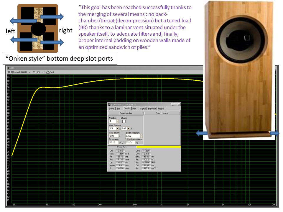

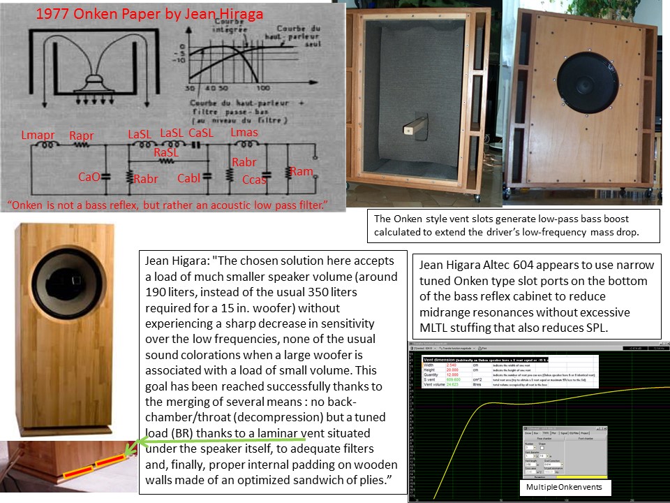

Hiraga's are very styilish, so bad he's not giving away the plans
Jean Hiraga's personal explanation of his Altec 604-alnico cabinet construction draws-out like putting large Onken style ports on the bottom of the cabinet.
