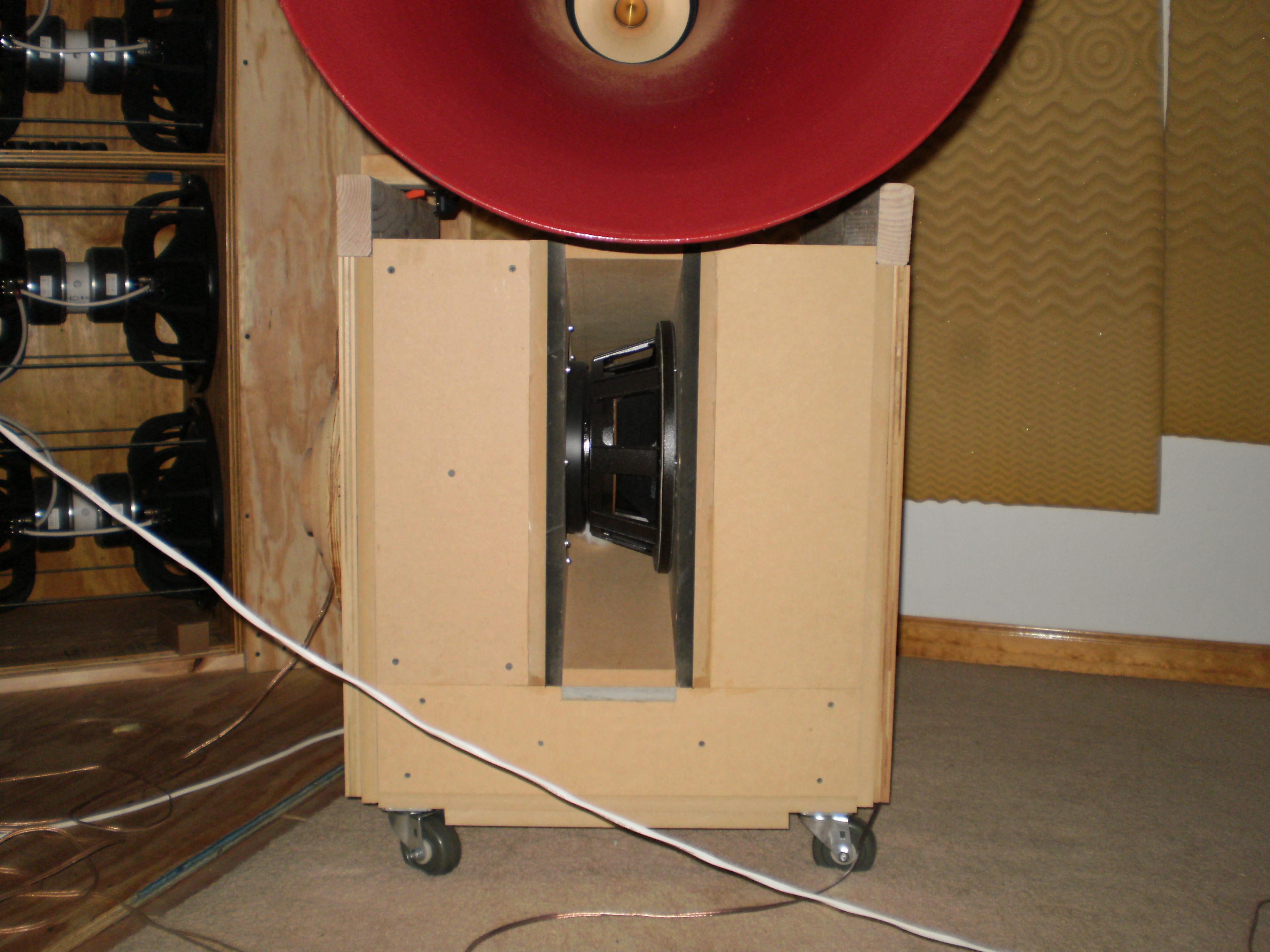

Regarding ported sub: below 100hz this is the best solution. You know that I've tried everything: H-frame, tapped horn, W-bin, Onken, spiral horn and so on. Ported sub with high sensitivity big driver is the best! I don't hear it at all. It just makes big instruments bigger.
I would say I agree with your assessment. "Gimmicks" don't work. You gotta be able to MOVE AIR.
GO BIG and get it right 🙂

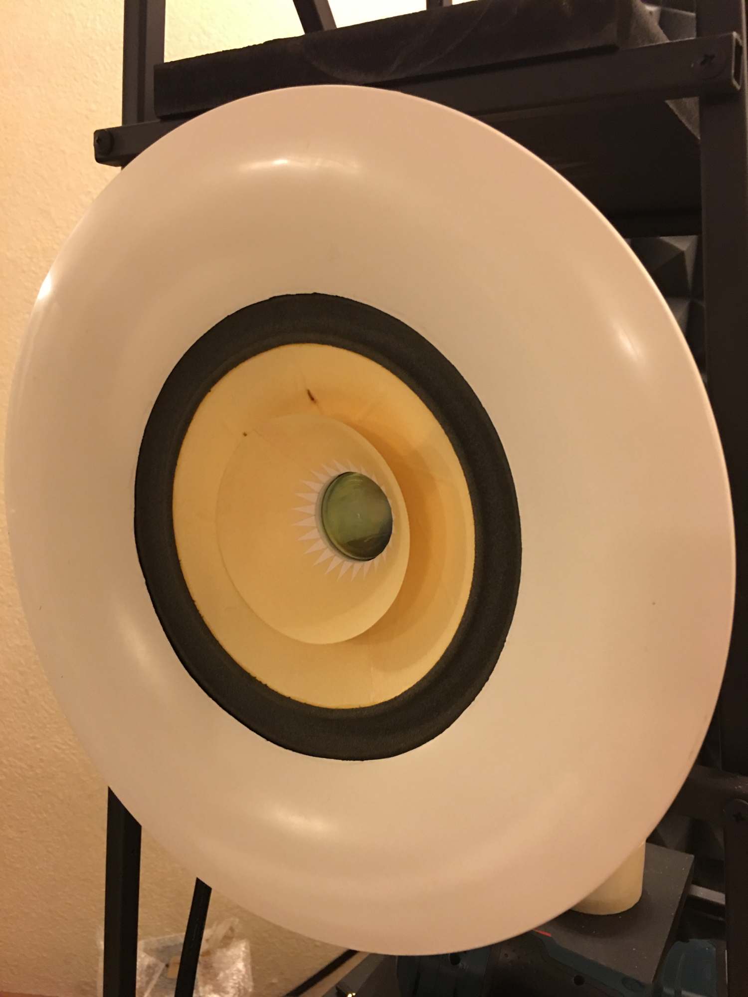

Believe me, AER has zero distortion at HF. I'm very sensitive to HF distortion. I've never used horn HF because of it and the only HF I like is from RAAL and top diamond tweeters from Seas and Accuton. So, AER clearly outperforms even them! I've never heard such a perfect "ssssss" and "sh-sh-sh" in voice and violins are very sweet. With any kind of distortion you'll loose sweetness and brilliance. AER's highs are so resolving that not every source works well. You need extremely good DAC or vinyl to get perfect HF, overwise you can hear distortions of your electronics.
Regarding lower mid: I have zero horn coloration, because horn is very short for this frequency range. This is possible only because of LeCleach profile. LeCleach works just from fc and 2 octaves there's is no reflections inside horn. Horn works as clear transformer.

How can I hear coloration if theoretically there is no coloration ?
Depth of my horn is 0.5m, so you can easily calculate, that it corresponds to 680hz, so from 680hz we'll have reflections, but at frequencies lower than 680hz wave length is longer than horn! And in my case it works till 400hz (wavelength 0.85m), so there is no any reflections inside. Horn works as pure transformer.
I hope that it is clear.
My next move is only upgrade AER. Now I have BD1B and I've just ordered BD3. But also I got unique offer from AER to buy their top drivers BD4 which they only use for their top speakers and not selling separately. Imagine, that sensitivity of BD4 is 119db in free air without horn! Incredible efficiency! This is best performance in the world, I believe! But also extremely expensive, so I'm going to sell my GOTO drivers. BTW, if someone interested, I have a good collection 🙂

I suppose an 18 inch per side is entry level into being able to MOVE AIR,
that is, to move enough air to keep up with a horn system.
8.83 cubic feet, tuned to 29Hz will get you there 🙂
Go BIG, and Get it right !!
B&C Speakers
The impedance coupling to my room is better suited by a closed 85 liters box because of its the size (9m²)
It gives me a flat response at the center of the room and d'ont go lower than small drivers but the rendenring is vastly superior in term of definition, impact and resolution...
Sound velocity is the key, it is not easy to catch the air with a slow motion.

While I have not audited this system, I suspect it will deliver suboptimal performance for its price point. Here are some reasons:
The Kluge:
dated whizzer cone technology [1] married to horn loaded Goto Unit CD.
The BD4 with its advertized flat on-axis frequency response should not require support from an additional compression driver. The reason for its use probably has to do with maintaining a wider radiation pattern at higher frequencies. Two good horn loaded compression drivers alone can get this job done to any degree of perfecton your pocketbook can afford.
Caveat Emptor:
In audio marketing beware of two things:
1) the amount of money they want and
2) what they are NOT "crowing" about.
[1] Whizzer Cone Technology
implements a mechanical crossover between two concentric radiating surfaces driven by a common motor. At lower frequencies they vibrate together as a single unit, at higher frequencies only the whizzer alone vibrates. Front loading this arrangment with a horn is contraindicated.
WHG
WHG
I agree with this statement. After experimenting with 300hz and 400hz horn, I put it in 550hz with almost no depth, so it is actually small buffle
WHG
A Whizzer is already a horn by itself :Popworm:
