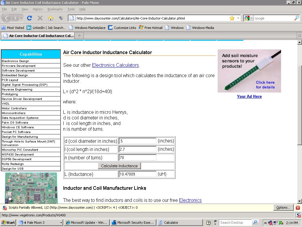

If you go air core it does get fairly large, although you can access the calculator here.
Air Core Inductor Coil Inductance Calculator
Yes that would work with 0.8mm wire.
