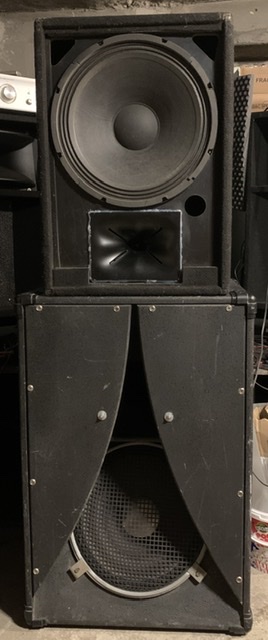

I moved the K15 to the main room, on top of it there is now the UICW box to try the UICW with a Karlson as the (mid)bass unit. And a variety of K-Tubes to be tried as well, including the ones inside the mid horn. Sadly, no time for measurements or listening.
