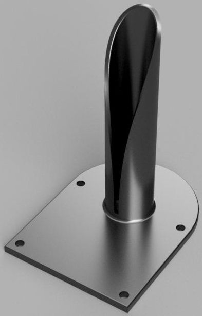

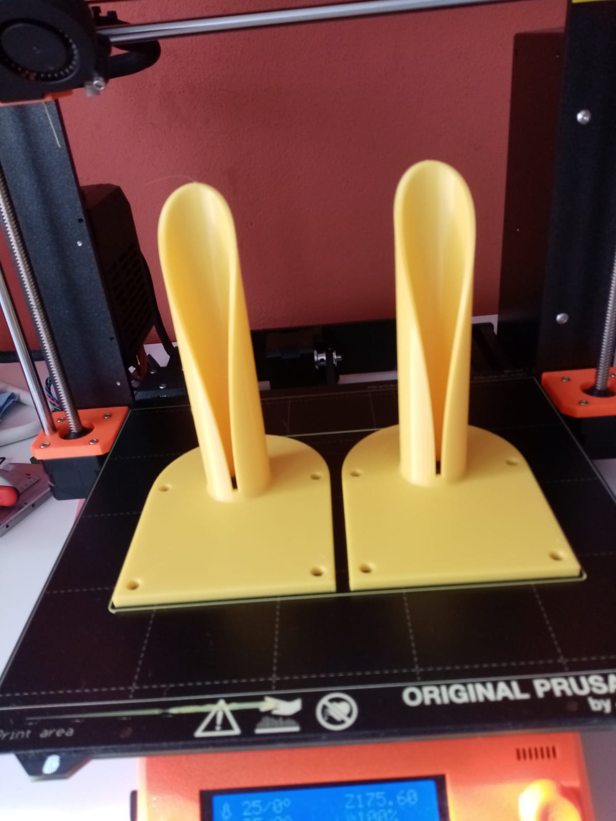

I have BC DE500 and Beyma CP385/Nd at hand to try the K-tube. I would actually have one 3D printed - if I can draw it up in Fusion 360. Is there any information on how exactly should the slot look like?

the way I made my scheudle 40 1"ID pipe K-tubes was to print a half ellipse based on an 10.6" major axis with minor axis being pik XZ the outside diameter of the pipe sans 1/8" at the start of the slot to provide a gap. It may be reasonablyh non-ctitical. Because of the thickness of the pipe wall, the slot ended up somewhat smaller.
A K-tube like that can be extended in length but I think adding an unslotted stub may introduce a dip (?)

I am trying to draw that up in 3D, but I am failing...I will try to give this task to someone more experienced🙂
Some measurements of the K15 clone: 841 x 564 x 447 mm (external HxWxD), front shelf 433 mm from the bottom, 113 mm wide, 97 mm to the wing backs. Rear shelf is 100 mm wide, 85 mm to the back wall. All made from 16 mm plywood. Measurements taken with tape measure, so it is +- a mm or two at the hard to reach places.
Edit: As a bonus, a rendering of the K-Tube STL file🙂

those look splendid ! - - how thick are the walls ? how long did it talke to print one tube ?

The base is 5 mm and the tube walls 3 mm. The guy who printed them said it took 12 hours to print the pair in the picture. I will listen first and then do some polar measurements in both planes.
they should be pretty inert. I think within their range limiations (on the bottom) that they tend to sound very good and can be listened to at fairly close distances.

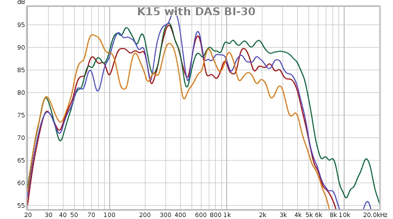

Here are some random measurements around the room, vertically +- around the top of the cabinet and some 1.5 - 2 meters away.
The orange trace is around 45 degrees of axis. So I would say a 90 x 60 horn on top of the cabinet crossed over at ca 1 kHz should be a good match. I think I will try one of my JBL2380 clones with a JBL2445. I will also do a quick test with the K-Tube crossed over at 3 kHz, but do not really expect ideal results.

That's a nice response - sometime if not toop much labor, would you draw the port ? (doies it have an odd shape?)
Most of my compression drivers worked well with 1K8 highpass (3rd order)
2380 wih CD EQ should be pretty nice on vocals, etc.
