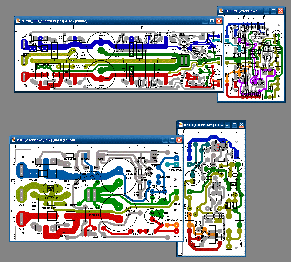

I see you want to try them all . I have , but after giving away or throwing out the last one. 🙁 This becomes expensive and tiresome. My NEW idea is to go MODULAR. Separate power board and a whole slew of classic AB voltage stages to mate with. I wish I thought of this before as I would have a lot of un-wasted resources to choose from now.
Completed :
AX1.1VB - Doug self "blameless" - pure , lab like amp .. simple.
BX1.1VB - Classic bootstrapped amp- (I own 2 of these - 18 months) , like DX , aksa55 ..etc.
CX1.1VB - balanced VAS- good bass , crystal clear vocals (I have 2 of these- 13 months old)
GX1.1VB - APT1 clone - built it but gave it away. Sounds like CX , but better bass (cascoded - needs 70V supplies.)
Power boards -
PB60 - 1 pair any modern output device or driver , C-R-C filtering for voltage board , built in Vbe. (35-50V unit)
PB250 - 4 pair OP devices , SUPER fat rail busses ,ESP project 15 Cap multipliers to power voltage boards , Vbe , and 6800uF X 2 onboard filtering.
(55 - 80V supplies)
ALL voltage boards can run either power board, never get bored. 😀 Don't like the amp swap out 7$ to 20$ voltage boards.
ALL are available below on my link (mongrel folder).

Are you sure there is one amp that will satisfy you ? If you find differences between all these amps you will likely hear them between any other amps you build - each one having it's own personality probably means that you'll not find one design that will satisfy you on all music types for all time.
OS has the idea - make it easy to own more than one amp with something modular. I remember at least one person had built the F5 and F3 into the same chasis with a switch to choose between them depending on the 'mood' 😀

OS how would you accomodate the diffferent voltage requirements ? Multi tapped transformers ?

If its possible, maybe small scale BA-1 with gain trafo instead of driver board, and a simple tube pre with good gain and drive 😛
