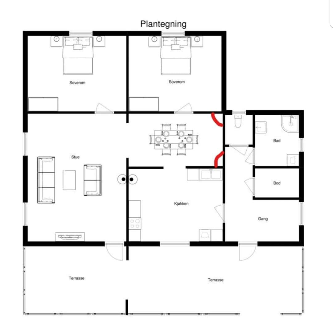

I have a pair of FE206En in a Kirishima cabinet. But as my nick states, I'm downsizing my living... moving to a smaller house. So it might be that my BLH is too much for the smaller room. Any advise of what kind of speakers to consider?
I've tried to read about Karlson/Karlsonator, some corner horns etc. I'm rather good with a jigsaw/nailgun/hammer/gluegun, but not that good at speaker theory...
Looks like I ends up with a placement where the wall behind the speakers are less than 3 m. wide. Wooden walls on both sides. symmetrical opening on the sidewalls after aprox 2-2.5m and open into a large living room behind the listening position.

I might add that I'm not after a speaker that will fill the "big room" but play good my smaller "room". See attached plans. The red marking is where I plan to have the speakers, and the table in the middle of the room will not be there..
My current speakers will, for sure, fill the main room as well as the smaller part with sound. I'm just afraid that it will be too much bass.
That's true! My intention with this thread is just to seek advise about what's suitable for this driver in case I have to do something more drastic. It's the smallest room I've ever planned to have a decent stereo in, so I'm on unfamiliar turf. 🙂
