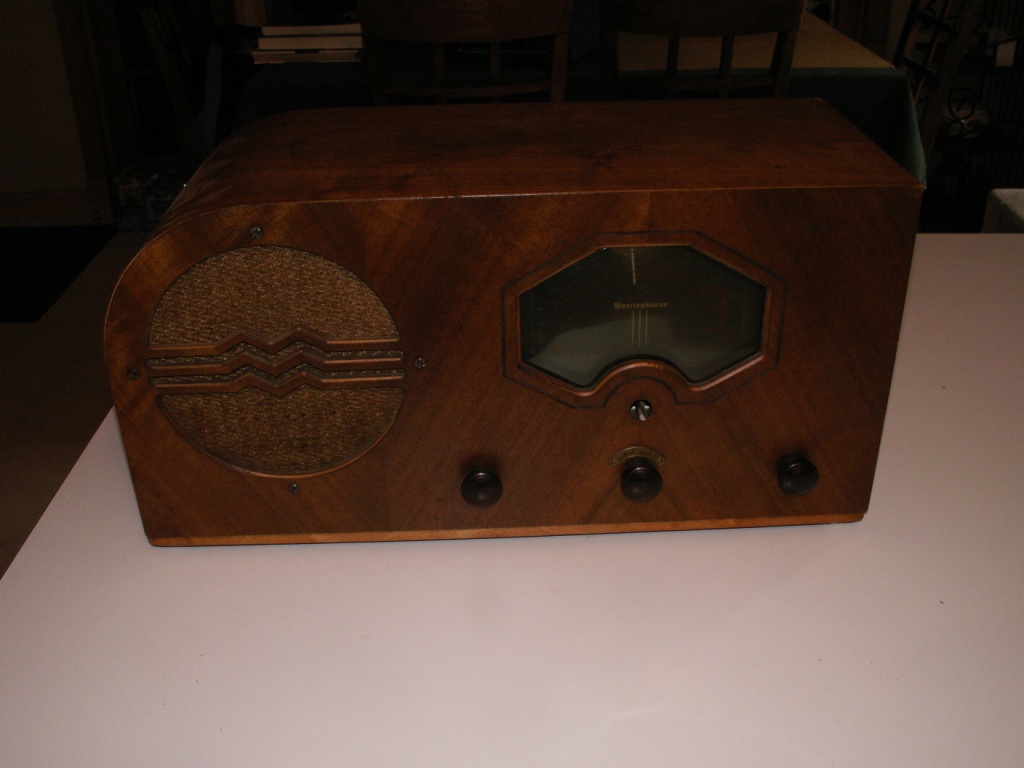

A coworker brought me this Westinghouse Canada Model 511 radio today. I mentioned in a conversation a couple of weeks ago that I had an interest in tube amps. He has been collecting them for several years and said he had one that he would give me if I wanted it. Cool! Of course I accepted his charity. So today, sitting in my chair when I came in my office was this beauty.
It powers up and even receives a station or two. The sound is very scratchy. Even walking across the floor near it causes some scratchiness in the sound as the floor vibrates. When I move the tuner dial, VERY scratchy.
It's got 3 bands: SP, MU, P.B. I'm at a loss about these, except I know one of them is AM.
It's also got a volume and tone control.
So, I'm not sure where to start. I'd say the volume and tone control need De-ox'ed and Faderlubed. The tuner needs cleaned, so I suppose that should be next. And then a recap. Somewhere along the way, the bulbs around the tuning scale need replaced too.
Can anyone tell me about this radio? Any advice or suggestions? I can use all the help I can get! Thanks.

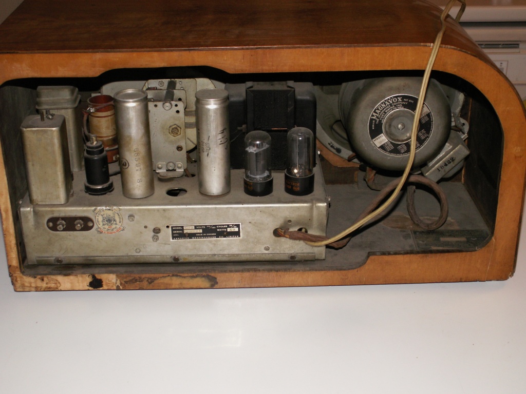

Wow, does it receive stations without antenna connected? Great!

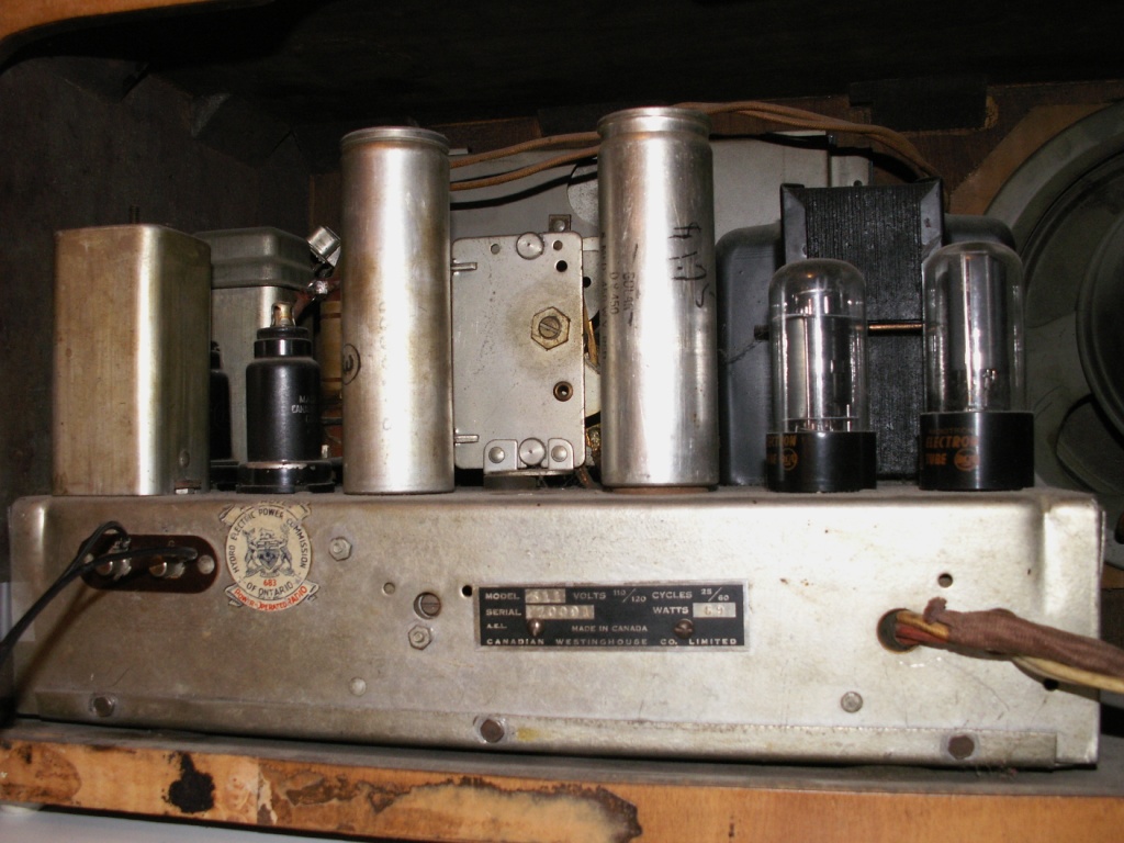

I would start from replacing filter capacitors. Leave old high cans as is, just unsolder wires from them and put under the chassis a couple of modern caps, they are much smaller in size.
Second, you need to clean a variable capacitor. Most probably some dust between stator and rotor plates caused it to be scratchy. Or sliding contact that grounds the rotor is dirty and oxidized.
Then remove all paper was capacitors and solder instead of them modern film capacitors.
I suggest you to do everything one by one.
You may check also values of all resistors, carbon comp resistors of such an age usually drift a lot.
Then you will need to align it carefully. For the beginning, don't touch IF tuning slugs. Just tune it to the highest frequency (rotor plates off the stator), then carefully adjust trimming capacitor in input selector tank (don't adjust the trimmer in heterodyne can!) by maximal loudness.

I have an Atwater Kent with that style of electrolytic can capacitor, I'm surprised the radio works at this point because those caps should have dried out by now. (Wet electrolyte type)
I rebuilt mine by cutting off the tops and installing modern electrolytics inside, keeps the chassis uncluttered and period.
The speaker driver appears to be a field coil type, the field coil being an integral part of the power supply Pi filter. I'm glad to see a power transformer.. Check the condition of the wiring to the speaker, and I would replace the frayed jacket with a new one if the insulation on the wires is not too brittle. Otherwise you should replace the entire cable. The line cord should be replaced.
In general it is very bad form to just plug an antique radio straight into the wall without first ascertaining its condition. This a good way to damage irreplaceable parts beyond repair, and the potential fireworks (exploding supply caps, burning power transformers, chokes, etc. ) can be very unpleasant.
I'd guess this is just very slightly pre WWII.
My Atwater Kent 310/510 chassis only needed two new electrolytics to get it going again, everything else was fine. All resistors, mica caps, paper and the magic vane tuning meter were ok - I did need to replace a very limited amount of internal wiring.
