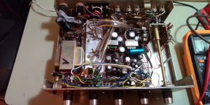

Got an old broken receiver from the 60s, repaired it but the noise floor is still to high.
It is an AM-320 from palace audio, it only had a broken powersuply cap. So when I replaced it I was like: "Wow that was easy" but noo!
I mean, it does work now. But the noise floor is terrible (like 50% signal 50% noise)...
I was wondering if I could get some guidance for where to look next... Maybe the potentiometers make bad contact or the transistors grew to old and need replacement??
I would love to get it running, it would be my first "old vintagy" amp.
However, making a full repair (replacing every cap, etc) wouldnt appeal much to me lol...
Here are some photos: (The transistors are: AD162 and 25B474)

What is "noise"? Hiss? Humm? Crackle? Static? Lawnmower? Motorboat? Steven King Radio?
And what does or does-not change the noise? Volume? Bass, treb, balance? Tape, phono? A good shake?
The amp is old and as you can see by the double-stamping made as cheap as possible. So almost anything can be bad.
A mix of everything
It sounds like a rainy beach or a waterfall
Noise of the aux in:
https://drive.google.com/file/d/1shIefIDQrlN9YA5C3c3h2nIoKKjUiOMc/view?usp=sharing
The noise changes depending of the input (i plan to use mainly the AUX in to use it with other equipment). The vol knob only has a little hiss when it is on maximum (but does not amplify the "other"? noise).
The bass and treb controls changes the noise tone.
The sound does not change when shaking it
This "waterfall" noise suggests that one or more voltage amplifier transistors in the audio section may be defective. I've often found this fault on early '70 Pioneer amplifiers, The transistors may become noisy. High value resistors do sometimes becomes noisy too.
Some resistors are probably out of spec and have gone noisy. I’d look at them before any transistors. Transistors tend to either work or not work at all. I’ve had a bad resistor cause measurably higher distortion in one channel compared to the other. That was a fun one to track down.
Do you hear the noise in both channels or just one? What happens when you short the inputs?
Reactions: indianajo
A mess:
Looking at It gave me headaches... It's all mixed up lol
But I could recognize some things:
All the inputs go to the selector and then enter the vertical PCBs that have riaa and preamplification depending on the input type.
The output of that goes to the vol pot (it attenuates) and then to the balance and the tone controls
Then it enters the main PCBs (I didn't unscrew those because I was worried to break them).
Probably the noise comes from these...

Looks pretty messy but the component count doesn't seem too bad. The output transistors are probably transformer coupled judging by the looks of things. But why one is mounted different than the other? If you're serious about keeping it then I would replace all the electrolytic caps and most of the resistors. Unfortunately there doesn't seem to be a schematic available.
I think they didn't had enough components when building it and used equivalents, or maybe someone replaced them before me...
Hmmm or maybe I could scrap it and use the transformers and the enclosure for something else (I really like how robust it looks). Or sell it. But I'll keep it for now...
