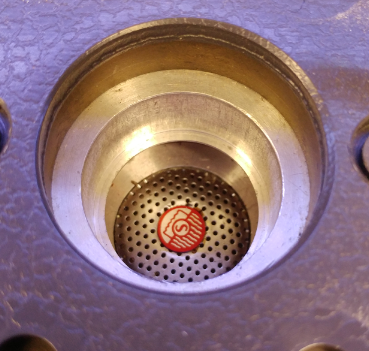

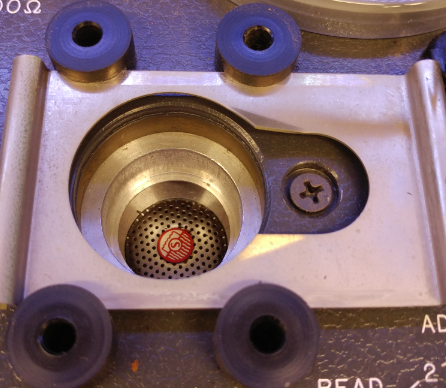

Here are some closeups of the clamp assembly dismantled. And of the opening. This opening is 1.125" ID with a thin flange at the bottom the mike would sit against. Its dimensions are consistent with the first gen GR microphones 1560-P1, 1560-P3 and 1560-P4 1 1/8" (1.125") microphones. The notes indicate they it comes with an adaptor for the 1560-P5, 1560-P6 and the WE640AA and B&K 4131 condenser microphones.
Yours may have the adaptor in place and that's part of the issue. What I need is a version of that adapter for the 1" (.936") (GR part number 1559-6080). It suggests its just a sleeve (see pg 6 of the manual).
From your description of the unit there may be some corrosion holding the sleeve in.

Wow, that's nothing like mine! You may be right, I may have an adapter stuck in there, but I didn't notice a parting line where the adapter would end, and what you show there, begins. I'll have another look tonight and see if I can get a decent photo. BTW, is yours an A model, sans the 4-position range switch, or the B model like mine? Thanks!
Edit- Holy mother of stuck stuff! I got it out and now it looks like yours. It wouldn't move at all, so I slipped a couple drops of alcohol down the edge and worked it sideways until it moved a thou or so. Then I just kept on and eventually it started to move. The "sleeve" is a bit more complex than that, but nothing hard to make unless you include the three ball friction devices. Those are held by an O-ring, that probably also made the thing impossible to move. I'll make up a detailed drawing of the thing. If you have access to a lathe, it should be easy enough, or if you can wait until spring when my garage thaws out, I'll make you one. I think with a little polishing and a light film of lube, mine will be much easier to get in and out. BTW, it does have a long groove down the inside to vent the chamber, until near the very end, where it stops and seals. Not sure how they did that, maybe a shaper, but it would take a very special milling cutter to duplicate it- tiny ball end on a long shaft.

No lathe here. Too much other stuff to grab my attention. I would make the sleeve from delrin. Less likely to freeze and otherwise the same as the ones B&K provide with the pistonphone. I would need a slightly different version I think since I would need it to work with the B&K microphones and the voltage insert adapter. That will be my bigger challenge for now. Per the instructions I need to remove the grid on the microphone (always scary). I checked the insert adapter I have and that won't fit. But I may be able to modify a mike preamp to support the insert voltage necessary for this project.

Can you take some pictures of the sleeve? One issue would be compensating for chamber volume. The B&K adapters for the pistonphone has cavities to add chamber volume to compensate. They may be overkill on this level but .1 dB is essentially 1% so all these details become important. B&K's software gets inputs for pressure, temperature humidity microphone front cavity volume etc. And a single calibration for one frequency can take over 1 hour. The GR won't measure to less than .1 dB and even that is probably not fully valid but still all these issues are important.

Even after cleaning everything, and removing the o-ring, the adapter is quite difficult to insert and remove. Very little clearance and any dirt or corrosion would make it near impossible. Sort of like it was. Anyway, here's a drawing with some decent dimensions. If I were to make one, I'd knock off a thou so it wasn't so tight. Photos when I get a chance.
Polished it up with the Simichrome and applied just a shine of Superlube PTFE grease and now it moves freely.

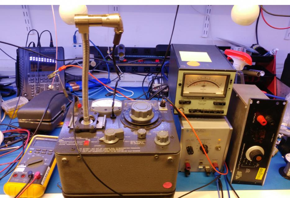

I'm using the HP467 amp into the Optimation stepup transformer to get the drive signal. Not shown is the Boonton 1120 analyzer that make the process pretty quick. It has a relative function for level, reads out to .01 dB and has a really nice source to drive the amplifier. In checking the source might need to provide as much as 3W of power.
Next steps- figure out how to fit a condenser preamp into this chain with the voltage insert capability. Then sketch out the adapters for 1" and 1/2" mikes. And to build my calibration interface setup. but at least I have it running after 10? years in my collection.

Here is what I got measuring today. Next step is to compare against a known standard.
100 Hz -60.0 dBV
250 Hz -59.9 dBV
1 KHz -59.2 dBV
3 KHz -58.2 dBV
