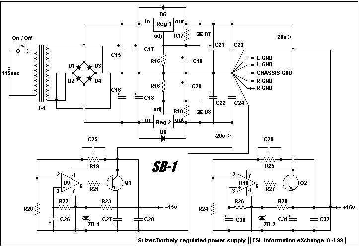

I have TL431 based power supply for my TDA1543 dac. Would like to make something better. Tried to trim down Sulzer regulator- it has got down to 7,88V. I need 7V . Could anyone tell me what to do please.
Also the opamp is NE5534 and the output transistor is 2n2905 and 2n1711 (one for positive and one for negative power supply- I would use only positive to supply my dac). I am using LM336-5V in Sulzer Borbelly configuration.

I think I would like to build it for my dac - that is for sure but it is to much for now- to much money in fact- I would like to modify Sulzer that I allready have (schematic attached). If You would kind enough to tell me what to do and also what to do with Your power supplies to have at the end 7V and 5V for digital power supply I would be most happy:cannotbe: :cannotbe: :cannotbe:

In your schematic, you need to change ZD-1, R19, and R20 to get the desired output voltage.
FRED - Yes- that is the feeling when You see great stuff and when You know it must wait because You want to make Your headphone amplifier - possibly jwb's aleph headphone, Your new tube preamplifier, and know that Your friend has made Aleph 5 clone and that it would be nice for You to make some Aleph X to compare them since You have only a small Onix preamp and amp. How the :hot: am I going to make way for that big and good regulator? By the way Mr. PerAnders has some more nice things on his site. Oh, boy......
JWB- I did substitute R19 and R20 (in fact the resistor devider in positive half) but leave LM336-5,0V. The lowest I could get was 7,88V. I don't know if the NE5534 would work on 7V correctly. I could replace LM336-5,0 with LM336-2,5 and try to turn it down further. Tomorrow I shall go and buy some LM3336-2,5 if my NE5534 would work correctly.

If you put a resistor in parallel with C26 & C30, to lower the ref voltage, you can get easily at 7 V or lower, without any other changes. Just make sure tha opamp works with those voltages on its input and as supply voltages.
Calculate the attenuation of R22 and the R // with C26 so it becomes say 5 v, and make the feedback divider 1k and 2.5K, presto! 7Vdc.

R15,16 14.0k 1%
R17,18 1.0 k 1%
R19,25 6.19k 1%
R20,24 3.01k 1%
R21,27 47.5 ohm
R22,26 47.5k 1%

The attenuation of R22 is not very much because it is R22=47k5.
I have modified the original circuit like this (trying to get to the 7V output); changed R19=3k, for R20 put 5k trimmer. Trimmed it until the voltage stop rissing. Estimated voltage was 7,88V. SoI have thought to put 100k in paralel with C26 to lower the voltage of the refference. The output voltage was around 0,5V. That was done the day before yesterday.
So I must have been doing something wrong. ZD1 and 2 are still LM336-5V. I will try to find some LM336-2,5V and connect them later today. Hope this would help (without the resistor in paralel with C26) if the opamp is working with that voltages (NE5534) which I doubt.

I have tried to put 100k across C26 and my output voltage dropped to 0,5V or so. Would try to put something bigger in that place. What I can do also is to put LM336- 2,5V refference. That I will do today also and let know.
Hi!
I have changed LM336-5 (5V reference) with LM336-25 (2,5V reference). With trimmer in place of the resistor going to ground in voltage divider I have trimmed the value of the output voltage to 7V and it is working o.k. I must correct few things (specially to lower the output voltage of LM317/337)and it would be it.
