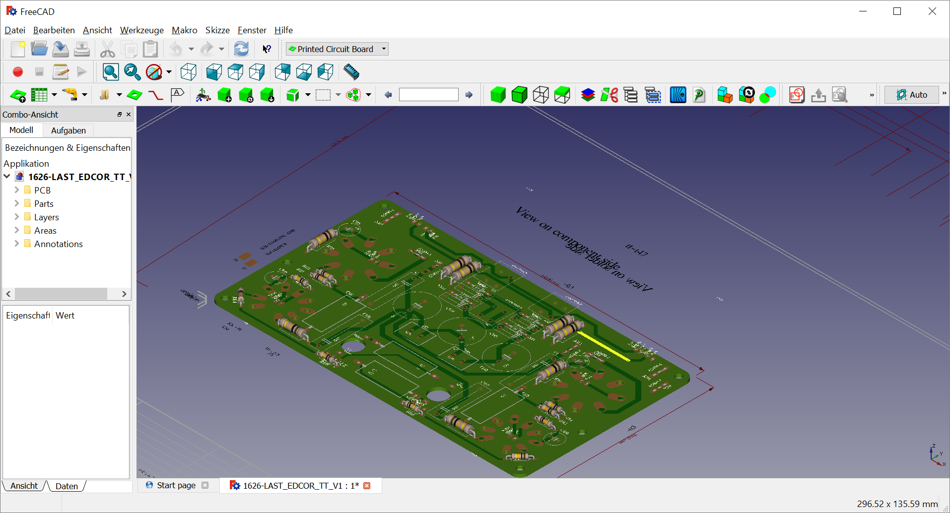

Hello,
FreeCAD PCB allows direct Eagle BRD import. Starting evaluation and I´m very happy about results.
FreeCAD propose a lot of differents export formats, not only STL!
Playing with 3D-STEP component allocation (not really deeply explained in good documentation): same as for SolidWorks CircuitWorks, not really user friendly.
I need to translate manually my SolidWorks components (parts, assemblies) to STEP back again!
(Foto shows EL34 Amplifier Eagle BRD import)
More to come, if someone is interested.

Hello Albert,
you've to map STEP models and they're simply not available!
Somr models at GRABCAD others at 3dcontentral: the common tubes principaly.
I've my own library using SolidWorks (sockets, tubes) and growing: my wife is working on the 833C model.
I've asking years ago the community for used tubes for 3D modelling and still waiting for an answer.
Would be nice to build a STEP 3D audio components library...

I am actually new to 3D modelling, I' ve seen Sketchup and they seem to have a nice 3D models for audio amplifier.
I was actually doing a build documentation for an SS amp, I realize it might be a better idea to just create a 3D model of the amp, showing between stages of the assembly process rather than taking a snapshots of the actual hardware which is time consuming and you need to edit the images to make it smaller in file size. Learning a new CADware could also be time consuming but the benefit is a new knowledge/skill is gained.
Having said that, will Sketchup to the job better than freeCAD. My concern is the availability of parts model, that is you don' t have to spend lots of time finding the correct parts and models. Does it have an available single library models for electronic projects.?
I have both CADware package, Sketchup2016 and freeCADv0.16, I have not installed them yet I wanted to know if they would be actually useful to my documentation works.
