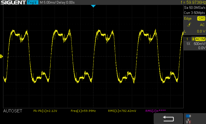

A scope with a grounding wire can pick up noise from the ground wire 'loop', so you may benefit from using a stub type ground clip to measure the voltage across a resistor. A scope also may have a poorer method of measuring rms level. But if your waveform is valid, then there is an issue with either the test setup or with the transformer, as that waveform is not consistent with a typical magnetising current waveform of a power transformer primary winding, where there is no loading on any winding.

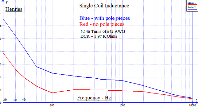

This is a pickup, not a closed core; but the 20-70Hz trend parallels yours. About 3:1 change of L.
If you only have a Fluke 115 then yes any measurements with that will get a bit suspect if voltage is below about 10mV due to accuracy (given you were measuring 23-30mVrms levels), but also would be of concern if the distortion level was substantial, even though the 115 has a frequency range out to 0.5-1kHz.
Your Siglent scope may provide better accuracy if you want to reduce the excitation voltage, but still use an insignificant current sense resistance (10 ohm compared to primary winding ESR of 50 ohm). You could cross-compare at the 240Vpp level with the Fluke.
When presenting results on a forum, many of us happily relate to measurements made using a sinewave for excitation (eg. within a % or 2 of distortion), and at low rms voltage of 5 to 20V, and at a standard mains frequency. That then allows comparison with how other output transformers are typically specified.
That seemingly low test voltage level (5-20Vrms) is also useful for stability assessment for those amplifiers with global feedback - again due to comparison with other amps and their OT's.
The concern is that if results are presented using a very distorted excitation waveform, then there is some doubt as to whether the test setup/measurement has some gremlin in it, or whether there is any useful information in the measurement results (apart from knowing the transformer doesn't have a fault, and has sufficient inductance to keep magnetising current at an acceptable level at the rated mains AC voltage and frequency - ie. the primary purpose of a power transformer).
