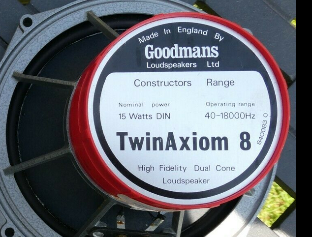

hi - i was thinking of using the above with a small chinese tube amp

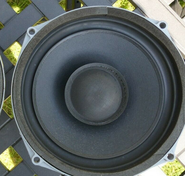

1. its not clear in the info- does the twin have two cones or two drivers- ie coaxial?
if twin cone-what kind of whizzer is that?
2. treble quoted at 18k - but no fr graph is offered- could the treble really be acceptable from an old large driver?
many thanks
The TwinAxiom has a main cone with a concentrically mounted paper whizzer cone, both driven by a common voice coil. It is not a coaxial design.
The treble reaches high, but the high frequency response will not be terribly smooth.
