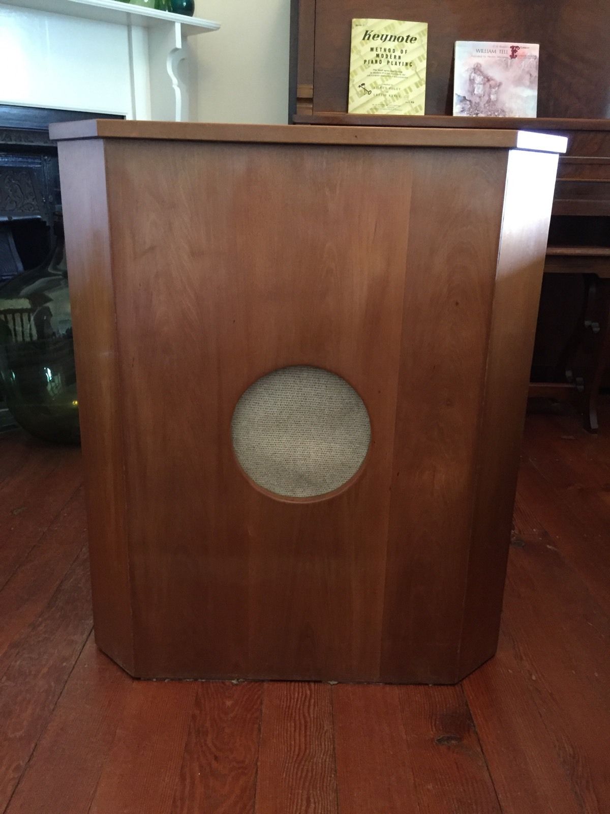

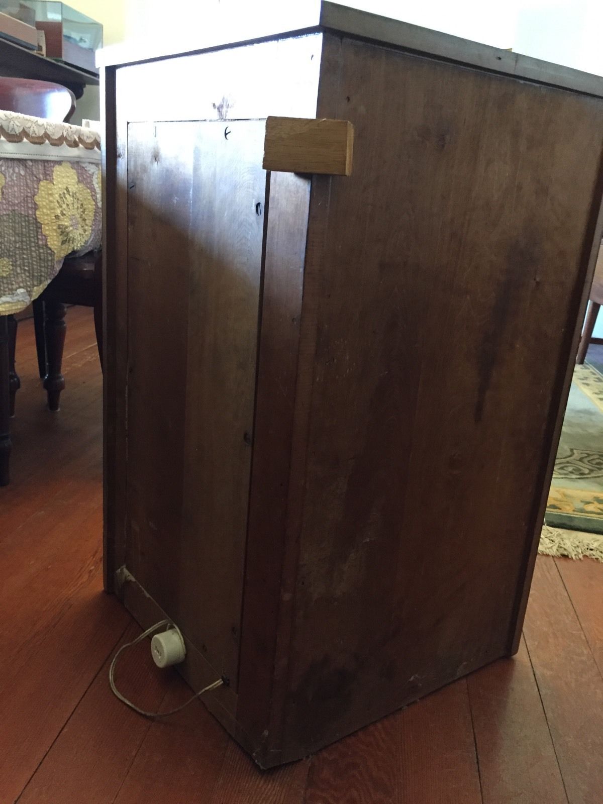

Also the attached an image with the corner cabinet it comes in. Doesn't appear to be to the Goodmans spec. The driver seems quite low, the cabinet is short, and no ARU. Do we think this cabinet might be an issue?

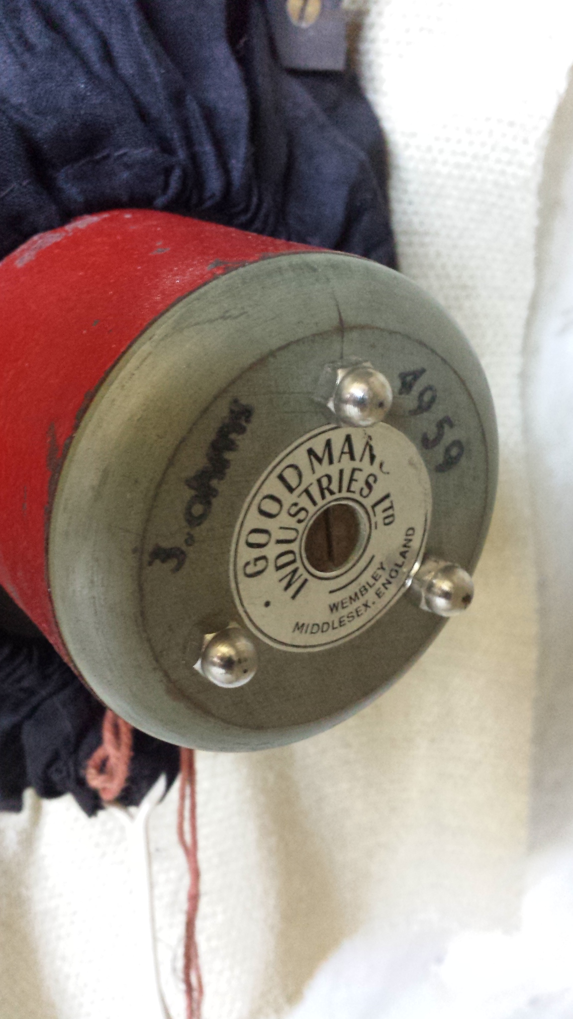

So the Driver in question is actually three Ohms, not fifteen. would be interested if anyone has any info on the three ohm version. It's also the early model which has no Axiom 80 marking on it. thanks.

The first model of this Goodmans speaker was mentioned in a BBC Research Department Report, M008 of Feb. 1948,"The Selection of a Wide-Range Loudspeaker for Monitoring Purposes". It was mentioned as, Goodmans (Infinite Baffle) loudspeaker and described as a twin-cone unit with a free-edged 10'' main cone with a three point suspension. A later Report ,M.008/3, dated Feb. 1952 indentifies a modified version as being the Goodmans"Axiom 10". It is not all that uncommon to find vintage speakers being supplied in an impedance other than their nominal advertised value,as a different voice coil be fitted subject to a special order.
Given that there is a significant air leakage path at the cone periphery any attempt to match an enclosure to this speaker in an effort to optimise the bass response would seem to be an impractical task with or without the T & S parameters.
Thank you VaNarn very interesting comments. I wonder why one would want a lower impedence version, any thoughts? Do you anticipate any advantages or disadvantages of a three ohm version sonically compared to the 15 ohms version? As for your comment on the difficult of improving bass response via the cabinet...I'll take your word on that I'm not even going to pretent I can understand that topic just yet 🙂
Early valve radiograms ,rather than the high fidelity amplifiers in the '50,s ,came with a fixed low impedance O/P transformer and an owner or a manufacturer who wanted a better speaker to hear the improved high frequency performance from LP recordings and FM radio may have wanted the Axiom for just this purpose. A three ohm voice coil wound to the same winding height will have a lower Bl factor and this will effect other parameters to a small degree.The only precaution would be if the speaker is to be used with a solid state amplifier and this can involve excessive power that may exceed the speakers power handling ability. The cantilever suspension is a delicate arrangement and the attachment points to the cone are prone to fatigue. There are speaker technicians that can fit a 15 ohm voice coil if you need the Axiom to comply with the original specifications. Bass response and power handling have been the Achilles' Heel with this speaker and the manufacturers solution rested on using them in multiples. Cabinet designs were supplied that used up to four speakers per enclosure. Construction wise it is a fascinating speaker on looks alone.

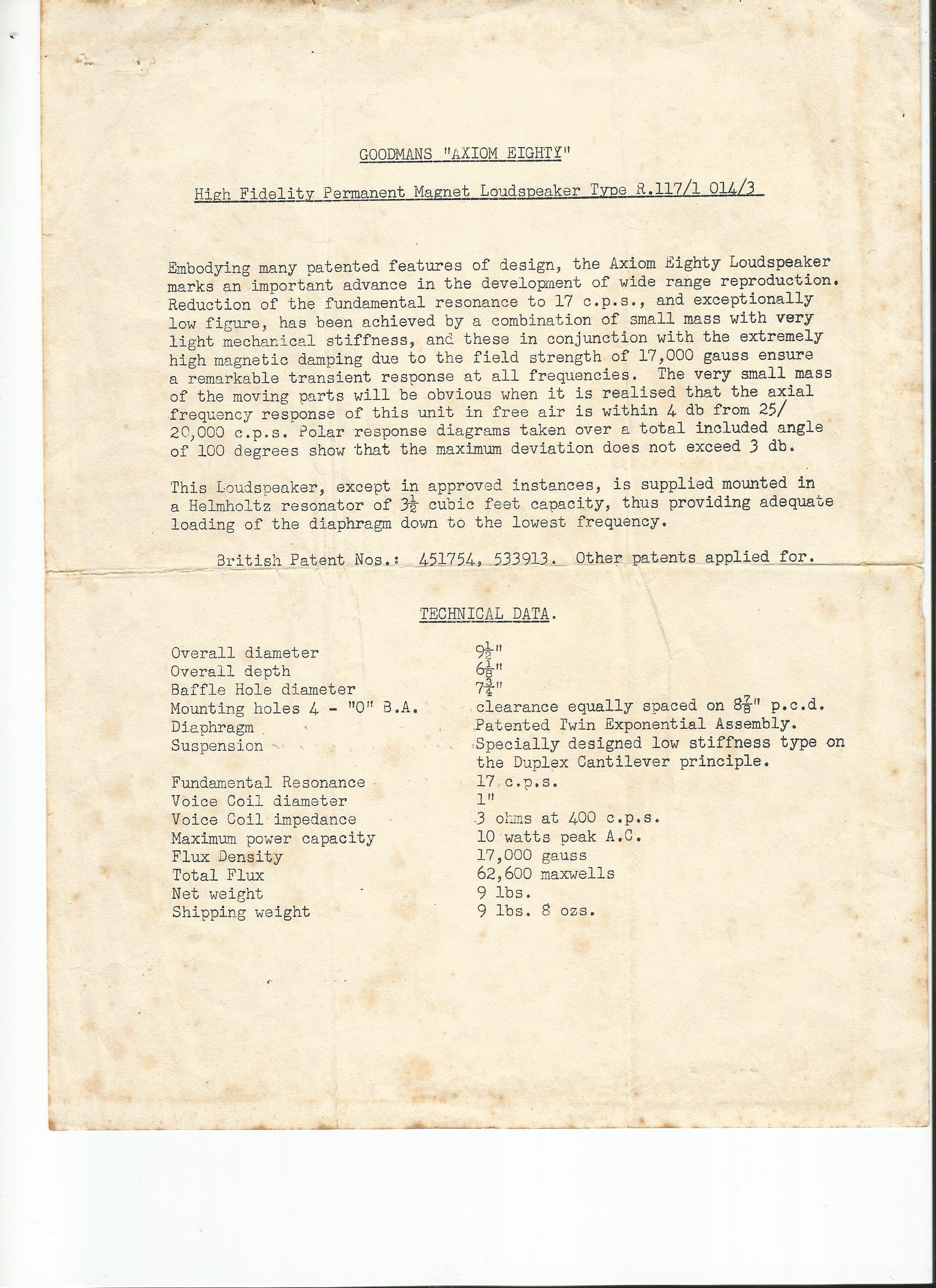

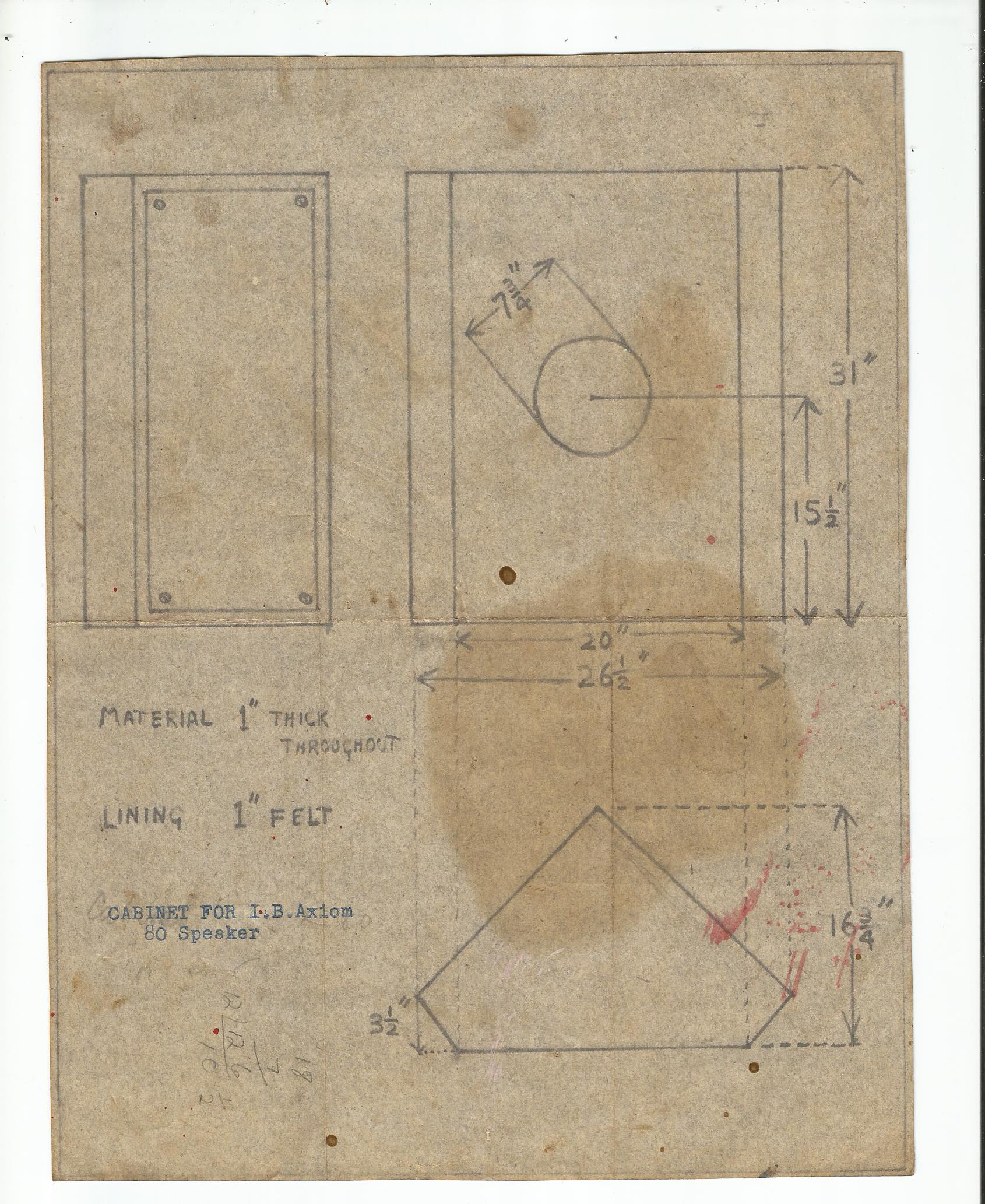

So I picked up this speaker this evening. Also had some original documents that came with it for those interested. See attached Technical Data for the Driver and a sketch of the cabinet. Very lucky to have these documents! I'e been enjoying listening to is propped up in the corner. It's very nice indeed.
So the Mystery is solved it is an Axiom 80 Type R.117/1 014/3
Overall diameter: 9 1/2"
Overall depth: 6 1/8"
Baffle Hole diameter: 7 3/4"
Mounting Holes: 4 - "O" B.A. Clearance equally spaced on 8 7/8" p.c.d
Diaphram: Patented Twin Exponential Assembly
Suspension: Specially designed low stiffness type on the Duplex cantilever principle.
Fundamental Resonance: 17 c.p.s
Voice Coil Diameter: 1"
Voice Coil Impedance 3 Ohms at 400 c.p.s
Maximum power capacity: 10 Watts peak A.C.
Flux Density: 17,000 gauss
Total Flux: 62,600 maxwells
Net Weight: 9lbs
Shipping weight: 9lbs. 8 ozs,

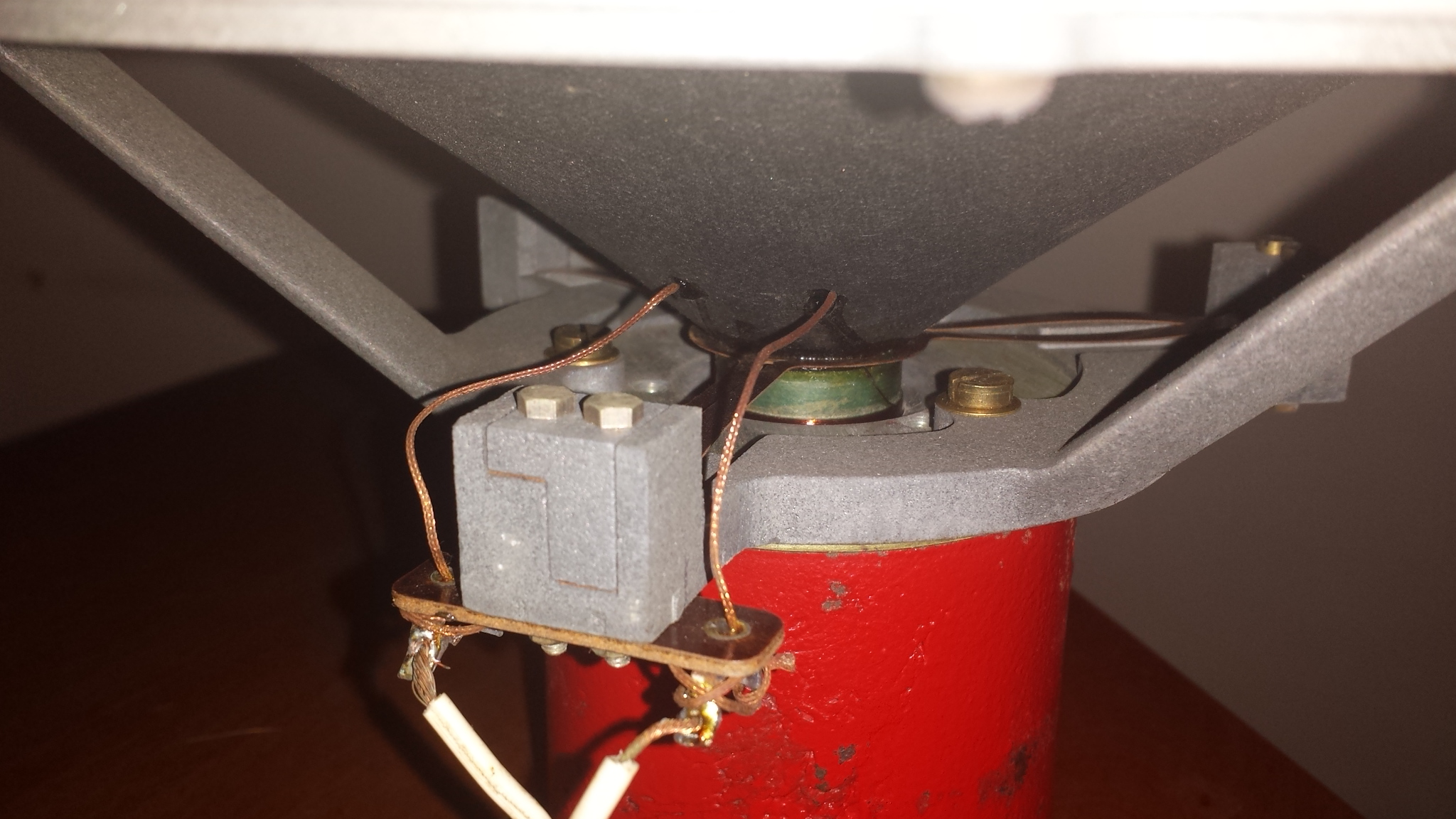

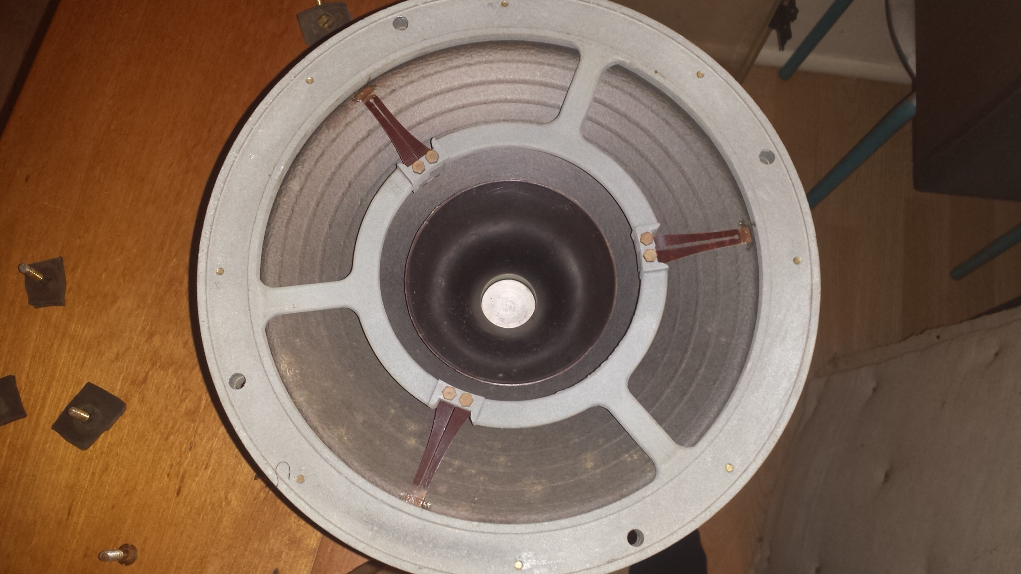

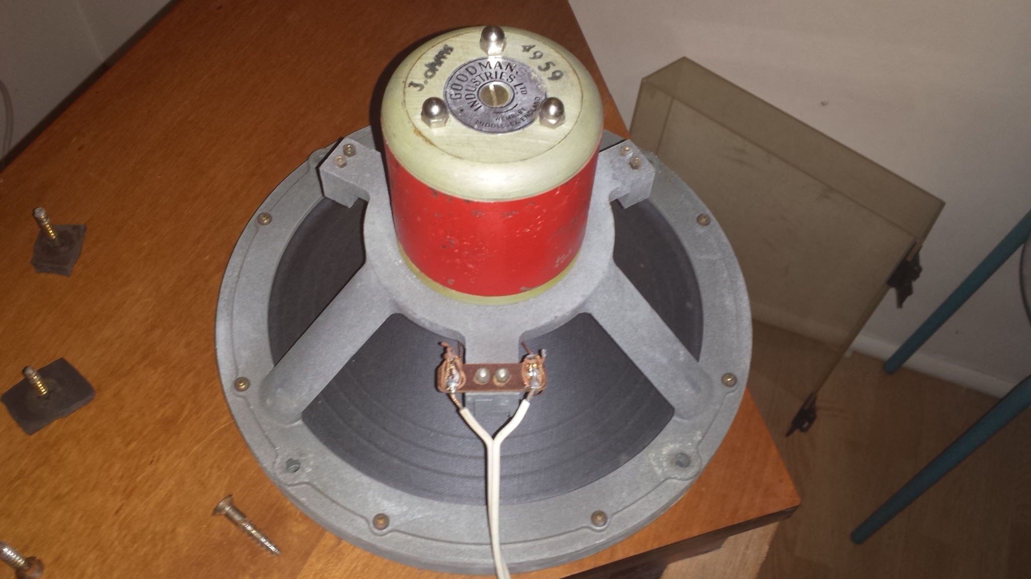

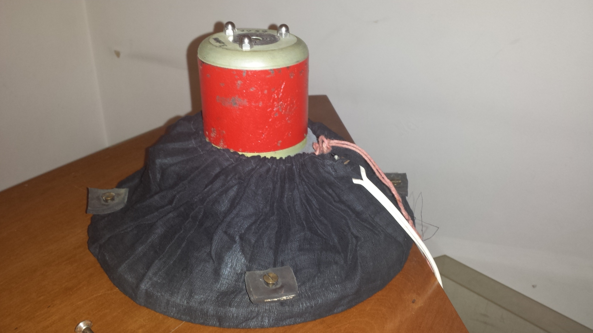

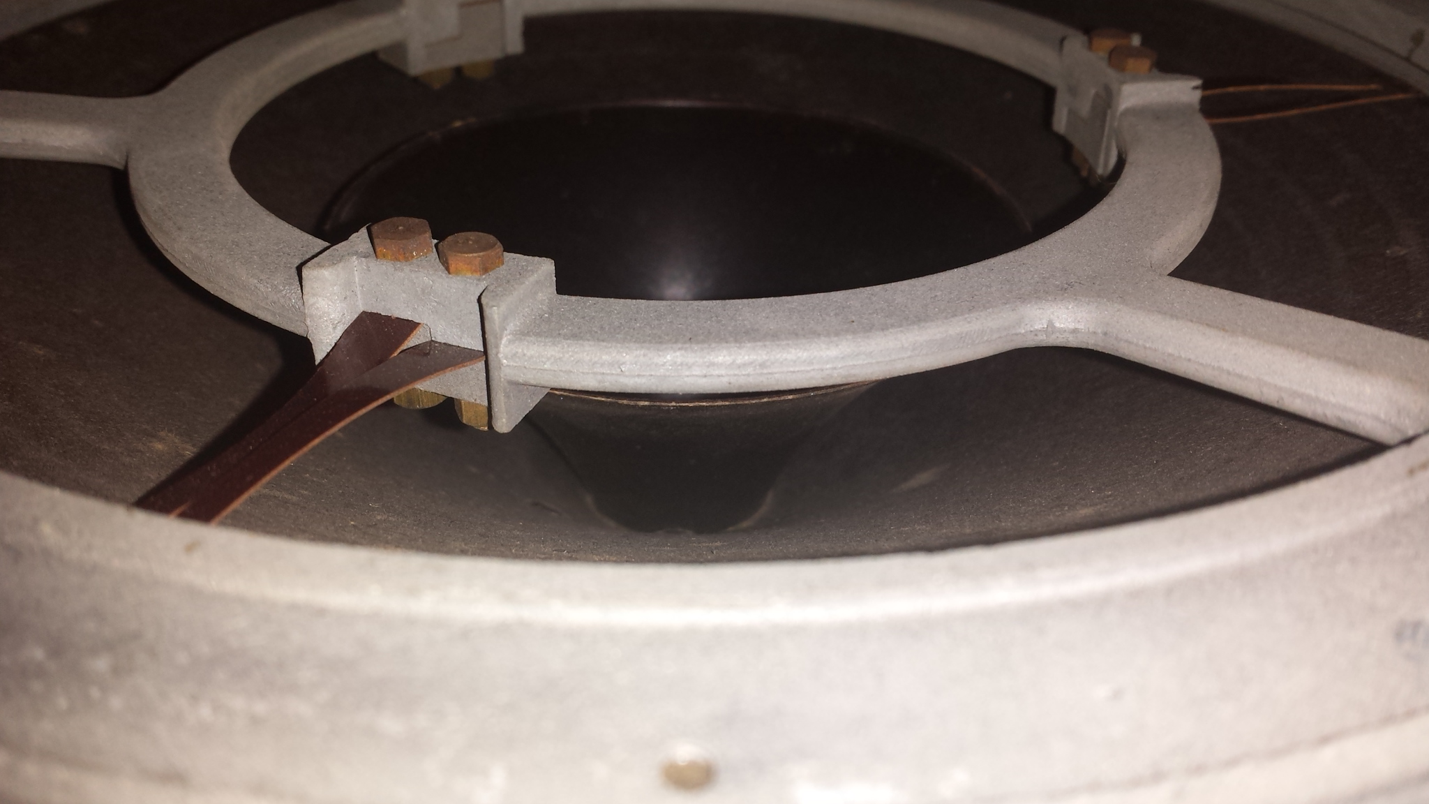

Took off the driver for a closer look this evening. It loos good. Cantilevers still attached, main cone good, whizzer cone good without coating chipped off as ive seen on others. Suprised how little the cantilvers move when playing.

If that speaker is what I think it is, I've seen some bring several thousand for a pair. the units to which I am referring have a center ring with 3 spokes attached which go to the outer frame. That smaller ring houses the diffuser cone or horn. Alsio attached to the outside of the smaller ring are 3 pairs of p0henolic strips which is the annulus for the larger 8 inch cone. The spider, if I recall, is similarly affixed.
As for the 3 ohms, that may be the dc resistance of the voice coil. With the suspension described as above, the nominal impedance will be much higher, probably around 6 to 8 ohms. Typically, such vintage Goodman's and Wharfedales were around 10 to 15 ohms.

Thanks Robert yep I sure did get it. Tajnsk for your excitememt ha. I've been enjoying listening to it very much. It actually lives up to the hype im my opinon. The only downside being the 3 ohms thing as thats very unusual ie ive never seen another one. So I'll only ever be able to listen in mono, but thays ok.
