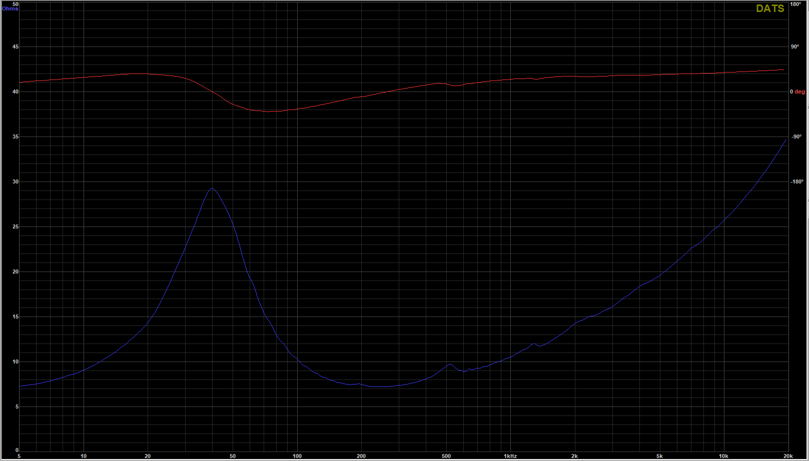

Ok, so I got a Dayton DATS.
First driver measurements (I'm re-glueing the second, more measurements later on for consistency).
Now I need to find a big room for frequency response measurements.

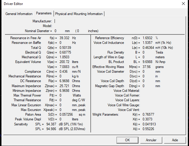

Driver 2:
fs: 39,3 hz
Qts: 0,50139
Qes: 0,68775
Qms: 1,8503
Vas: 201 l
Re: 6,9698
sensitivity: 94,4 dB/W
Le: 1,5357 mH
BL: 9,7 N/A
Mms: 37,56 gr
Putting them in winisd gives very different optimal boxes...
