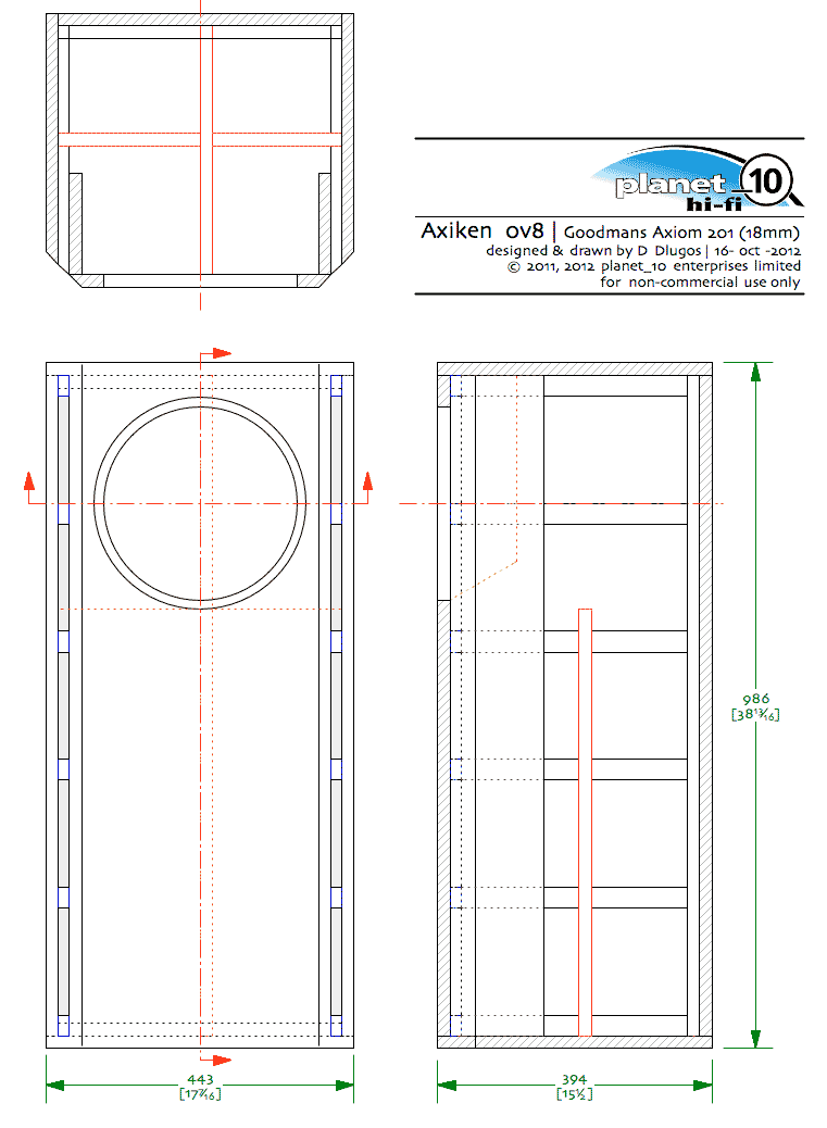

My latest project is a pair of Goodmans Axiom 201 drivers:

Currently they are in a ~80Litre ported cabinet, which is OK, well built but the bass can be a little slow and lumpy although not that bad to be honest.
I currently have them open backed which seems to improve the bass, with not a massive reduction on bass depth. (and pulled out a bit compared to the photo above).
I dont really want such a large speaker so far out into the room, so shying away from the OB idea.
I am using a pair of Fountek JP2 ribbons crossed at ~7.5kHz/2nd order for the moment which work well, maybe need knocking down a notch in SPL though.
I have searched and found plenty of references to the 201, and lots of information and T/S parameters for the 301/401 and Axiom 80 drivers but none for the 201.
All I have found is that they have a highish Qts ~0.7 and 96dB/16Ohms
I have seen the recommended Goodmans cabinets mentioned/detailed online but thought there may be some better designs out there.
Ideally I would like an enclosure that will have tighter bass than the current one, and work up next to the rear wall.
I have seen what looks like an Onken enclosure used for a few pairs, although they might be 301 or 401 which I believe have a much lower QTS.

Try making an eclosure higher, narrower but not deeper. I'd just try to keep the same baffle area and volume.
Personally I've got recommended enclosure fitted with triaxioms 1220c without trebax units. trebaxes are replaced with fountek neo cd3.5H crossed at 10kHz with 1st order. ribbons are mounted just under triaxioms. port flow didn't suffer.
If you don't have a good design for them I'd recommend those boxes provided by goodmans in their catalogue.
Bass is really satisfying, tight and fast. In 25m2 room I don't push them with more than 1W of power from ECL86 SE amp 😉
Heard 301s in enclosures which were without air resistant units and they were high, tight and not too deep, but their volume was like 190-200l, just like in recommended ones. Personally I found those better sounding than those I own.

These haven't been built yet, but the same fellow gotmeto docabs for the new Diatone P810 MkII
dave

Look what I've been able to finally make a start on 🙂
These will be painted white, I have some very nice ply (13-layer 18mm) but it is dark varnished on one side and primed on another. The backs will be removable. If I need helper tweeters I will make some pods to sit on top.

Here are my Axi-Kens at the Scalford hi-fi show on Sunday in the UK, a hi-fi show where people take their own systems. I was in a room approx 13ft x 13ft, and was swapping between my FrugalHorn XL's and the Axi-Kens. The Goodmans drivers had been unused for many years and went from sounding "good" in the morning to astounding in the afternoon, I really am pleased with them. The bass has no overhang whatsoever, very impressive for a large driver. The Monacor ribbons come in at around 12Khz for a little bit of air, for some music they aren't really needed. I had plenty of good comments about both speakers, so thank you Dave 🙂
One chap had some unused 201's at home and couldn't believe how good mine sounded, he was interested in getting the plans so I will point him in this direction.
