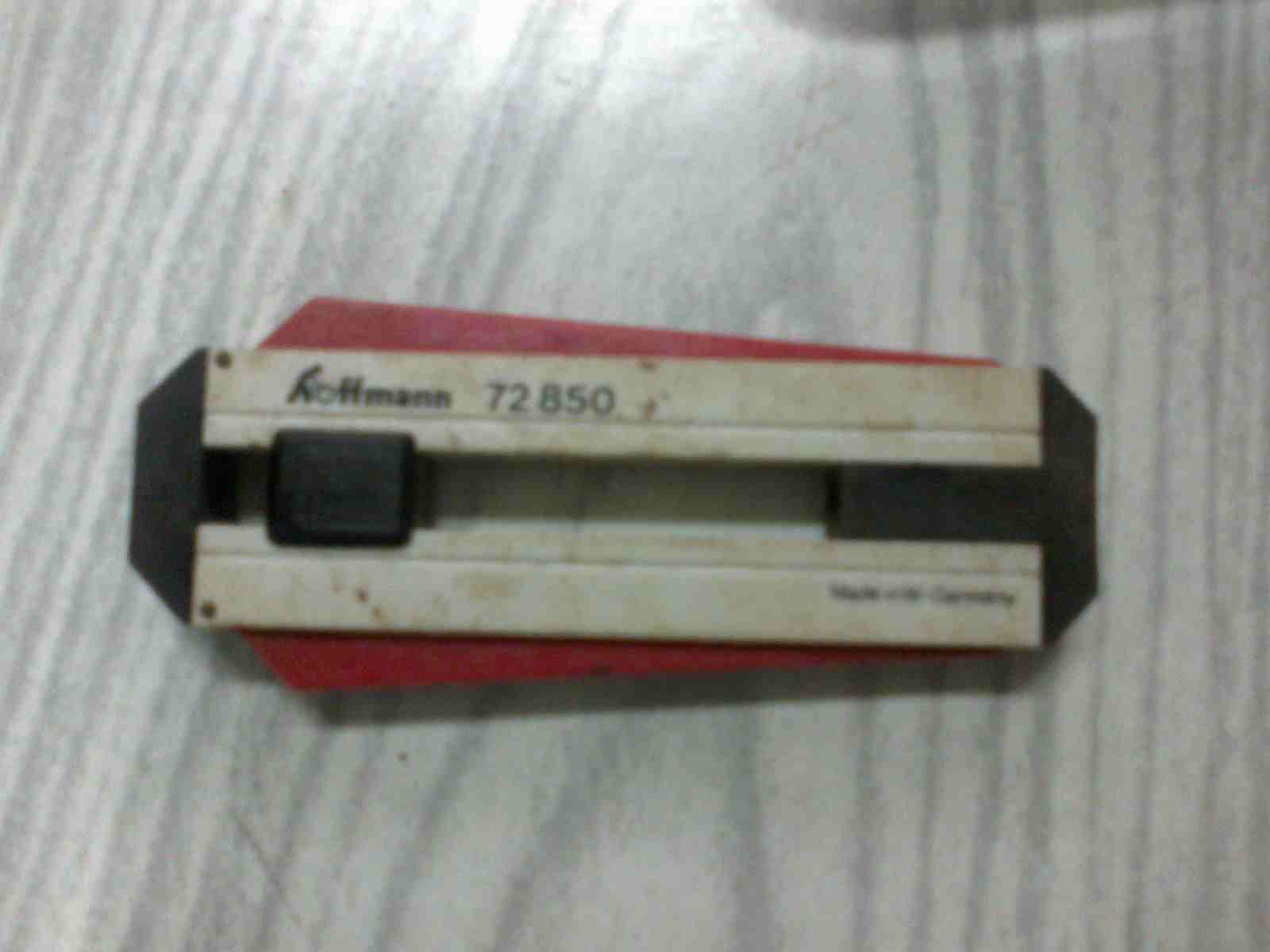

This is what I use:
Works great, just need to be careful so the cut is not too deep.
