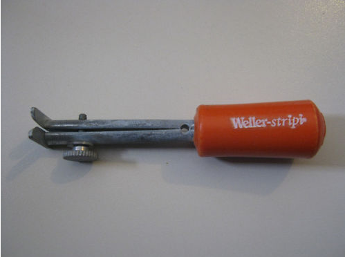

is there a good tool to strip small hookup wire?, these things are not solid but stranded also and having lots of problems, Please recommend a tool to help this newbie.

A Weller Stripi... i can take a picture, they are supposedly hard to find (Allen Wright gifted me mine)

I've been using Ideal Stripmasters since the wire shop at my last Navy command introduced me to them. They are a bit pricey but an individual hobbyist user should get a couple of lifetimes of use out of them. Random ebay auction to illustrate the type:

The T-7 type tool will work I guess, but it is not very precise... although I suppose someone could be making one with tight tolerances...
The other one, the "Stripmaster" is made by a great many manufacturers over the years and even today, the better ones are very very good and precise. Worth having if you want a quality tool and intend to strip a fair amount of wire.
You can use a sharp razor blade and gently roll the wire or the blade over the wire, not nicking the copper and strip thin wire that way... a little practice scoring the insulation and you can do it very quickly and well.
The best stripper I own is an unknown mfr, but a hand held gun thing with rotary blades. Wish I could buy a few more of them... it is perfect every time and works on teflon wire, which most other strippers have a hard time with... never seen another one like it!

About 45 years ago I found that my thumbnail and index finger make a really good stripper for #24 or #26 wire. I developed the technique while working in the telco industry with its millions of miles of #24 solid wire.
Keep your thumbnail shorter than the end of your finger, but just long enough that if you dig it into your index finger hard it still hurts.
Note that this technique doesn't work well on teflon wire or magnet wire. You will injure yourself before you manage to scrape that stuff off a wire.

Two tricks I've seen for teflon, a heat stripper, and the opposite. Dip the wire in LN2 and crack off the insulation, cryo's the end at the same time. 😀
My favorite wire strippers have always been the Clauss Cutlery No-Nik line. Unfortunately, it seems they have stopped making them.
For 26 gauge stranded, you'd want either the NN.021 or NN.023.

Best thing for doing that are these guys:
I just let out about an inch of blade, hold it in my right hand with the blade facing upward, place the wire on it at the point I want to strip it, and then using my left hand and my right thumb to guide it, roll the wire over the blade.

All we do is argue. Ripley (Miller brand) is the current vendor of the formerly Clauss No-Nik wire strippers. They are still the best.
