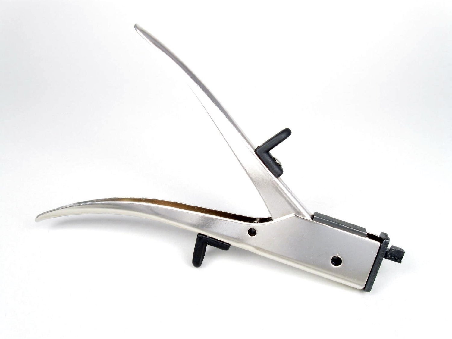

I use a hand nibbler.
Drill a small starting hole and insert the tool and cut.
Cuts straight and looks good.
S.Chandrasekar

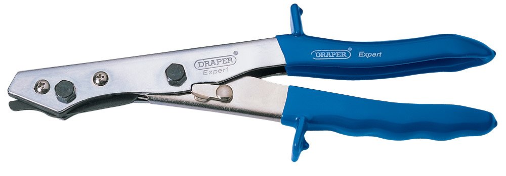

Trouble is, the OP seems to want a slot that is about 1/8" wide, and the nibblers like the one you pictured that I've seen cut slots that are more like 1/4" wide.
However this one cuts a far narrower slot:
Draper Nibbler
or:
http://www.ebay.com/itm/Sheet-Metal-Nibbler-Steel-Cutter-Hand-Nibbler-Shear-AT249-/400720113323?hash=item5d4cc7aeab:g:vkIAAOSwFnFV~SS2
