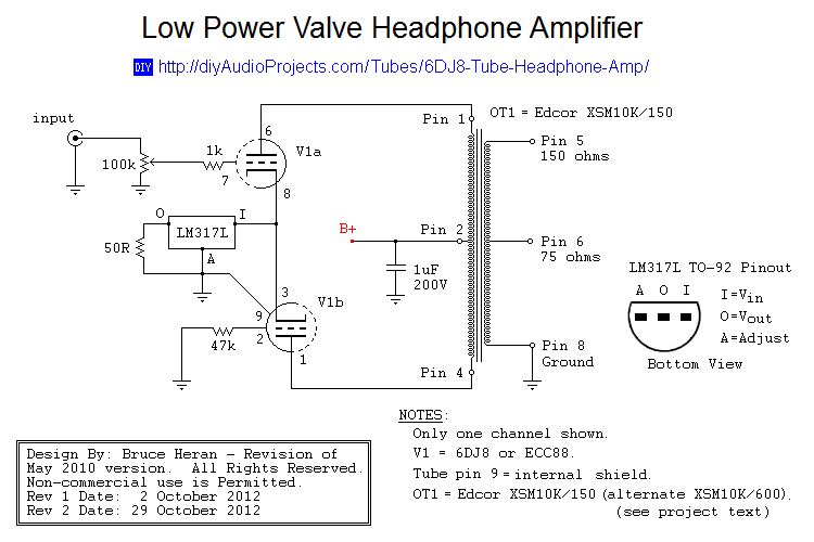

If you're not planning for OTL, ECC88/6DJ8 is a pretty good option;
I've built both single ended and push pull headphone amps with this tube and both sounded great. My favorite headphones amp is this one from Bruce Heran:
https://diyaudioprojects.com/Tubes/6DJ8-Tube-Headphone-Amp/

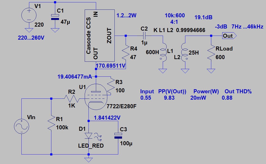

Thank you, did you do the simulation yourself? And it is only for one channel, yes?If you have -good- 10k:600 (4:1) transformer, trioded E280F or E810F with constant current anode load, parafeed to OPT would be enough good.
Sample simulation:
The power supply can be simple, the cascode CCS has enough large PSRR.
The transformer is something like this https://www.audiophonics.fr/en/audio-transformer/ds2206-audio-transformer-60010k-unit-p-14325.html ?
In the simulation the AC and circuit seems to use the same ground, is that really right?

This is a popular design that uses this transformer with a 6DJ8 twin triode and an approximately 135V DC power supply.
I'm not saying this is the very best design of its type, but I believe it's a good starting point. Very few parts, easy to build.
There are ways to improve this design, if you want to get more involved with it...

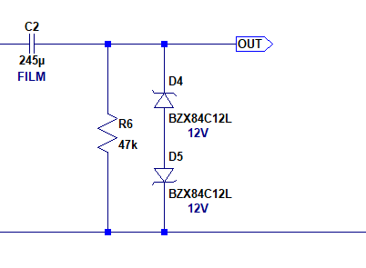

@OldHector
From the always-helpful Merlinb:
- You can take two zener diodes and wire them in series and with opposite polarity from the amplifier output to signal ground. This will clamp large voltage transients down to the value of the zeners.
- If you need the amplifier to deliver 4V peak signal to the headphones, choose something like 6.2V zener diodes. The idea is to not allow the signal voltage to get prematurely clipped by the zeners.
Something like this:
12V zeners are pictured, but that's not meant to suggest that's the 'best' value for any particular situation...
In testing, Merlinb saw that the zeners did not measurably affect the output signal, as long as the signal voltage stayed below the voltage rating of the zener diodes.
The above was taken lock, stock and barrel from Merlin's book Designing High Fidelity Tube Preamps.
