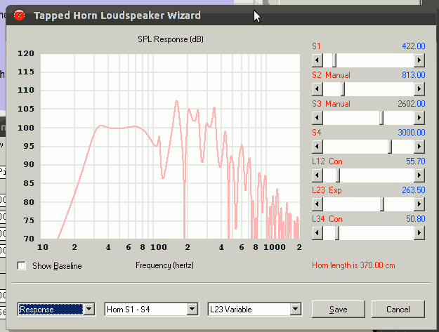

I just started playing with hornresp for the first time last night... Came up with this for that 21" RCF driver:
Kind of narrow banded as it rolls off above 80hz and below 30hz. That is actually a "half-space" response there, in free space it drops like 6DB. Max SPL is ~125db from 30-80hz when factoring Pe and Xmax.
Box size would be about 2' x 2' x 6.5' ft if i figured that out right, or roughly 24ft^3 internal volume.
Problem I see with this, is that, you can slap the same driver in a 10ft^3 reflex and get the exact same maximum SPL out of it across a wider frequency range. I'm having a hard time seeing the benifit to this horn loading, seems like it requires enormous boxes and delivers very little in return.
not to bad for first sim😀
if you shorten L1-L2 and L4-L5 to 30 or so cm the dip wil be less in the upper pasband.
its looks a bit as olsound rcf sub,but area 2 starts bigger,giving a wider pasband.
also a th can be 6 db more efficient ,compared to br at the cost of a bigger box.(simply said)
personaly i prefer the sound of th's over br.
In sim or in execution? What about vent compression? thermal compression?
Hello epa,
Thank you for the complements and info! I'll have to keep playing with the program and more drivers. Maybe I'll "see the light" at some point 🙂
Hi RockLeeEV,
Please, just share your mind. You know I haven't miced a comparison if my first horn sim was last night.
I saw 2 sims, with basically identical efficiency, max power handling, max output, and bottom extention. One took 24ft^3 to do it, the other took 10ft^3 to do it. They are both susceptible to the same thermal compression if it requires the same power to achieve the same output. Vent compression is overcome by designing the vents large enough in the first place from my understanding.
Eric
IT just doesn't sound right. Your compression or expansion ratios must be wrong. A horn will generally give a very notable boost in efficiency. I suspect you just modelled a 6th order band pass thinking it was a tapped horn.
