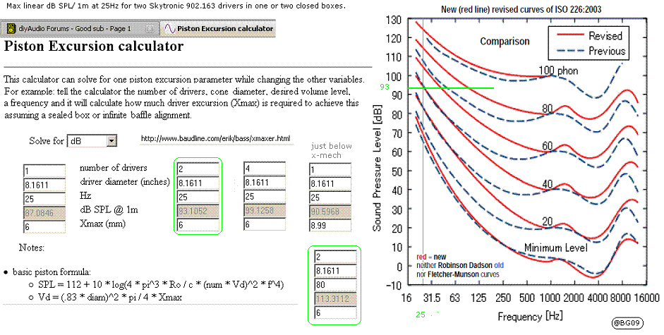

Hi kipman,
In the mid bass at 80 Hz you'll get about 113 dB max. but not at 25 Hz. I vote for the use of 3 or 4 closed boxes. See picture 1(1)

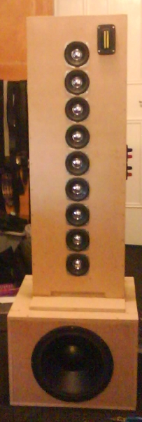

Problem is the entire sound system has to fit in the car along with everything else for a year at uni so unless I build the stuff down in London I am very restricted for space. I already have two 0.89m x 0.3m x 0.3m open baffles to take. 93dB is quite low I could use a triode (or simlar solid state circuit) to soft clip any transiants that would cause damage to the sub?
Hi kipman
I wouldn't worry.In my listening room things starts already to rattle around 90 dB SPL for frequency's below about 30 Hz.
Two of your sub drivers will produce above 102 dB at 42 Hz where the mid-bass octave ends and for listening music at this possible level is IMO loud enough.
I don't think you should include any transient protection for over excursion, its quite adequate if your sub amp is equipped with a 12 dB HP filter at about 20 Hz even if you are using a LT circuit too.

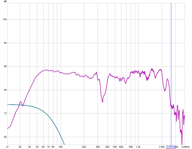

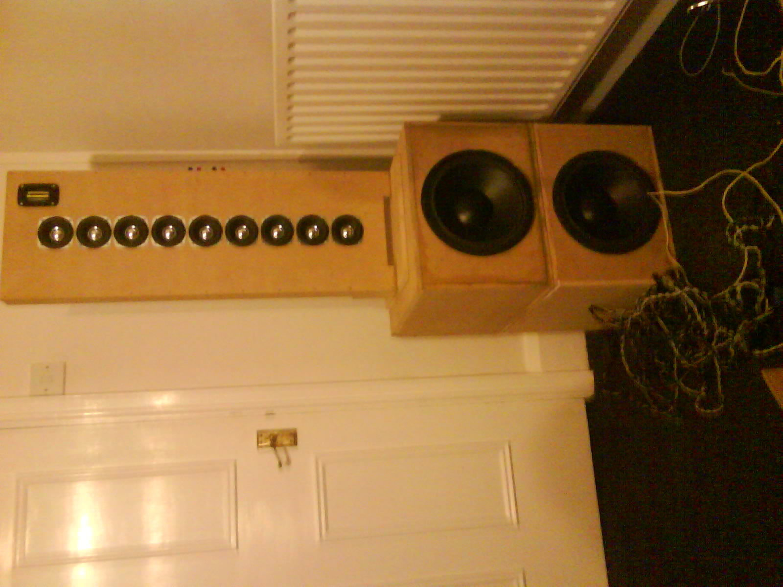

well I now have one of the subs built in a 400x410x300mm box constructed out of MDF and even from a 30W amp and without equalisation, stuffing or even proper box seal this thing is monsterous. Will get it stuffed and sealed tonight and hopefully get some mesurments in.
