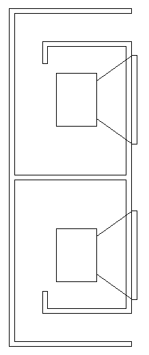

well, for one thing, if this is how you build it, it's vented, not ported.
Secondly, it's a wonderful design. It's got the same advantages of porting, but it doesn't get port noise as easily.
You can use Speaker Workshop to model this box if you just model half of it. I'd recommend making these your bass speakers (I assume this is for PA or other large-scale use; this is definitely bigger than typical listening-room fare 😀 ) and make the 8" mids and tweeters be in a separate box.

ported? vented? hmm... lol nah, this is for in house... don't wanna spend anymore money on small speakers.. lol actually.. I wanna start saving for these now... the idea is 2 15inch Brahmas per box... 1000watts to each Brahma.... but anyway... lol
get winisd pro/or other program like sub sim and model it,
unless you want large amps $$$$$ get something efficient
im estimating those boxes could be 180L each??
but since theyre brahmas,perhaps smaller box im not sure of their T/S specs.
2x1000watt amp? if u want!
if so a labhorn <or similar> would almost be worth it for 100db+/1watt,get more spl,less harmonics,better transients....

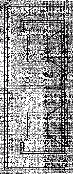

oh if u want to post larger pictures,, go to www.download.com search for 'irfanview' its a free program that can convert to all sorts of pics jpgs at high or lo quality

Each "box" (devision of the box) was going to be 200litres... the port volume alone would be about 50litres.... these are towers.... there would be 2 of them... so, two 1000watt 2 channel amps.. lol 3 phase power.. something like that... Hmm... I was really looking for a fairly high powered, LARGE woofer... soemthing like 21 - 24inch... with a relitivly high excursion... but wish me luck finding then in Australia...
All I had at the time of going that pic was Paint.. 🙂 I now have installed PhotoImpact, so I can resize and save in different formats now.. 🙂
your plans-$$$$
one labsub is about 600L anyway.
large woofer like 21inch = usualy compromised CRAP specs! such as-
audiobahn 34inch
Qts=0.96 Fs=13hz vas=700l or somthing 89db/1watt HAHAhaha ,5kw rms
fancy a HUGE box for crap sound?
3000$ US for a crap high q woofer..
i definately would go for either a nice 15 or, labsub.i cant fit a basshorn or else id either build labsub,order lab12 woofers from US or fit my own nautilus shell design
because amps are so expensive here : jaycar 350watt expensive price not wholesale amp+shipping of about 50$,
= i cant get the output i want with anything less than 94db/1watt or so..

Nappylady said:well, for one thing, if this is how you build it, it's vented, not ported.
The terms vented & ported are interchangable and usually refer to a bass-reflex design. I say usually because we also now talk about ports (or vents) in ML-TLs & ML-TQWTs, and the term can be used in the context of aperiodic designs where the vent (or port) is damped.
