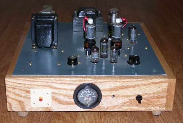

I got this one from Fair Radio: NOS, 0 -- 100uA, totally unused (still had the protective jumper installed). Looks like a 1940s, aviation meter.
I installed this meter since this project uses fixed bias on the finals, and it's most helpful for bias current balance. I used 10R current sense resistors in the cathode lead. I rigged up a 100mA CCS to calibrate the sense resistors. Put a 100K pot in series with the meter and adjusted for full deflection. Measured series resistance, and it came to ~7.0K. Connecting two 12K metal films in parallel with a 1.0K in series came to within a couple of ohms of the required series resistor, so the meter reads accurately, and not just a balance indicator.
