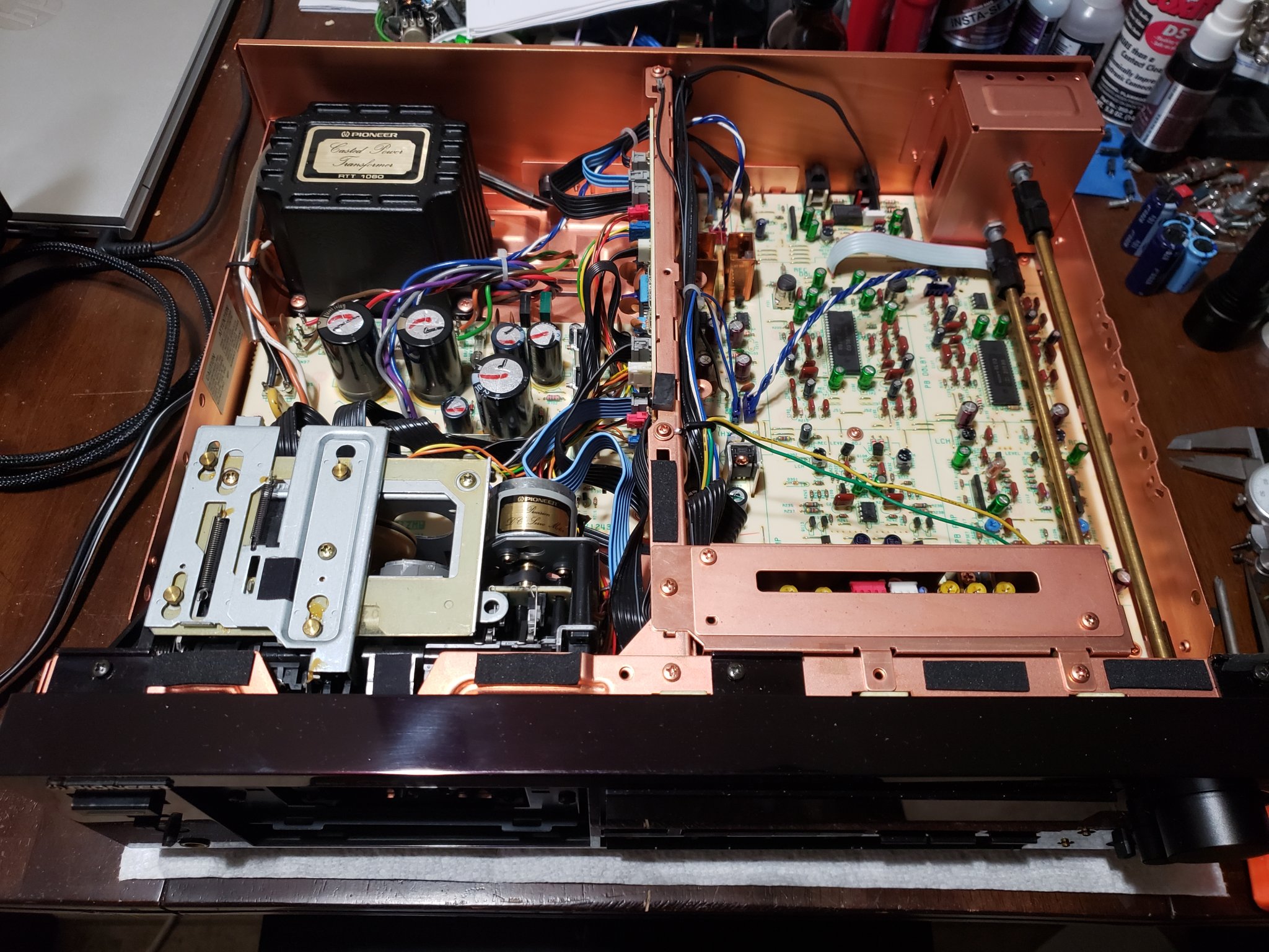

I ended up buying a set of belts from a Portuguese company on Ebay named webspareparts. The belts appear top quality, very close to the originals. The belt material feels just like oem and the fit is spot on.
The old belts turned into black goo, stuck to the capstan pulleys and transport mode drive.
It took a long time to get rid of all the residue and required acetone to fully clean up. This was by far the most labor intensive job I've done to a cassette deck.
Now I have to reduce the reel motor torque a little. The current amount of torque the reel drive exerts on the tape is too high IMO. It maxes out my test tape at 100g and should be in the 40 to 60g range for playback. There is no adjustment for takeup reel torque, but I can reduce the reference zener voltage on the drive circuit to reduce torque.
I'd rate this deck right behind the Yamaha K1020 I use for transfers of old material, but its not that far off in terms of SQ. A DBX encoded recording sounds almost as good as 7.5 ips on my open reel Tascam 22-4. Certainly a bit better than an average MP3.
For those interested, I installed a 3.3 ohm 1/2w resistor in line with the reel motor. This dropped the take-up torque in play mode to 50 gm and wind torque to 85 gm. Both are in spec now to avoid stretching 90 min tapes. Not sure why they thought it wasn't too much torque before. That just stresses your precious tapes unnecessarily.
