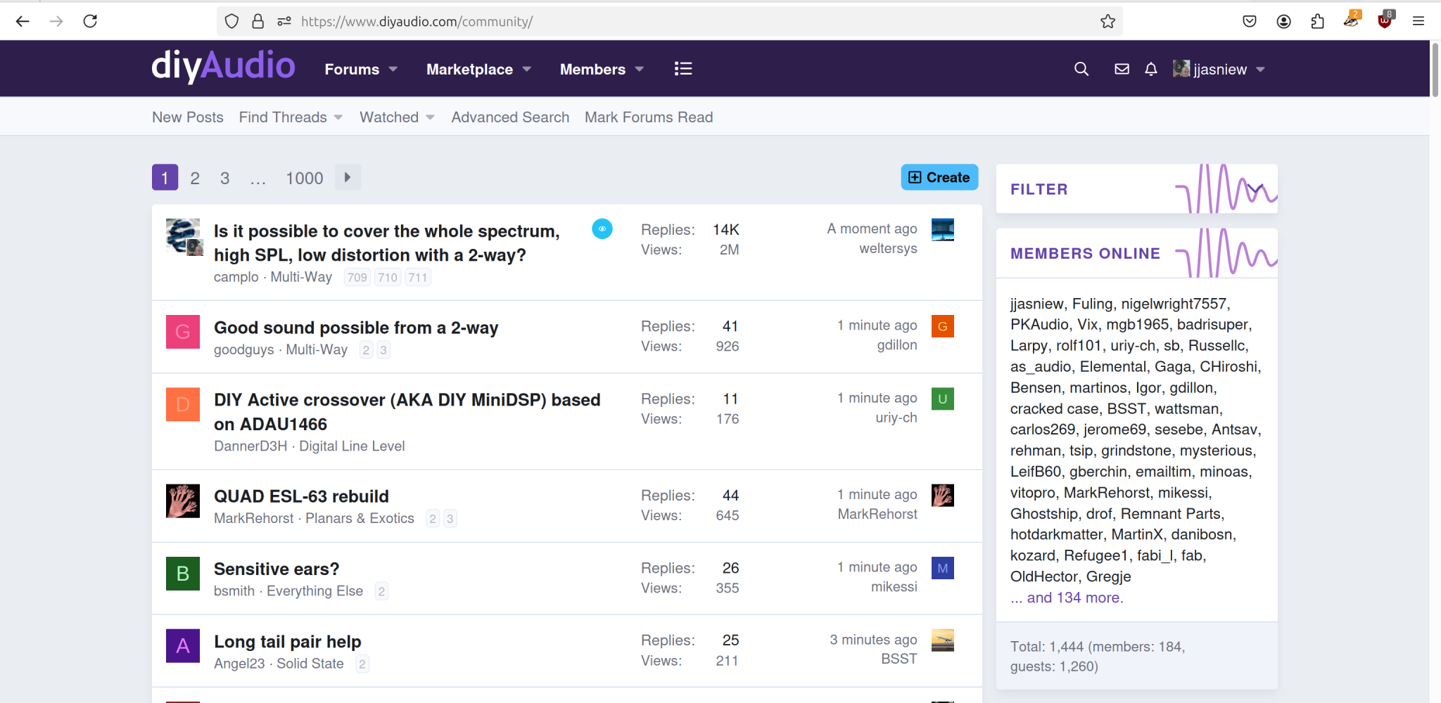

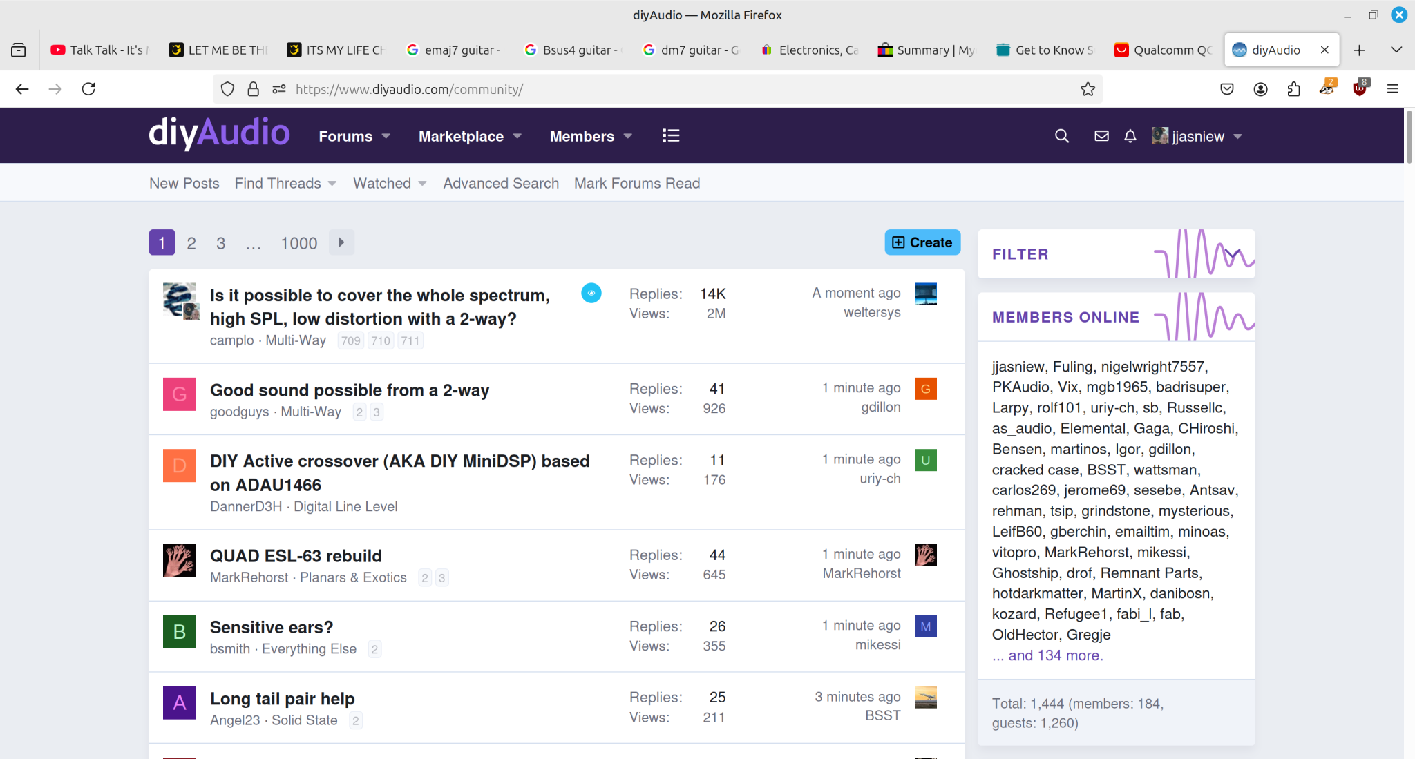

Difference "good sound" and "whole spectrum, high SPL, low distortion". Maybe the answer lies somewhere in the 14k replies...
