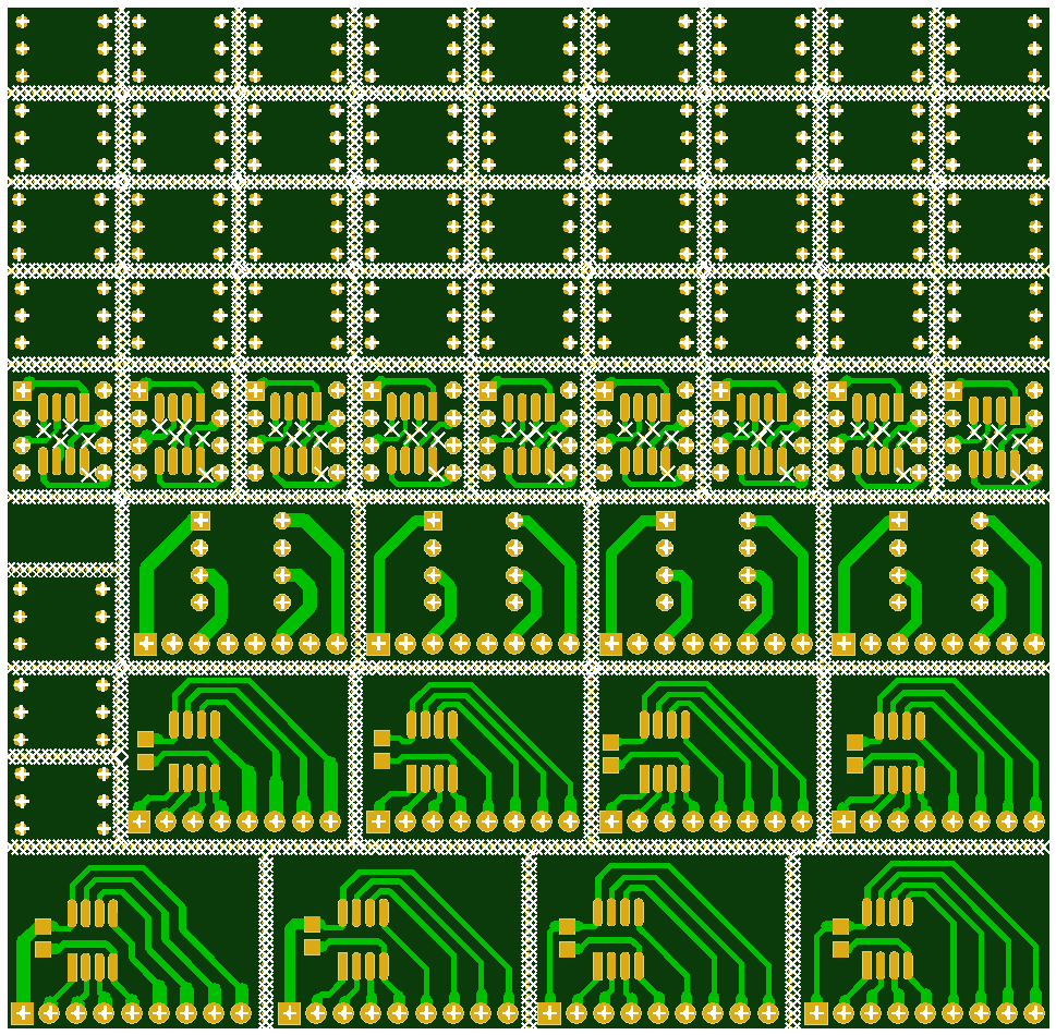

I designed a soic-8 to SIP-9 adapter with decoupling cap across the supplies for this purpose.
