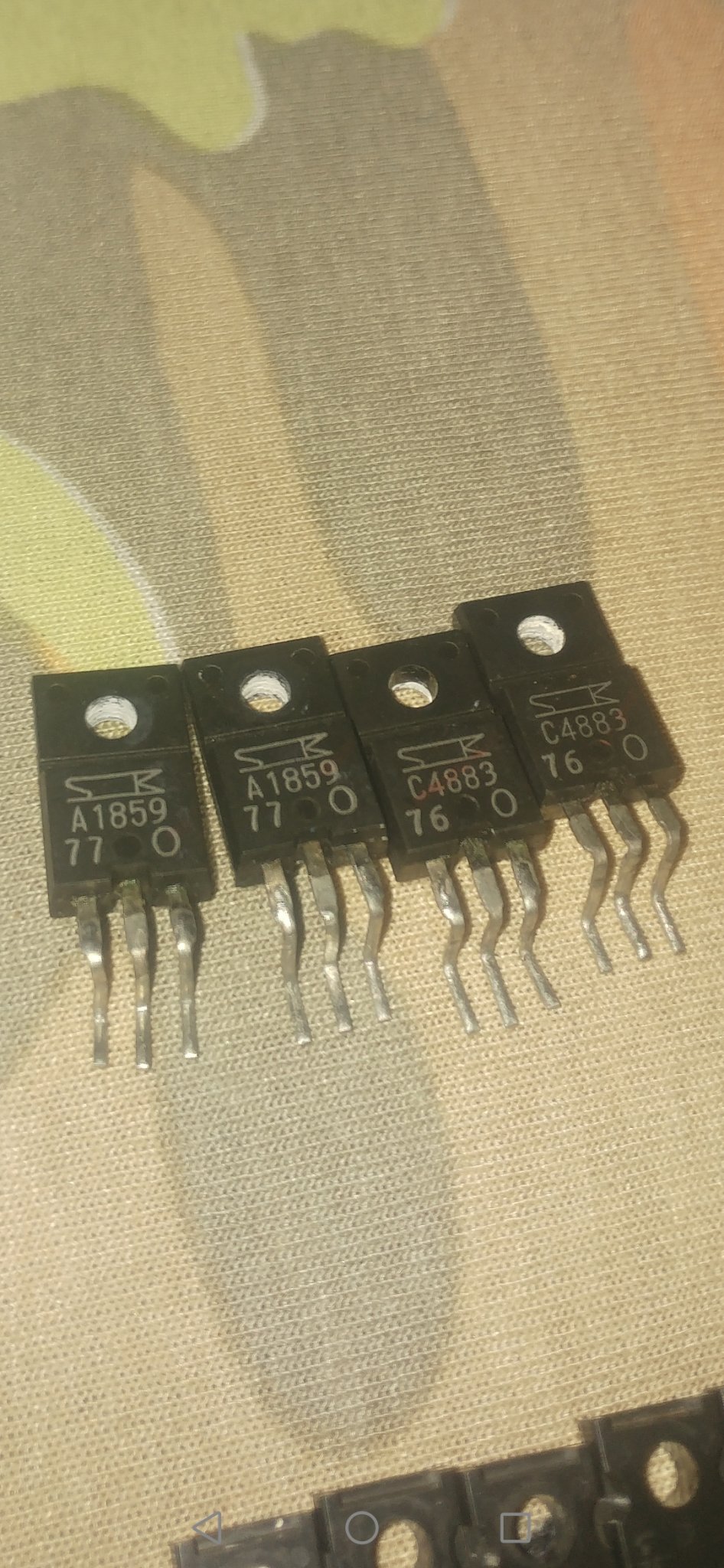

I'm in the process of re-designing a amplifier output stage from EOL Sanken 2SC4883/2SA1859 + 2SC6145/2SA2223 transistors to KSC3503/KSA1381 + Exicon Lateral Mosfets.
People should be aware of building a slewmaster arc welder amplifier as it uses these Sanken EOL transistors.
Two Channel audio amplifiers are a product of a bygone era, multi channel home theatre amplifiers have taken their place.
As diy'ers we're living on borrowed time, down to a literal handful of suitable transistors.

- Good Sanken 2SA1859 & 2SC4883 NOW EOL
