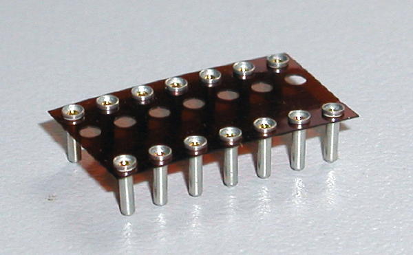

Great, I'll use a socket. I cannot see that part number on their website, or on Farnell's. But I think I know roughly what I'm looking for... something like this?Gaucho said:I believe there are some varying opinions about this but the op-amps that I've tried I have heard little difference when socketed compared to soldered. Use a good quality dual leaf socket like Aries Electronics part no. C9108.
That would probably be fine, I haven't used a turned pin style socket though.
The C9108 is avaliable from DigiKey.
http://ca.digikey.com/scripts/DkSearch/dksus.dll?KeywordSearch
Ahh, I see the part you suggested now. Fairly pricey...
I have also used the cheaper dual leaf AMP/Tyco 2-641296-2 (DigiKey part no. A24794) and it sounds fine to my ears.

Peter, where are you sourcing those beautiful sockets from?
Gaucho,
I'm getting them from a local surplus store: Sayal. I believe they also have a website. If you need some of them, contact me through e-mail and I will send you a couple. To me, those are as invisible as socket can be, and Madrigal is using same thing on OPA627 in this DAC board:
Peter, thanks for the kind offer. I did find their site but unfortunately they have nothing listed under 'IC Socket'.
