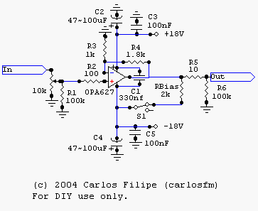

IanAS said:Carlos, do you know, does the 627 need low value resistors?
Of course it's better to use low values.
Joined 2003
Thanks for that schematic Carlos. My current preamp is Russ White's "Freebird" design, where he excludes the 330nF cap between +V and -V, and does not bias the op-amp to class-A with the 2K resistor.
Luckily I found a couple of 330nF caps in my spare parts and have installed them (that was a difficult trick). I don't have many resistors in my spare parts but I will grab the resistor from school and see what kind of difference it makes. I also plan to replace the 1n4002 diodes on my preamp supply with MUR110's as well 😉.

Yes, thanks for that schematic Carlos.
Same design as the preamp we tried the chips in recently. But that came with 4k7 in, 120k FB, 43k to earth. I didn't try a 330n across the rails. I also didn't have the load resistor 100k after the 100r o/p. Another difference was that pre had a 50k pot and 30k to earth instead of the 100k you suggest. Even with a 100k it's still not going to be all that great with a 50k pot there and is why we had offset problems. That's probably going to be swapped for a 10k eventually. Maybe a single series r L-pad if it can be made to fit.
The other time I tired the 627, the bypassing was not quite that good, but the r's were around 5k in and 10k FB and used in the inverting mode with 100pf polystyrene across the 10k. All vishay and soldered to the socket pins. Pin 3 direct to earth.
