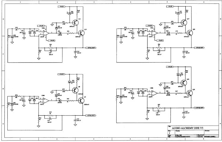

Jorge, even a well made LM317/337 will be silent enough to be used here, even with the direct biasing.
And yes, in some cases biasing to class-A does sound better, even with a resistor.
But at a higher biasing than the norm, as I said.
Anyway, look at the internal PSU for the analog stage of the AA dac I was talking about.
Independent regulation per channel, op-amp based.
This was not a cheap dac in it's time.
And notice that this dac had an unregulated external PSU, which I discarded and made a regulated one.
