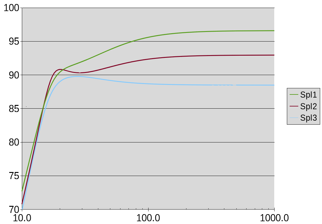

Dayton Audio UM18-22 18" Ultimax ($279.90 - price@PE link) has the advantage of having 1 or 2dBs plus in the infrasonic region or U-LF extension in relation to the Maelstrom 18 (for same alignment.)
Note: use the latest data for simulation, 2015 version T/S parameters.
It's the closest driver in production to the Exodus Audio Maelstrom-X18, (reference for the Exodus Audio Maelstrom-X18 parameters here, please name another source/link if yours is different), together with the Stereo Integrity HT 18 ($159.00 - price from the website here) again, using this alignment and ports set by the OP and original document.

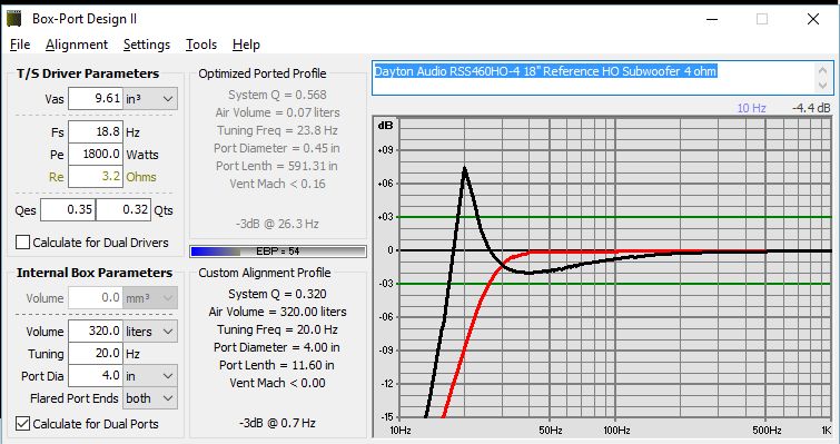

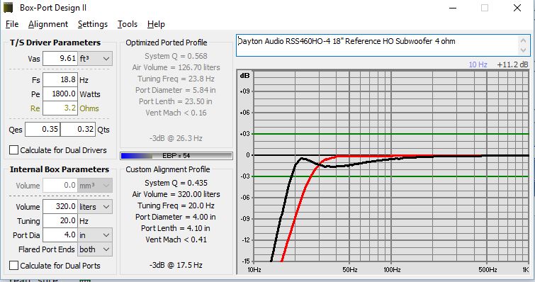

The Dayton Audio RSS460HO-4 18" Reference being another driver but presenting already some ripple for this same alignment (not benefiting from such a big enclosure), and making the three in production in the market, altogether with the Maelstrom, having similar or the closest driver parameters (for this alignment that was simulated.)
The reference sensitivity (0dB/2.83V/m) for all of them is as such:
Dayton Audio UM18-22 - 88.2 dB
Exodus Audio Maelstrom-X18 - 90.7 dB
Stereo Integrity HT 18 - 91.9 dB
Dayton Audio RSS460HO-4 - 92.6 dB
Dayton Audio UM18-22 vs. Exodus Audio Maelstrom-X18 vs. Stereo Integrity HT 18Yeah you really need to include twin 4 by 17 ports for the sim to be correct
Try the Dayton um-22 ultimax for fun too
